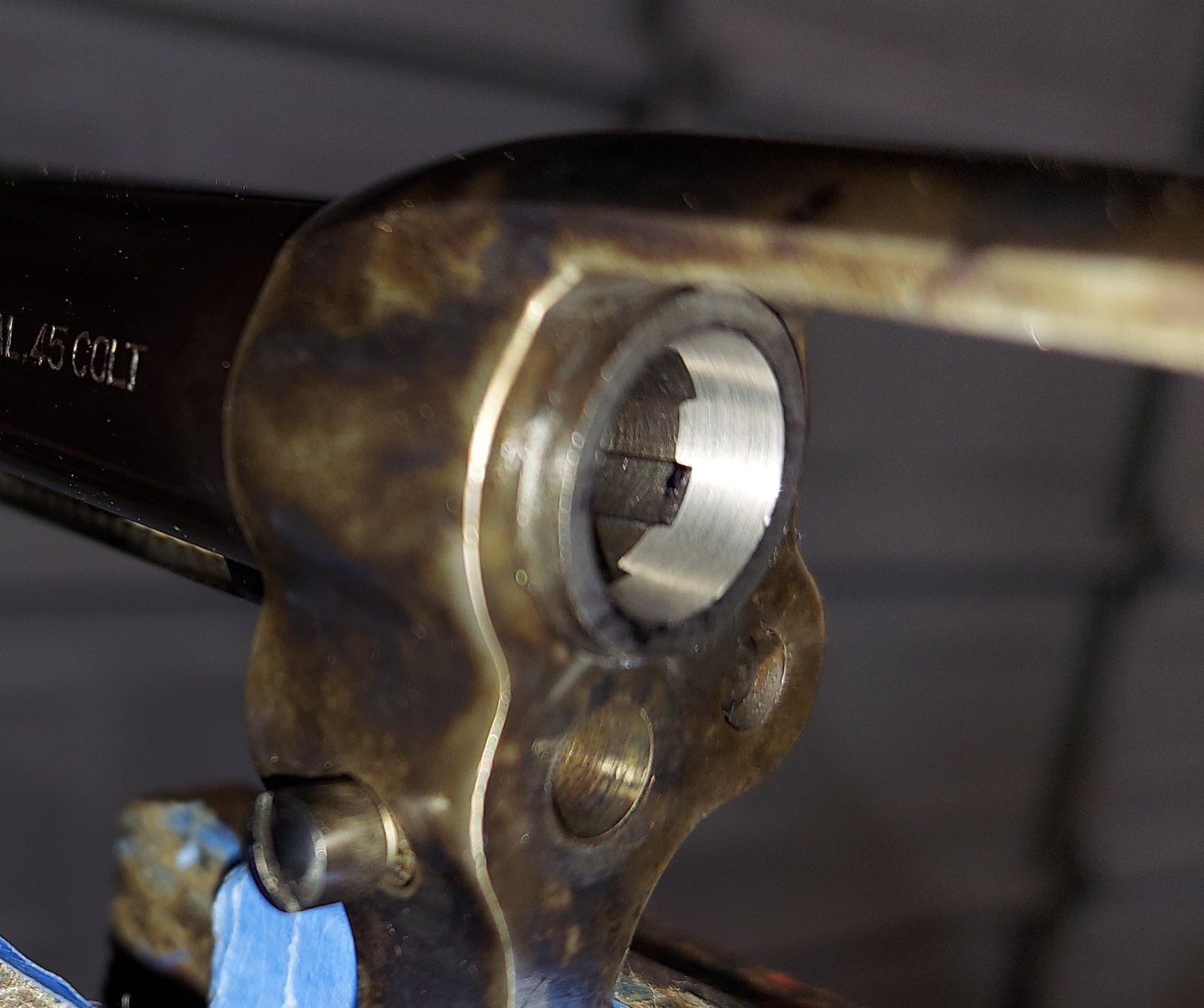

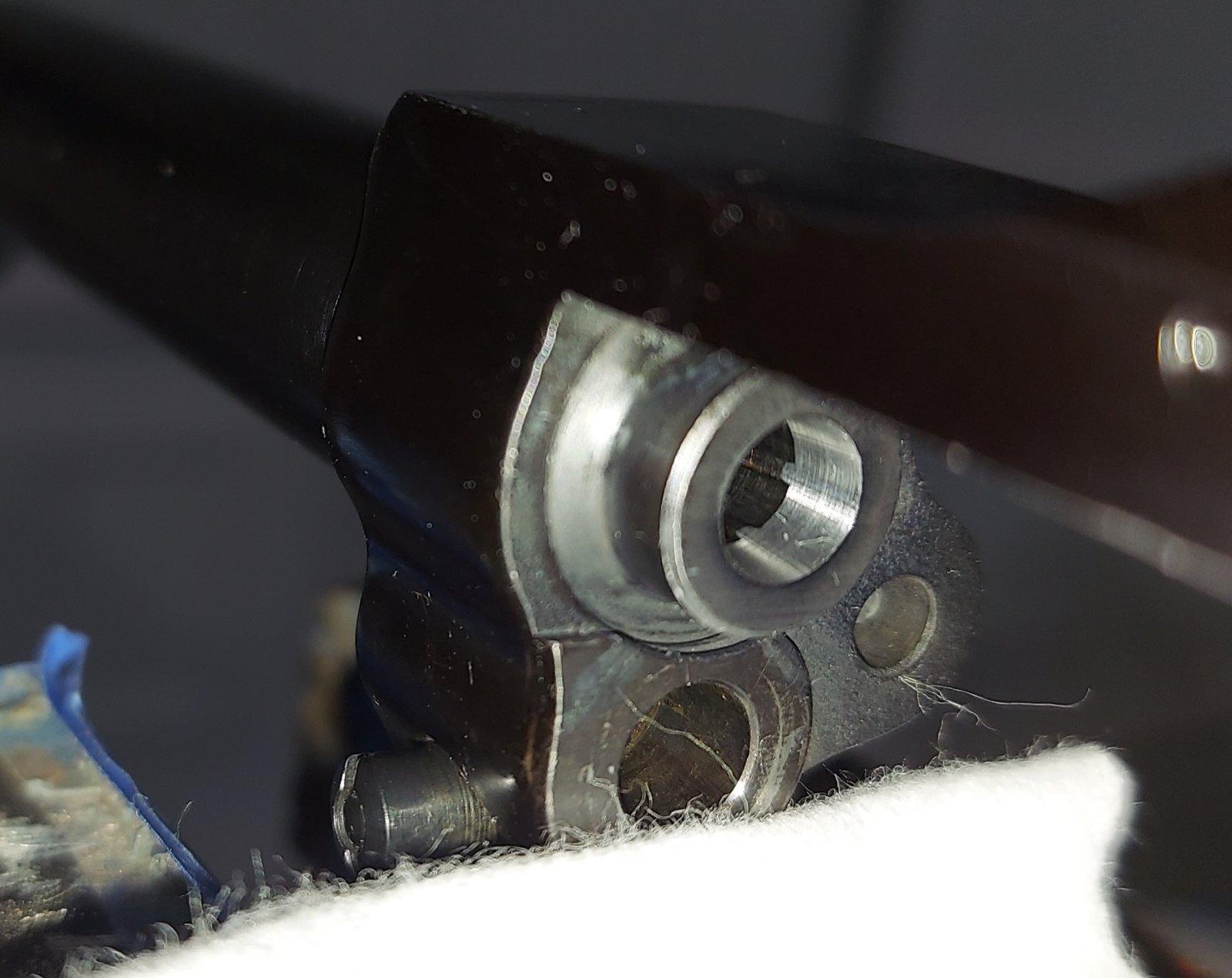

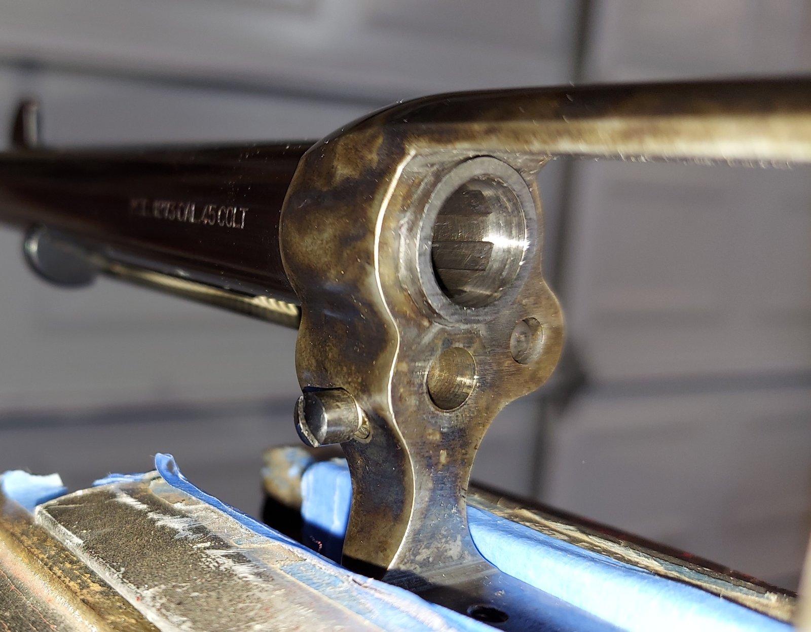

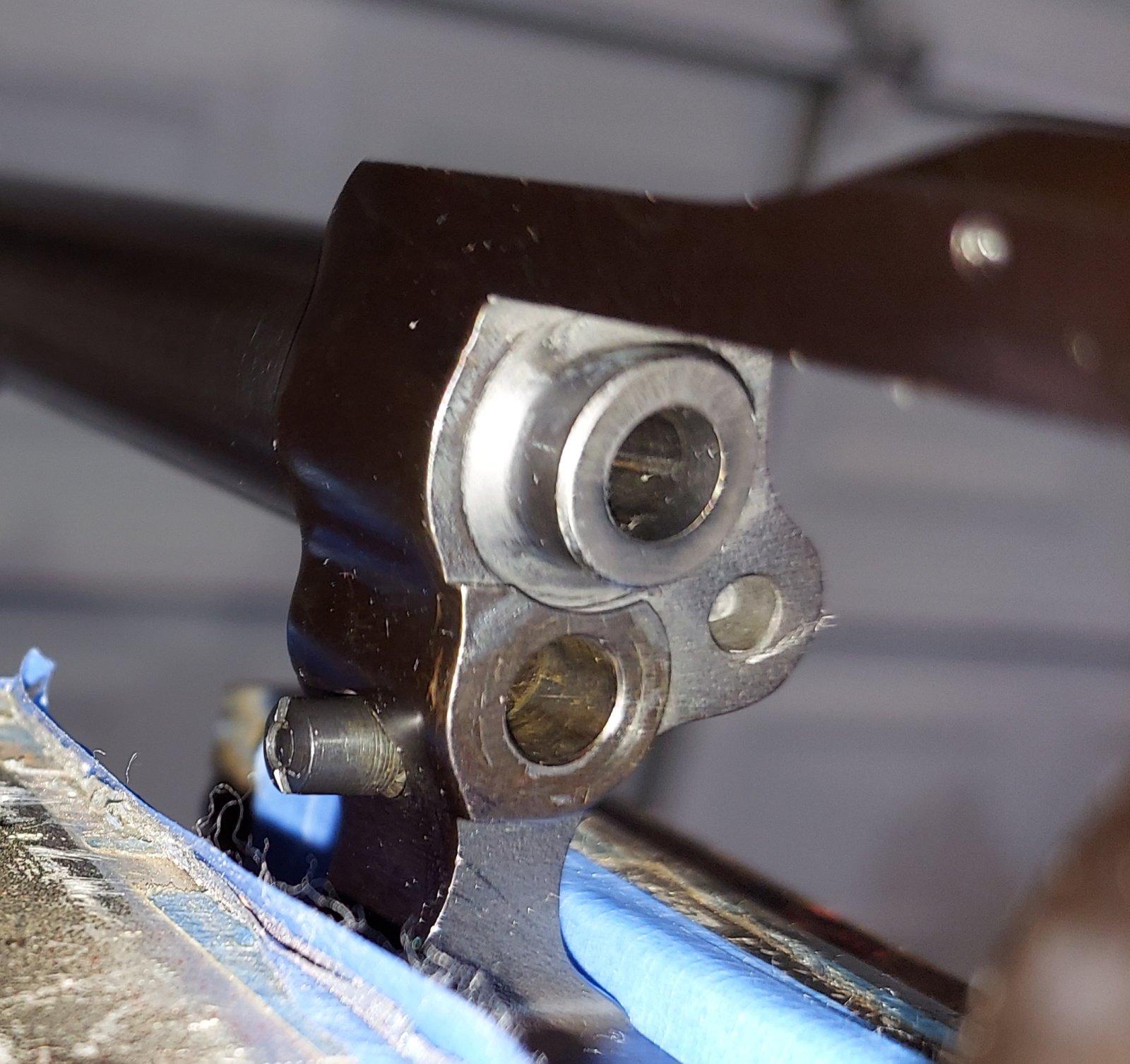

Decided to do an 11 degree forcing cone. Main reason was leading at the forcing cone. Also did my Uberti 1873 45 Colt. Both had rough cones.
Hopefully I can do a range report soon.
