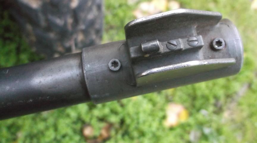

Back before I moved to AK, I put together a shotgun that could function as both self defense, and hunting... Basically an old beat-up 870 that I picked up cheap.
I put a 21" rifled barrel on it, and as it happened, we had a set of ghost ring sights at the shop I worked at, (part time).
After I got to Alaska I went out to sight it in... by the 3rd slug, I noticed that the front sight was NO LONGER on the barrel... it had launched itself down range.. I remounted it.. made sure it was tight... and... same thing....
I took the shotgun to a gunsmith who drilled and tapped a second hole... the rear screw, in the pic... That seemed to solve that issue.

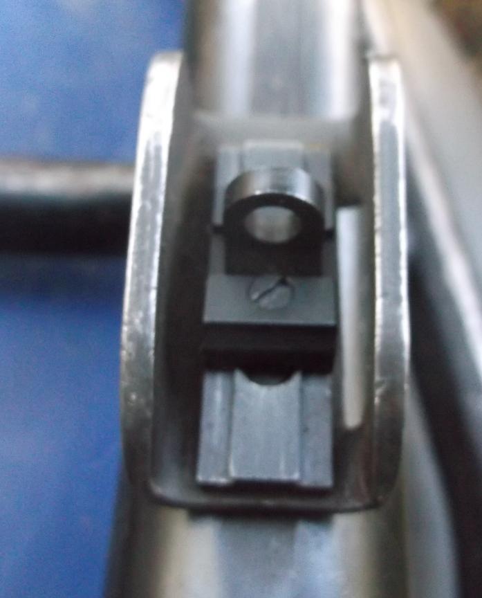

Later... as I was carrying the shotgun from the truck to the cabin, I noticed the rear aperture was missing off the rear sight.... ugggh....

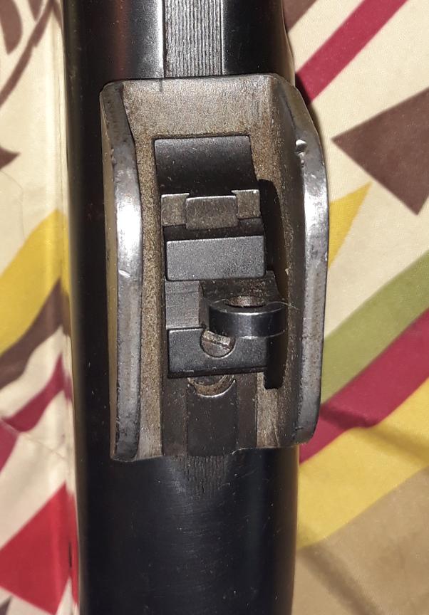

In talking with the owner of the shop, back in Minn, he said he had another set, and sold them to me dirt cheap.... I mounted them up.... as I tried to tighten the screw that holds the aperture in place... the head snapped on the screw.... (hard to see in the 1st pic.. just behind the aperture)
So..... I now have to remove broken screw, and find a replacement... I'm thinking of tapping a larger hole, and more robust screw, but I have taps.. I'll have to try and budget for a set I guess.

I am going to fix it.... my way.... I'm going to add another set screw, just like I did with the front sight.... I have to look at it closely to see if it will work... but since it doesn't work now, I'll be no worse off...
I'll need a tap & die set... anyone know of a decent "poor guy's", brand out there?? I have access to a nice drill press and vice.....
If it is aluminum just about any tap brand should work ok. Just remember to turn it in and back it out to clean the chips out so it doesn't gall the threads.
