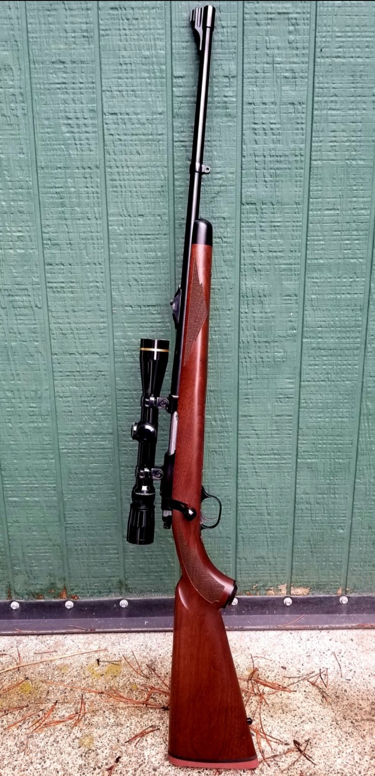

I was lucky enough to get the new lipsey 22 hornet African. I haven't shot it yet. Only complaint is My front sight looks off center. Probably should send it back to have it fixed one of these days.
