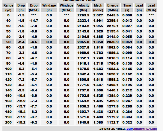

That helps. Plugging that in to JBM, it looks like you'll have about a 3" drop from 50 to 100yds. Subtracting the 1.5" high you have @ 50, that leaves about 1.5" you'll have to compensate for to avoid shooting low. That in turn results in about 6 clicks ( .25" per click) to bring the group up 1.5" . That should get you pretty close, assuming there's no atmospheric conditions you'll have to compensate for (wind, temp, humidity, etc., etc.).
Here's the readout:
