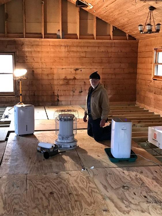

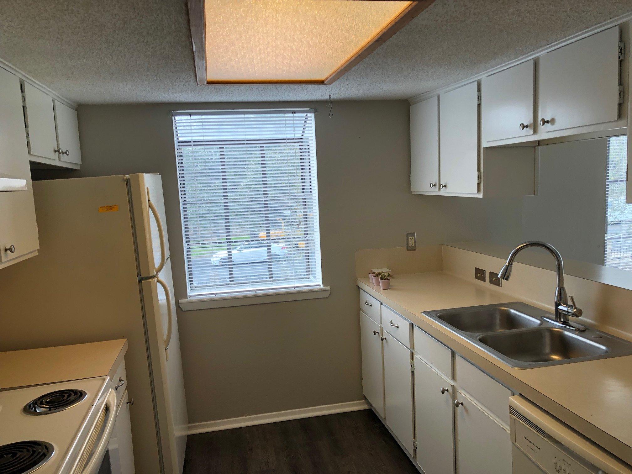

My kitchen isn't that big at 9.5' x 18'. I need a new stove as the main electric burner is erratic and it can't be replaced because it's fused in there. That means I won't be able clean the tray every 20 years like I have been LOL I picked out a new stove yesterday. I want an over the stove microwave to free up some counter space. I've never used the dishwasher, ever. You had to wash the dishes before you put them in it so what's the use. Plus it's only me, now. It doesn't even work, but I'll need to get one. I store my dishes in the pull out trays. Really! LOL
I now have a feeling this is going to cost a lot more $$$ than I thought it was...

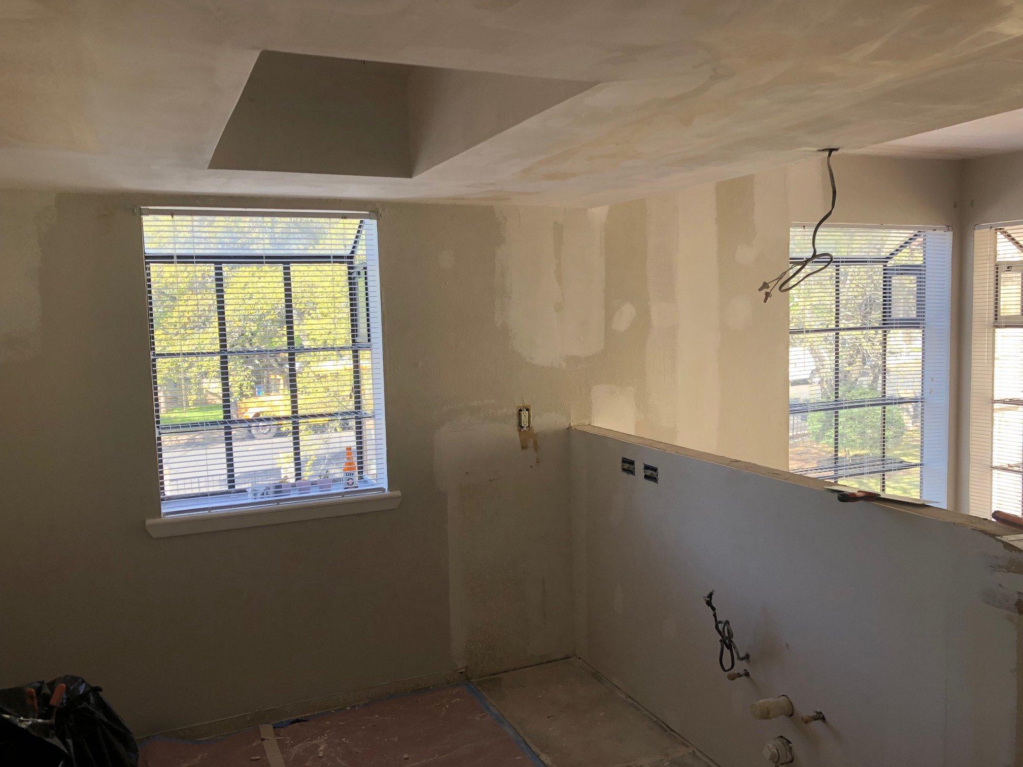

My granddaughter just bought a small, 40 year old condo in Austin. Her uncle (one of my sons) is doing a gut renovation of the place and ripped out the 1980s kitchen (see pic) and will install new cabinets, appliances, & fixtures... plus tiling & painting.
He’ll re-do the bathroom too.
A contractor will install new carpet & flooring.
↑ If mine looked that good I wouldn't even be thinking about a renovation. LOL
My counter tops are so dated. I guess it was popular in '81 for them to look like cutting boards.
