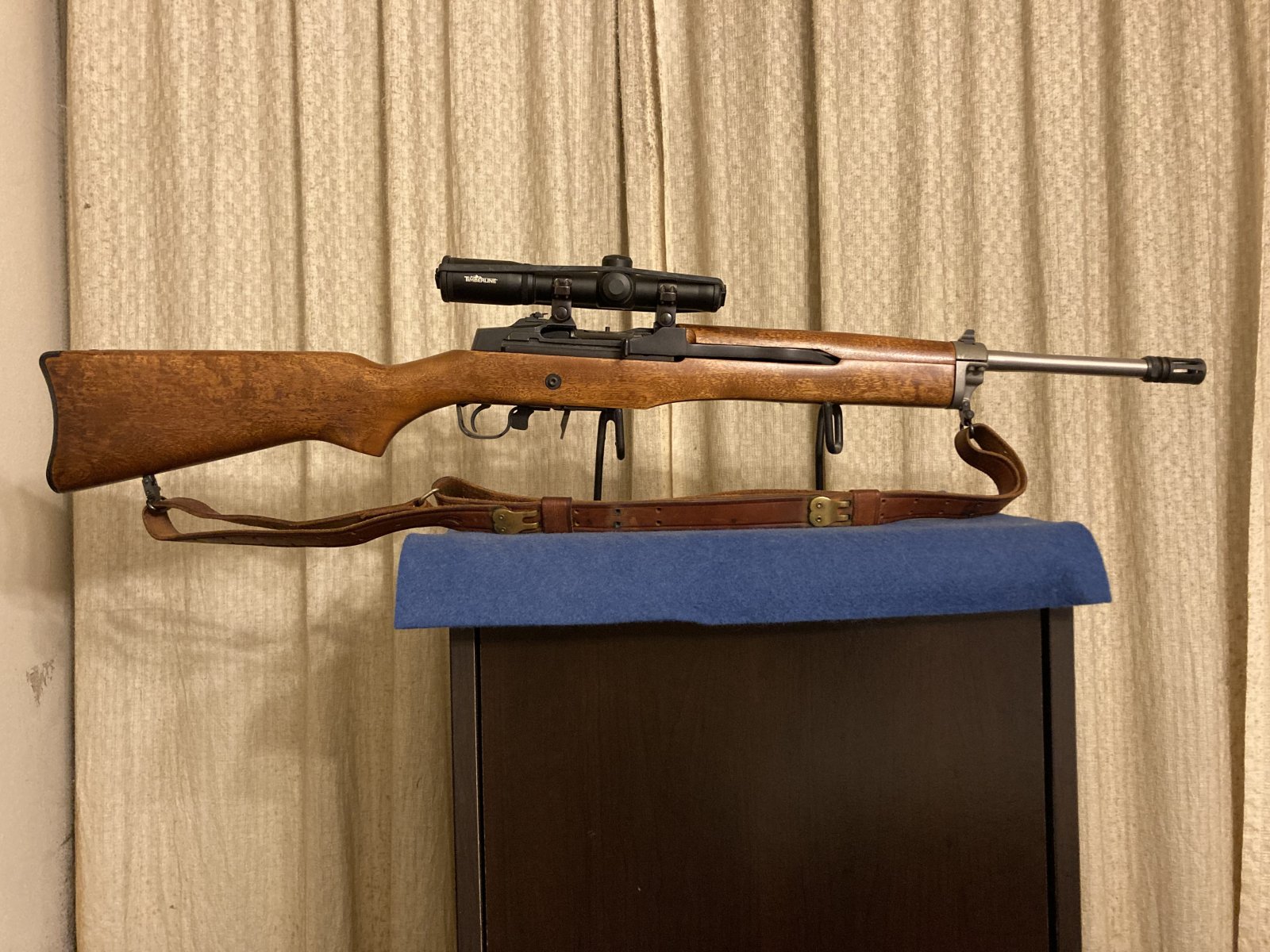

A suggestion - have the barrel threaded. The slip on stuff looks horrible. FWIW, the old pencil barrel is easy to thread. I have 4 Minis, all lopped off to 16" and threaded, added an upper gas block with front sight from The Arms Room.
Updated - not the best photos but shows the CA legal brake and gas block with front sight.
The gun went to Accuracy Systems a few years back, they did the threading on a heavier barrel. But an older pencil barrel is the correct diameter for hand threading. Cutter, TAT and handle with cutting oil - pretty simple.
