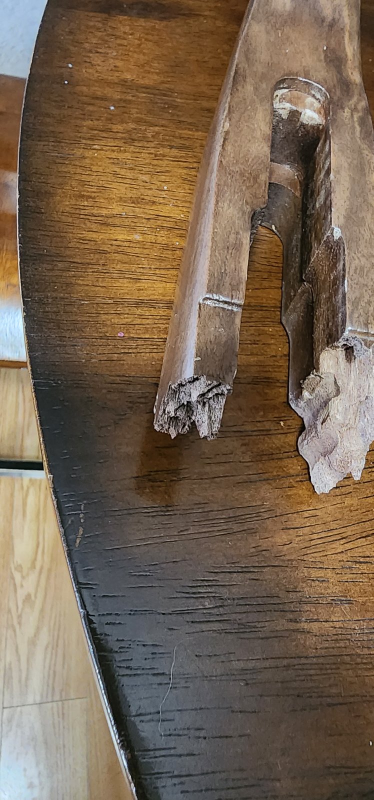

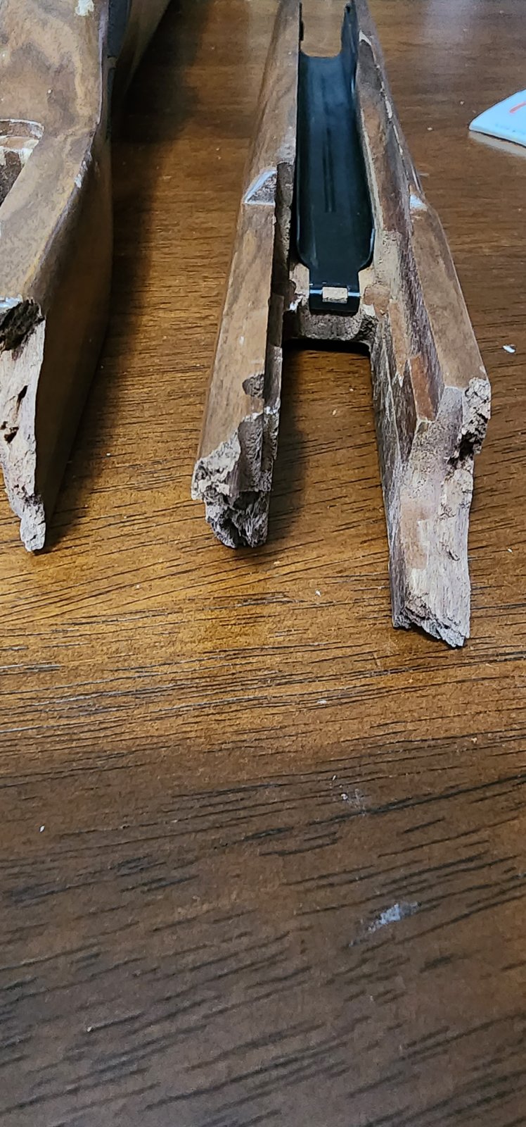

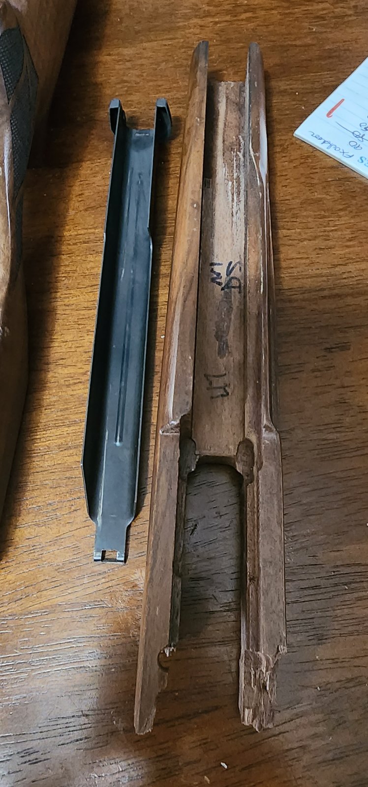

you can try and put up a picture of just what the stock (Liner-inside) looks like, does the hand guard snap onto the barrel like the older ones????
I was meaning photos of the INSIDE of the stock, showing the liner set up etc as noted in his other postings the stock in question (a Boyds??) does NOT show the metal liner locking screws in about the area that shows ,has the cracks??? I am curious as to the inletting of this new of a Mini model stock setup.......have not seen, touched, or used, any Mini after the #185 series ........closed the shop in 1986, and the home shop in 1996, retired in 2002...........21 years ago,,,so the stocks I got here are "dated":cool::rolleyes:
