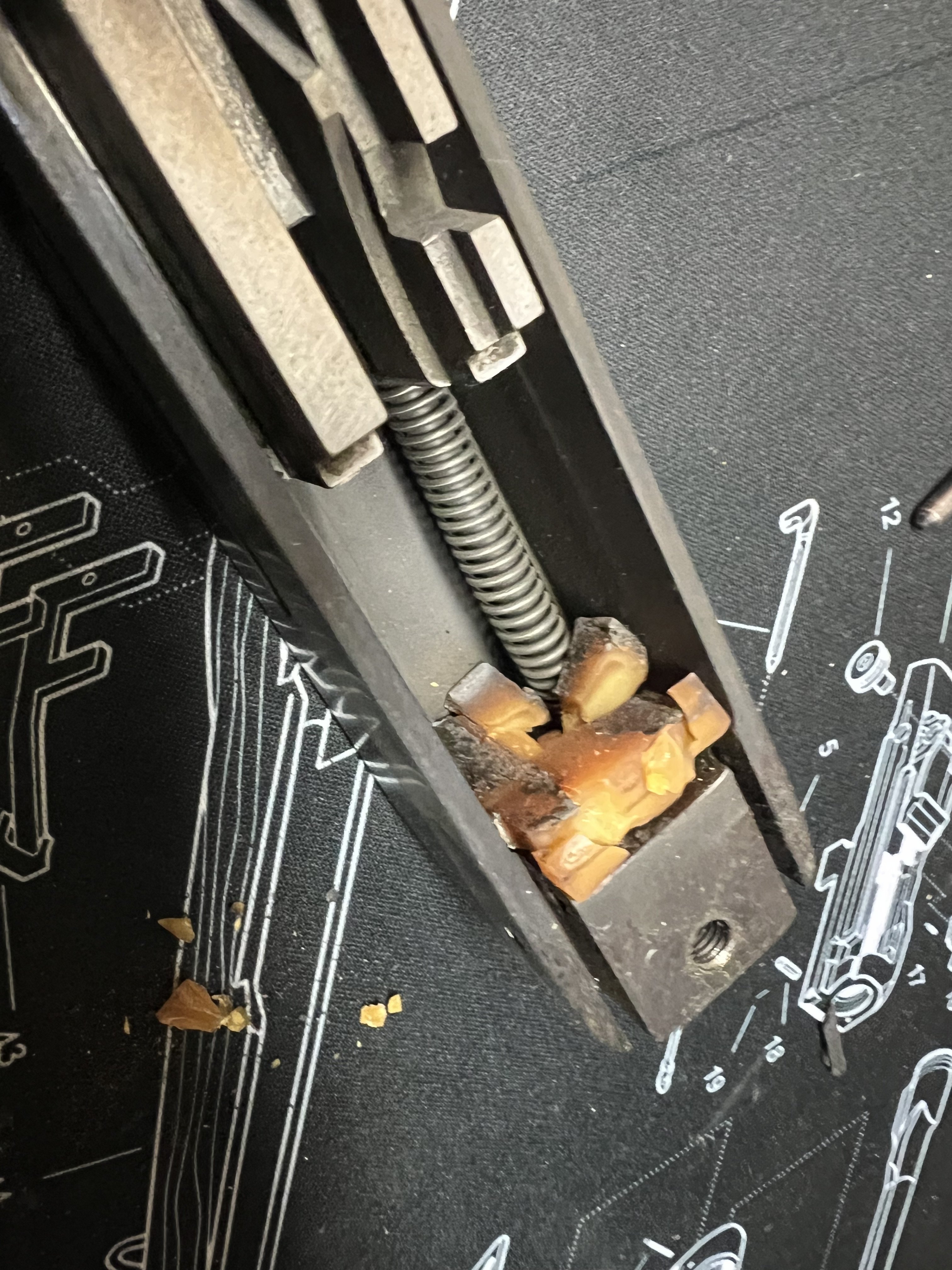

My new buffer and spring arrived today. What I found when I pulled my carbine apart. So glad I didn’t shoot it.
The original spring was insanely weak compared to the new one.
