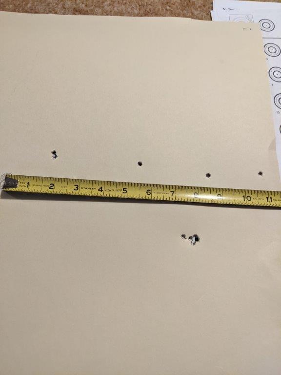

I have a 1022 Carbine that never really shot very good groups even using higher tier ammo. My gun dealer buddy had a new LVT barrel that he had personally tested to be a good shooter and offered it to me at a good price. I ordered a take off stock from S&P Outfitters and carried it to my buddy. He installed the barrel, slipped in the stock, mounted my scope and we test fired it. The initial poi was 11" to the right @ 25 yrds. and the windage was maxed out to the left and still 2" short of the target's center. We tried 4 more scopes but got the same results.

My son said try his 1022 receiver and after adjusting my scope's windage back to the right the groups were dialed in @ 25 yrds.

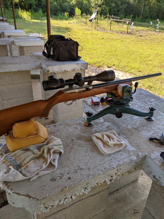

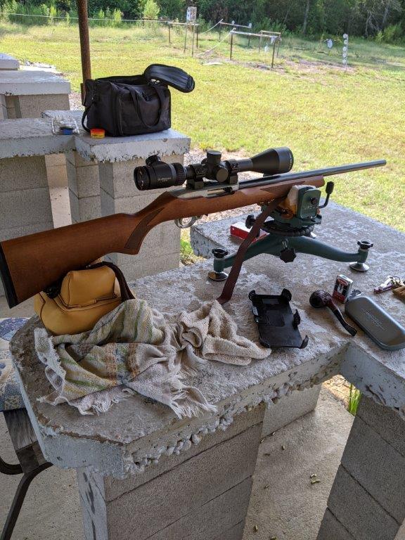

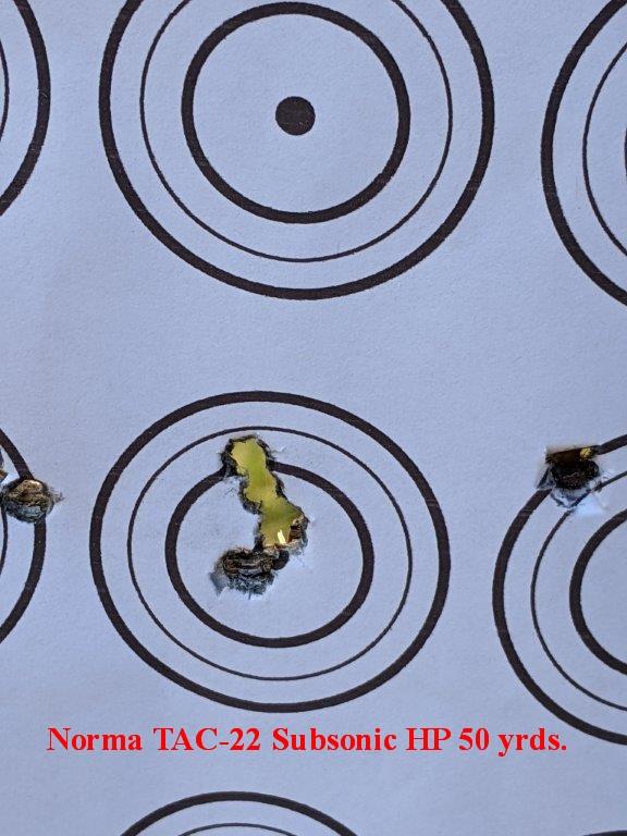

LVT project update. I removed the dovetail rail from my son's receiver and attached a new oem Ruger Weaver combo rail obtained from S&P Outfitters for $0.99, mounted the Athlon scope and went to the range yesterday to sight in and test ammo. Initial sight in was @ 25 yrds. and only 3 shots of scope adjust to get in the bullseye. I then moved out to 50 yrds. and shot for groups with Norma TAC-22 & TAC-22 Subsonic HP. The regular TAC-22 grouped fine and I hoped the Subsonic did as well or better as it's the squirrel hunting round used from my CZ 457 American Synthetic and it didn't disappoint. Rather than showing all the groups with scope adjustments I just attached the 5 shot 50 yrd. group of the TAC-22 Subsonic that made me comfortable in knowing it was viable for hunting.

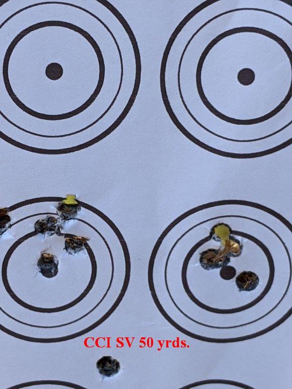

I was curious how it would shoot CCI SV so rather than running a patch down the barrel before changing ammo brands I fired a 5 shot group to acclimate the barrel then fired for a group, it didn't disappoint either.

I will continue to test but at this point I consider this project complete and a success, the LVT is a welcome addition to my meager squirrel hunting rifle arsenal.
