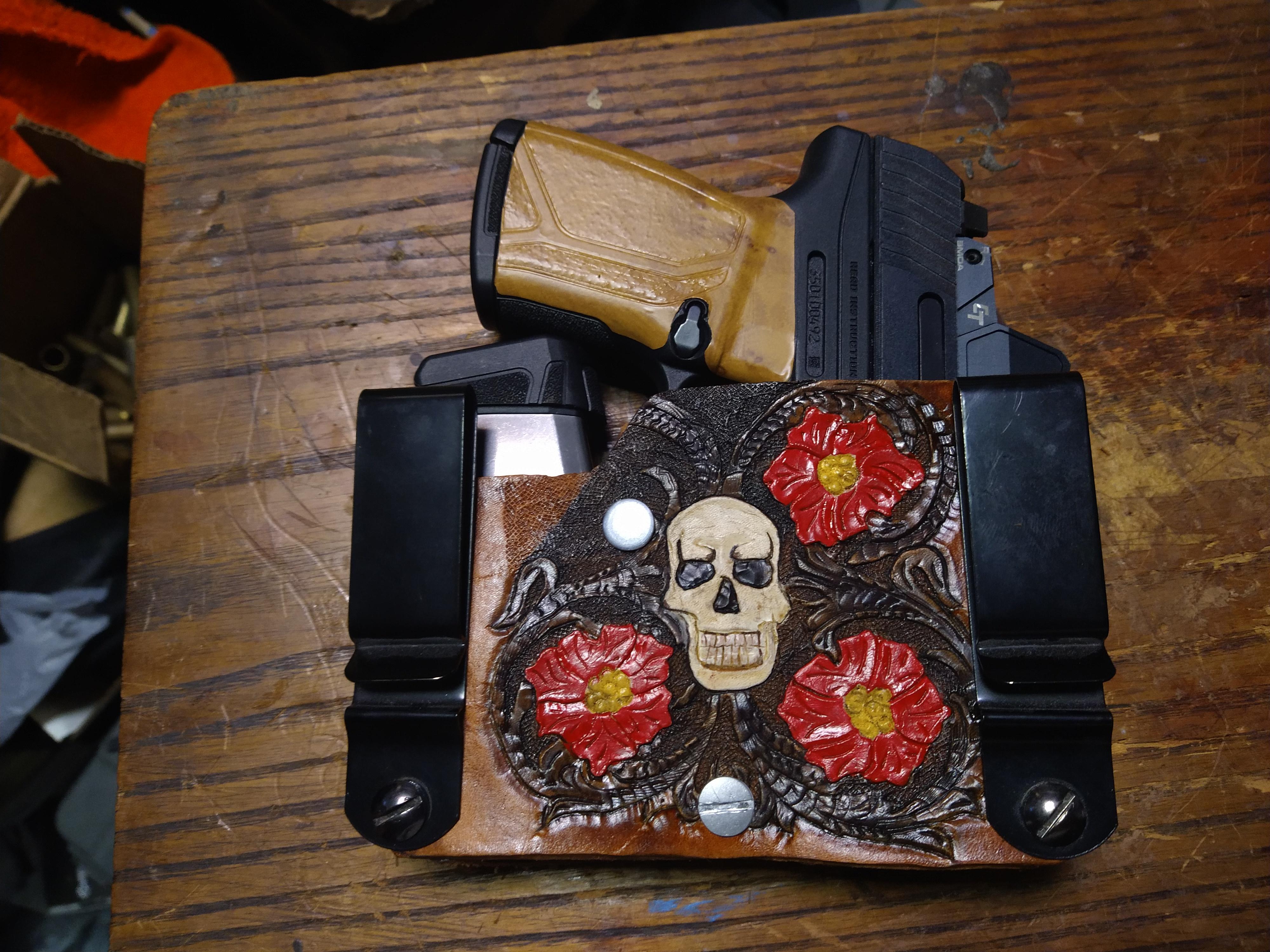

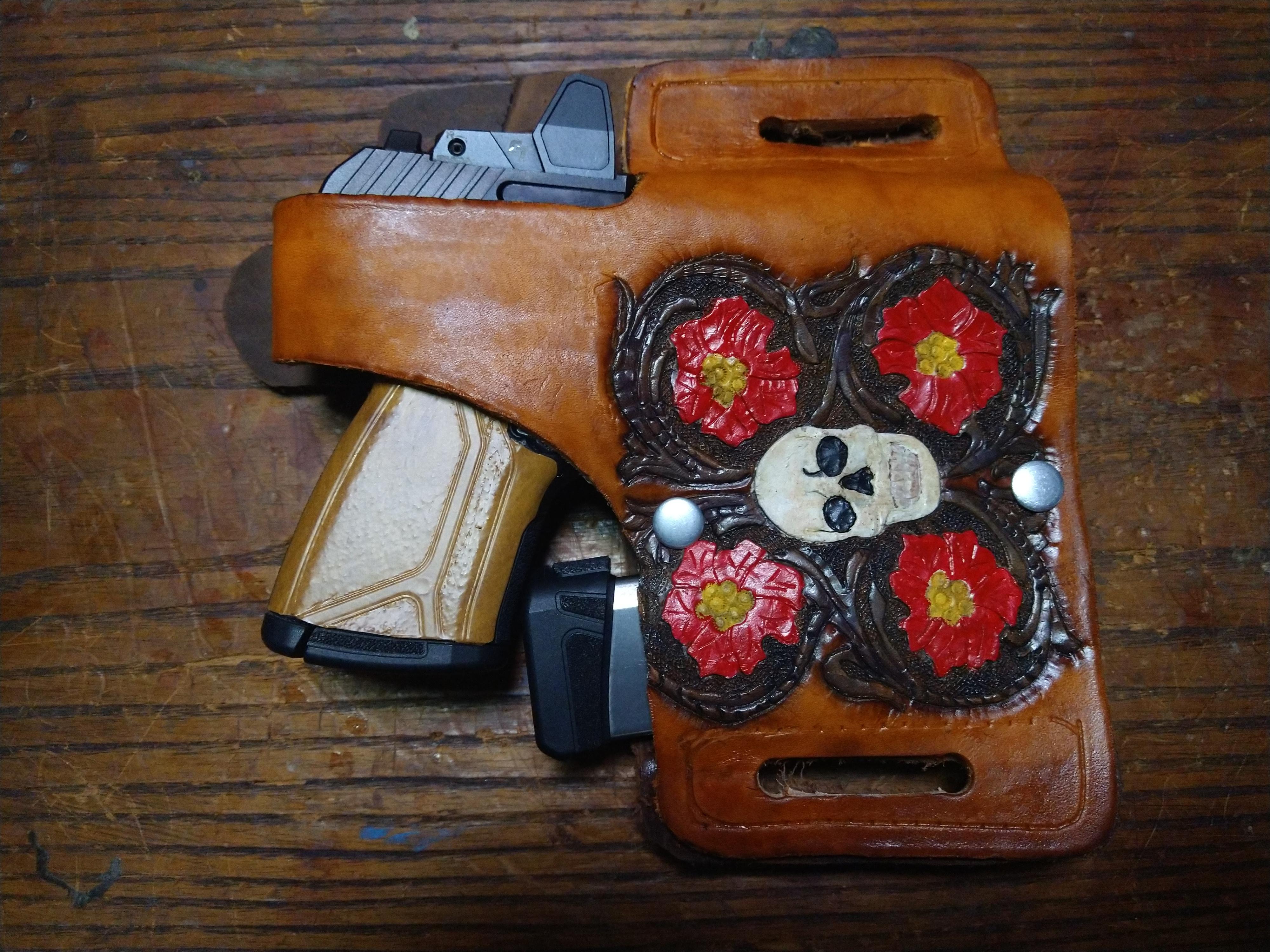

Custom pocket/IWB holsters for LCP and Max9.
Nov 30, 2022
5,999
Maryland

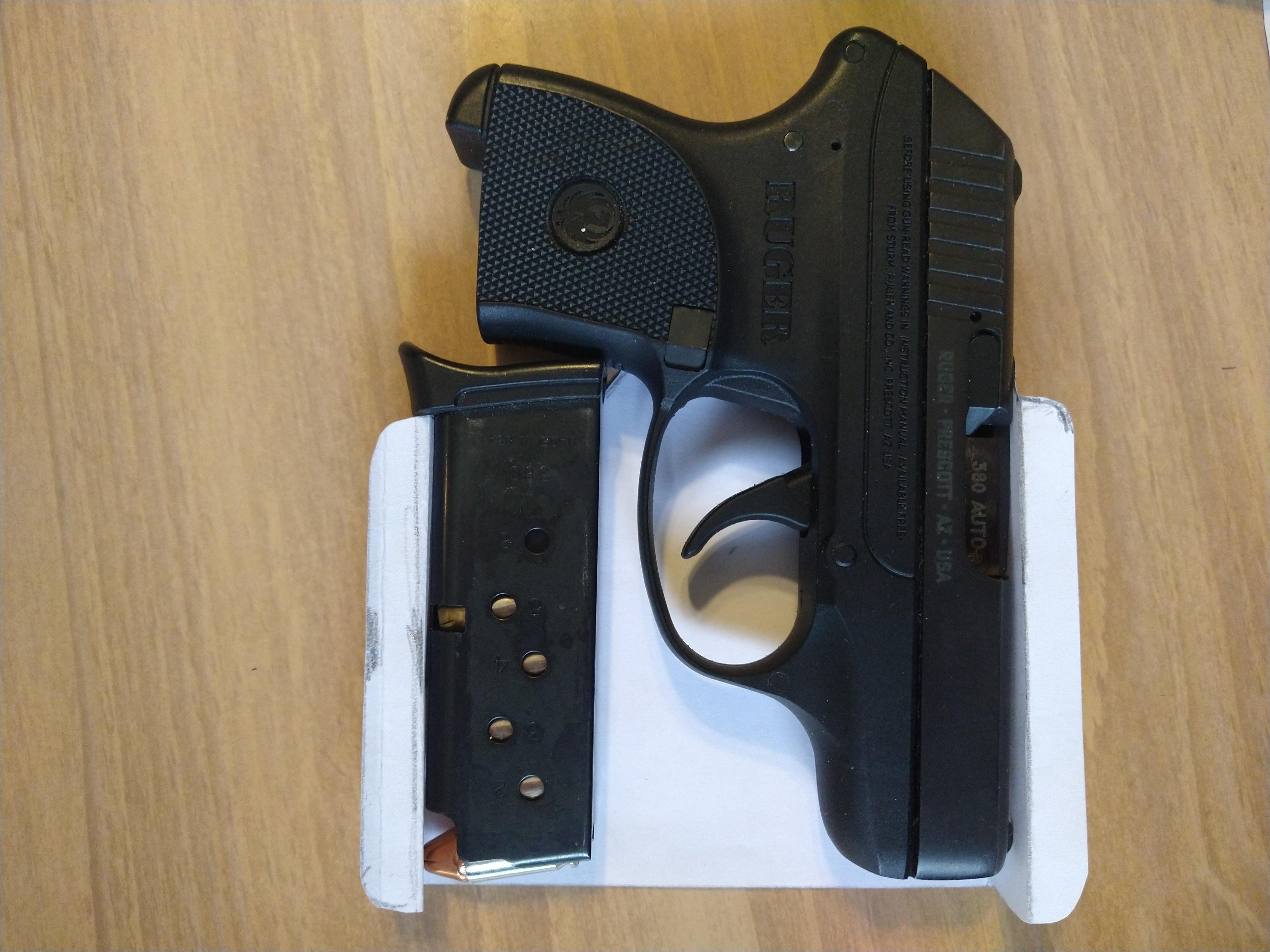

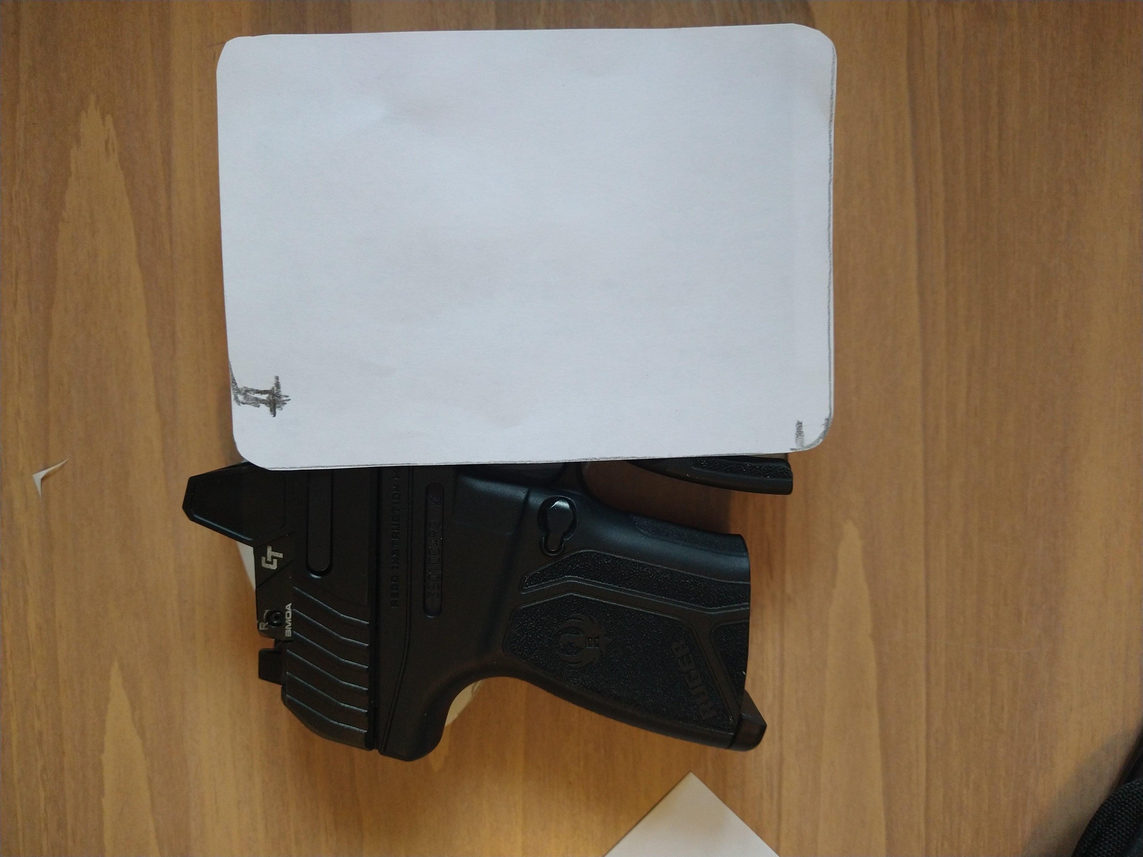

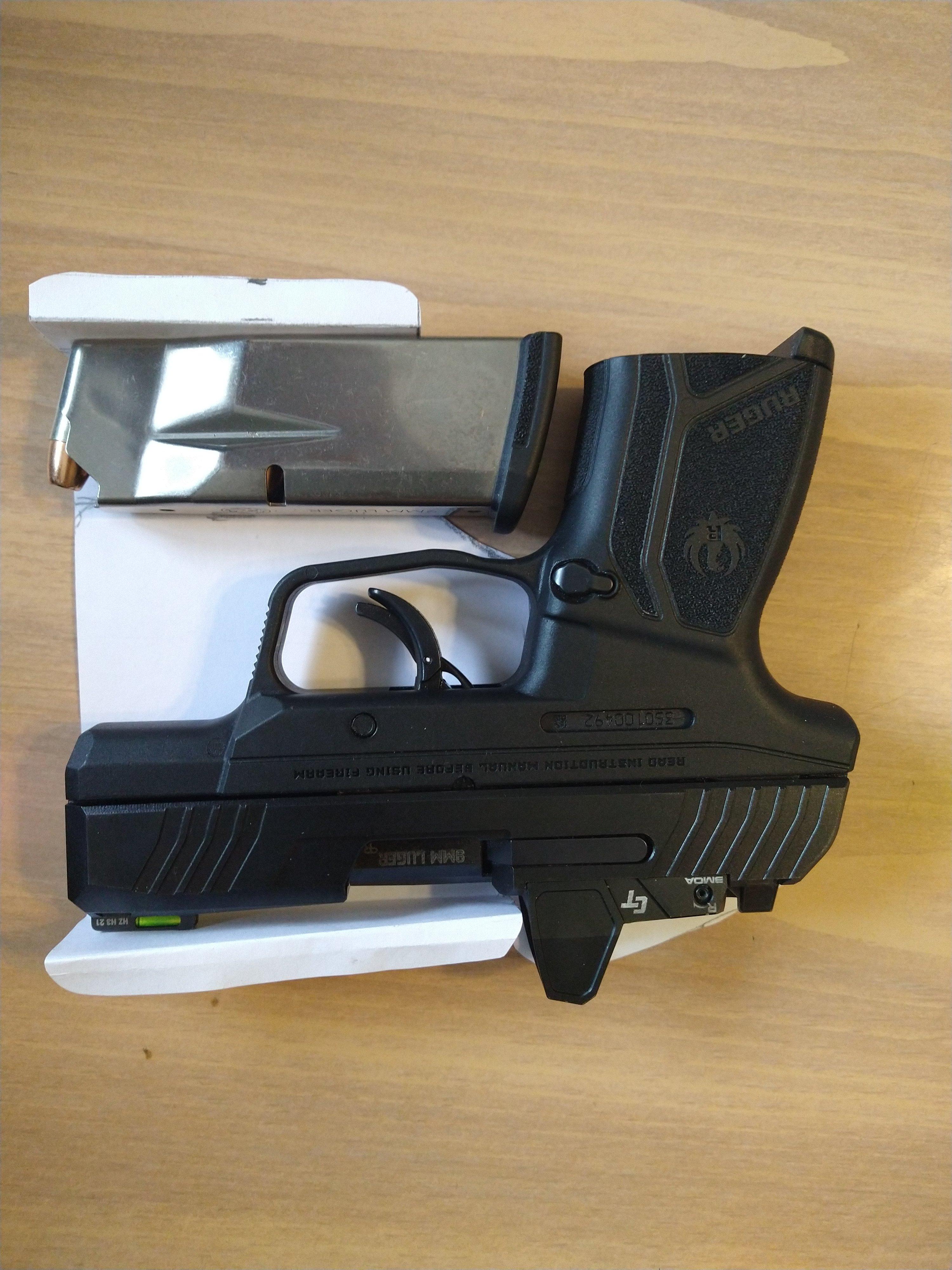

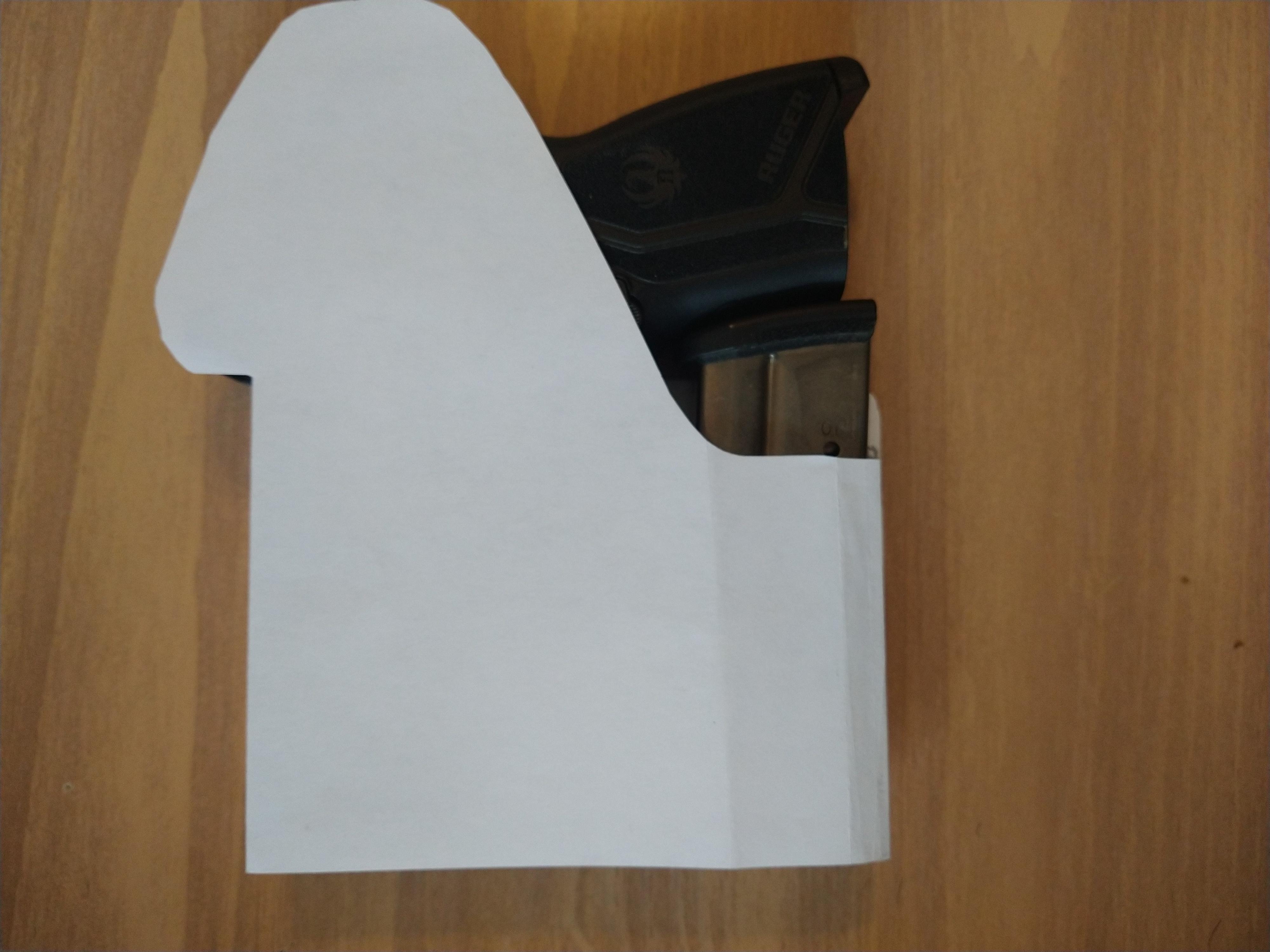

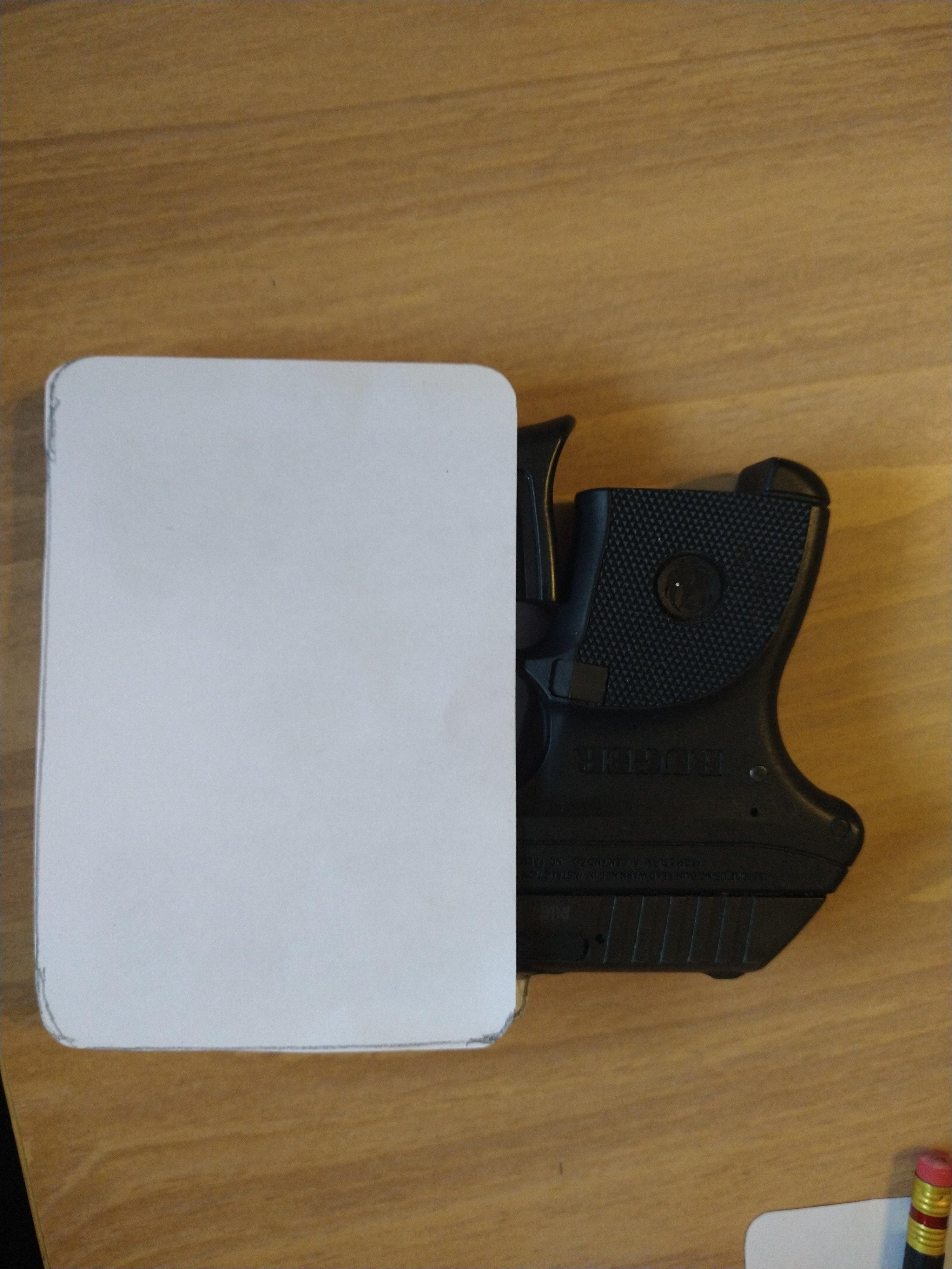

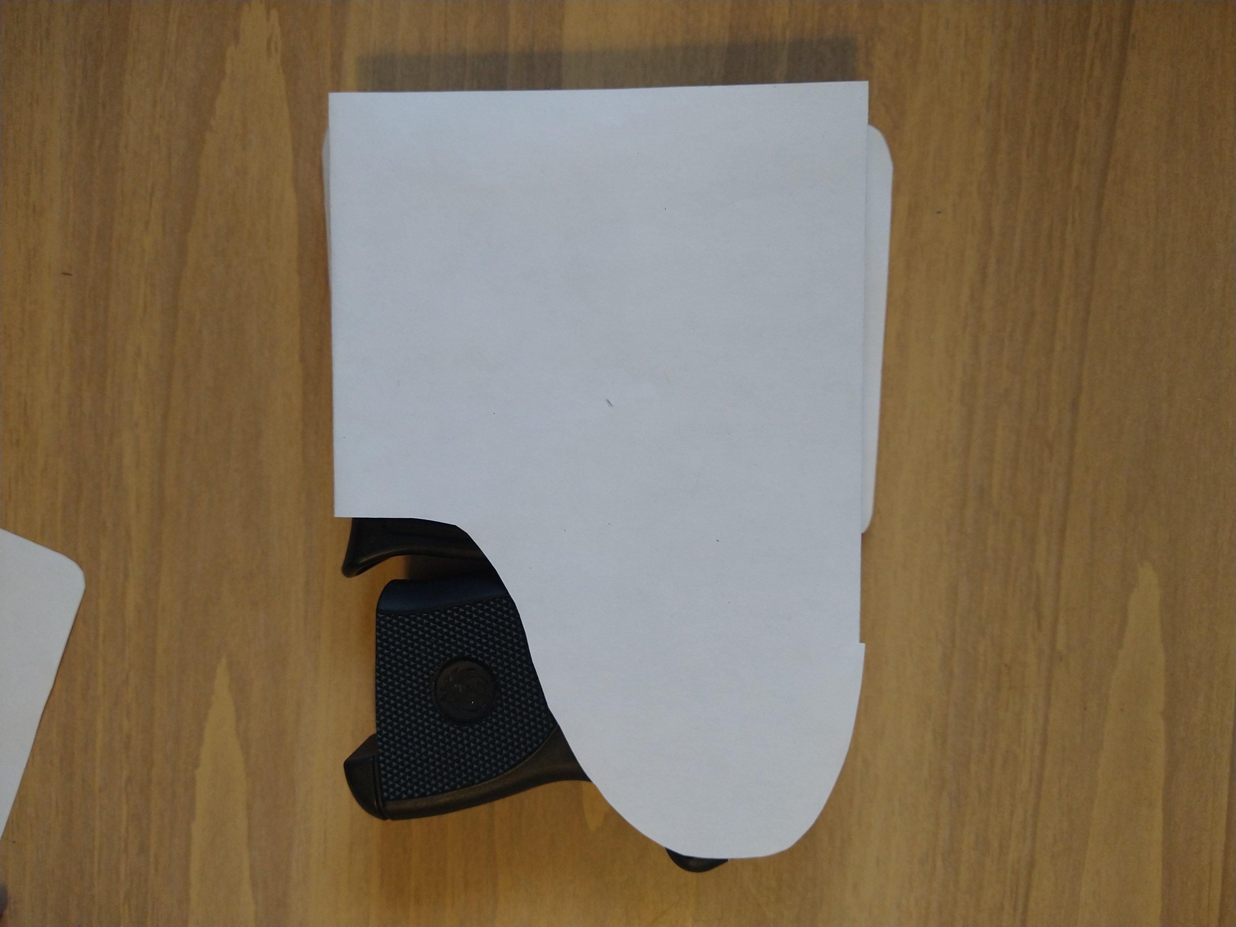

Most pocket holsters don't seem to break up the outline of the pistol. So I figured that a spare mag would square up the whole thing and have a place for the mag. By adding a belt clip it'll work for IWB as well. A few post screws can take care of locating, retention and be adjusted

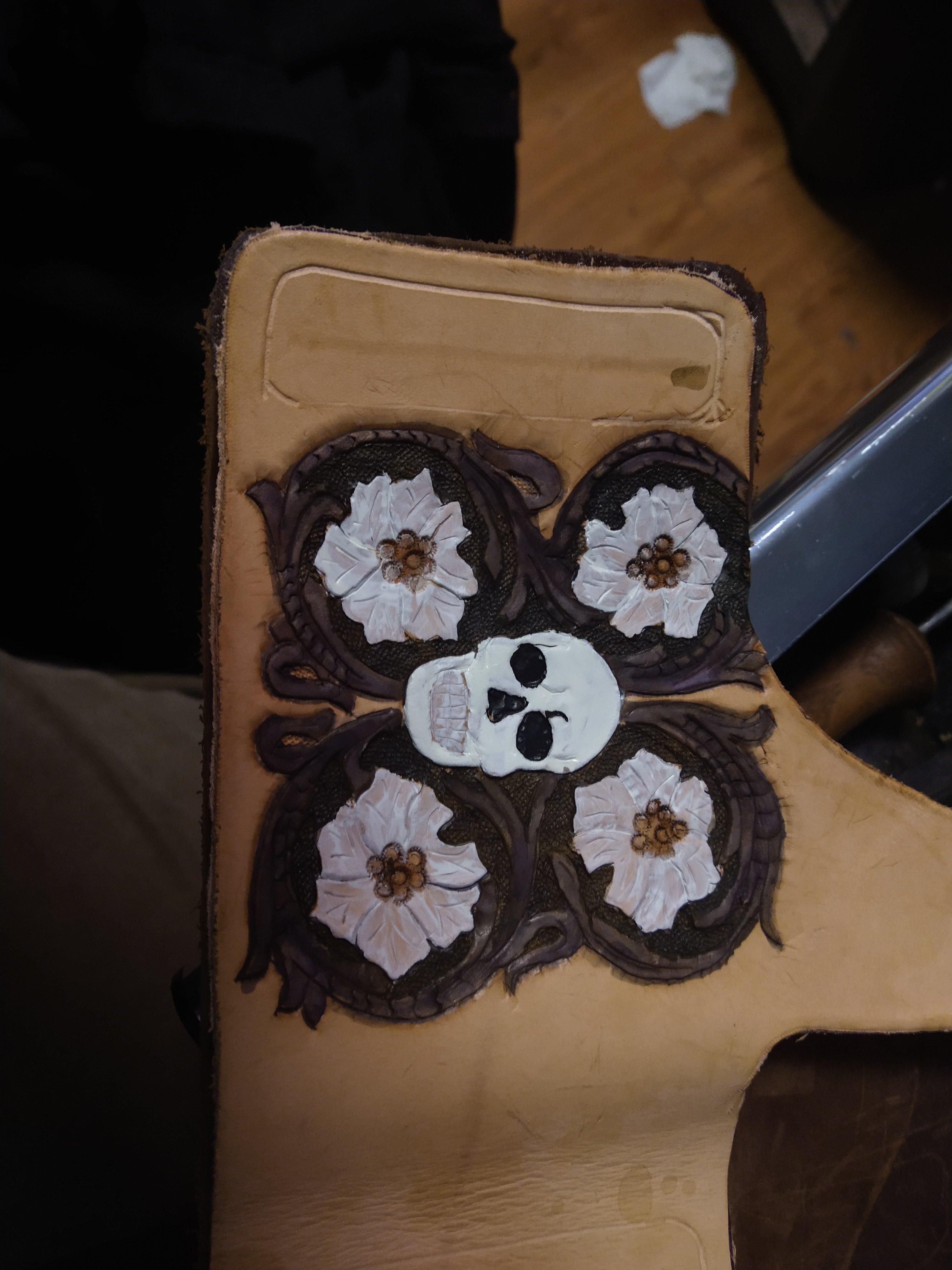

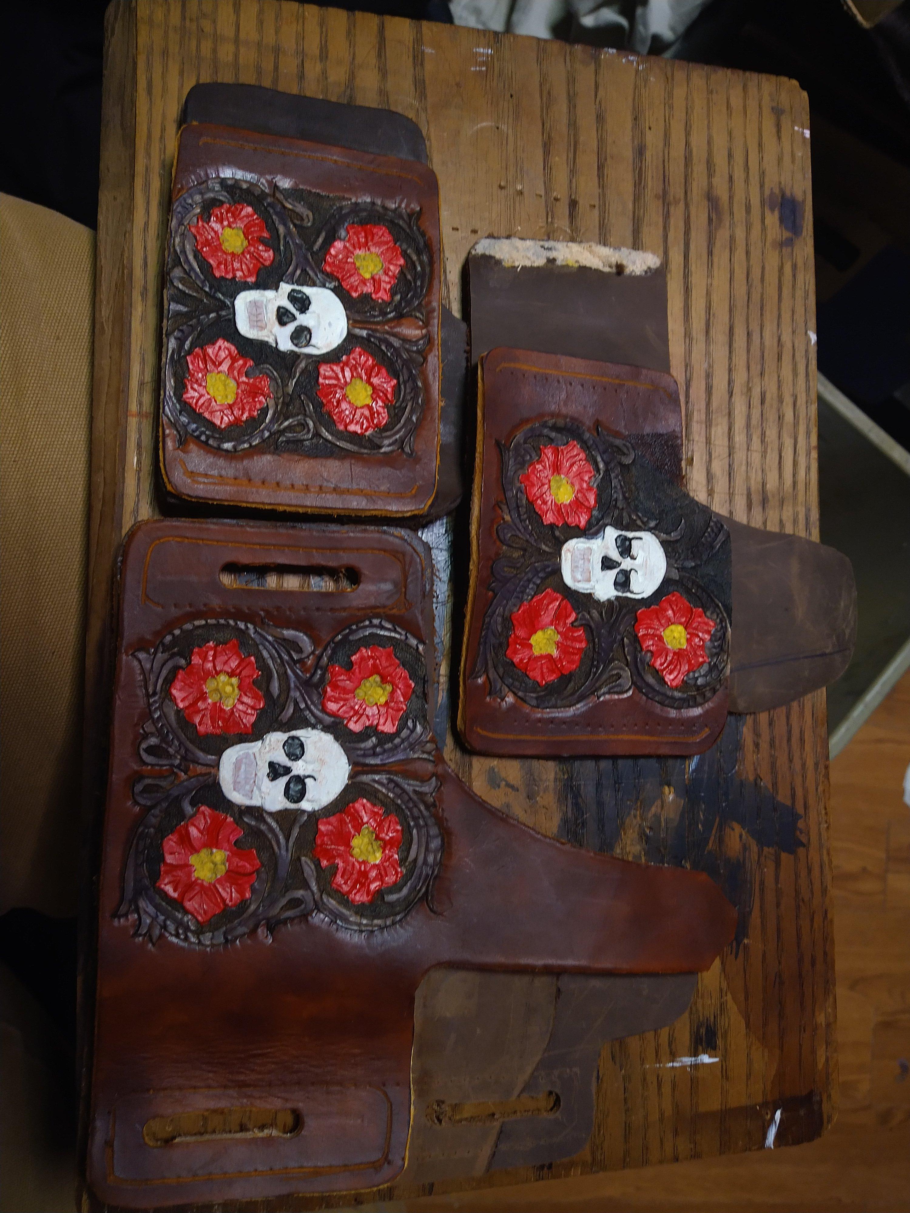

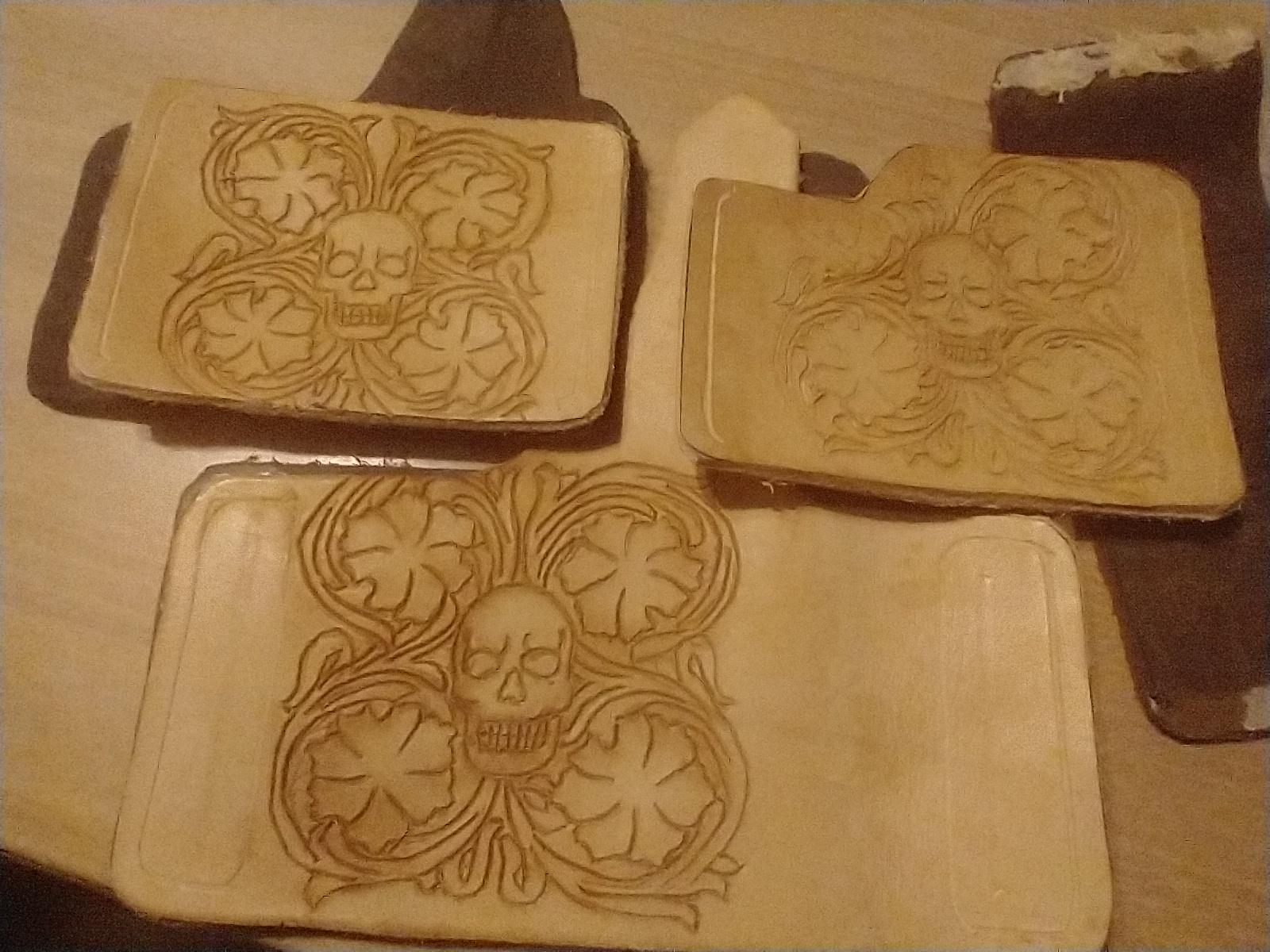

Hvymax, did you do the tooling on the leather it looks good
Yes. That's just the swivel knife work. Next comes bevelling, shading, decorative cuts and veining. Then I can stain and wax stiffen before sewing everything up and finishing. If I'm going to make something I like something nobody else has.

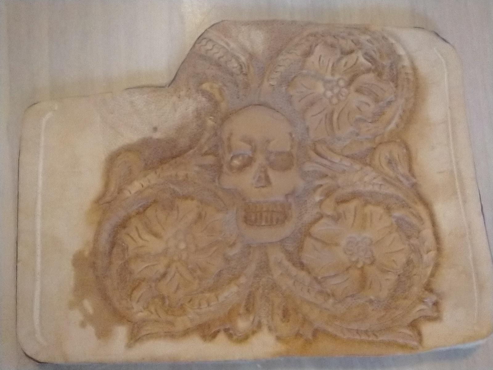

I'm not 1/10 as good as I used to be. My saddle tan dried out and I need the finish as well so will need to wait till next week.

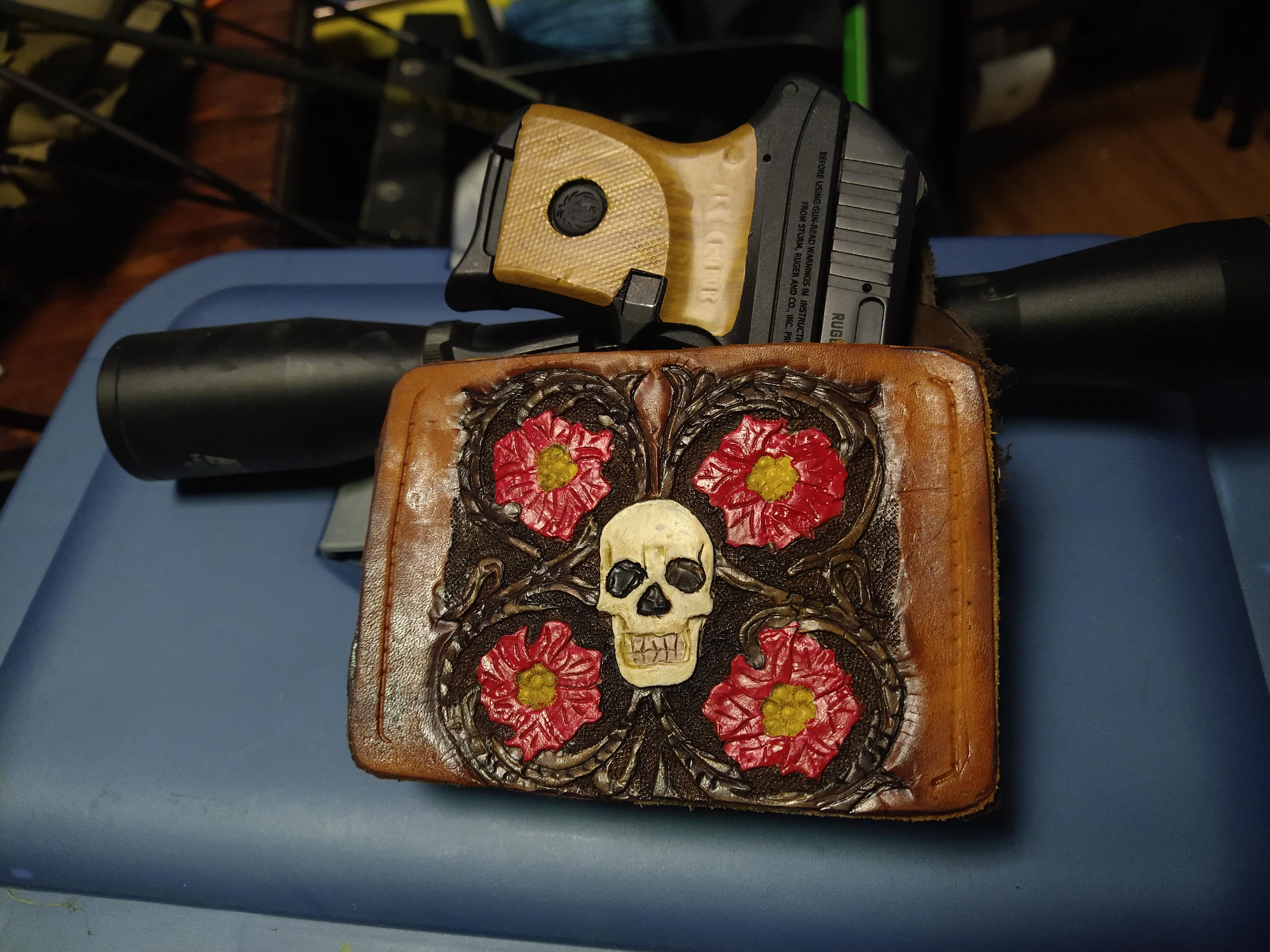

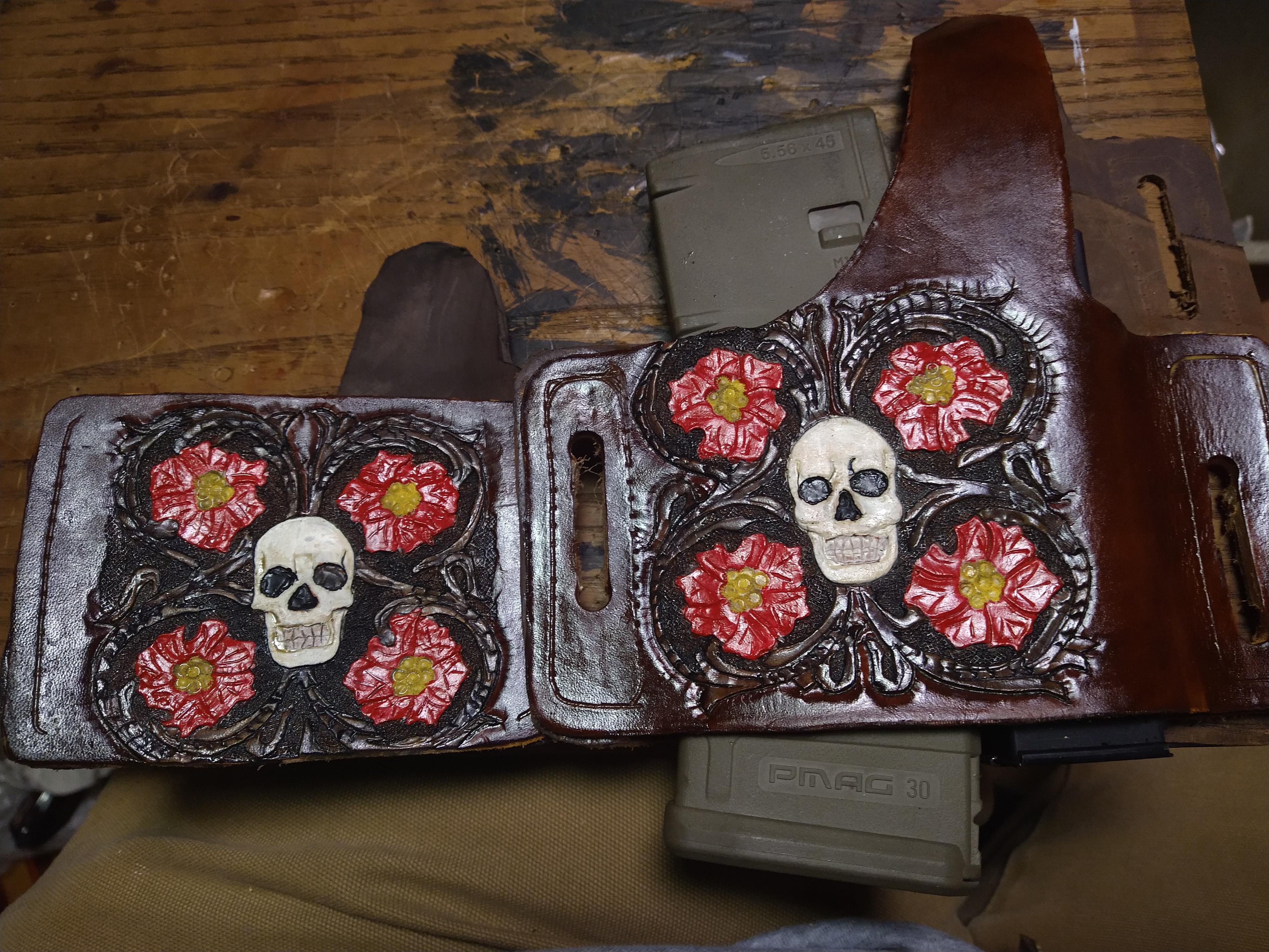

Ready for a wax finish tomorrow. Not as bad as I thought they'd be. Tomorrow I'll stitch, sand and finish the edges and rub in some Carnauba wax.
