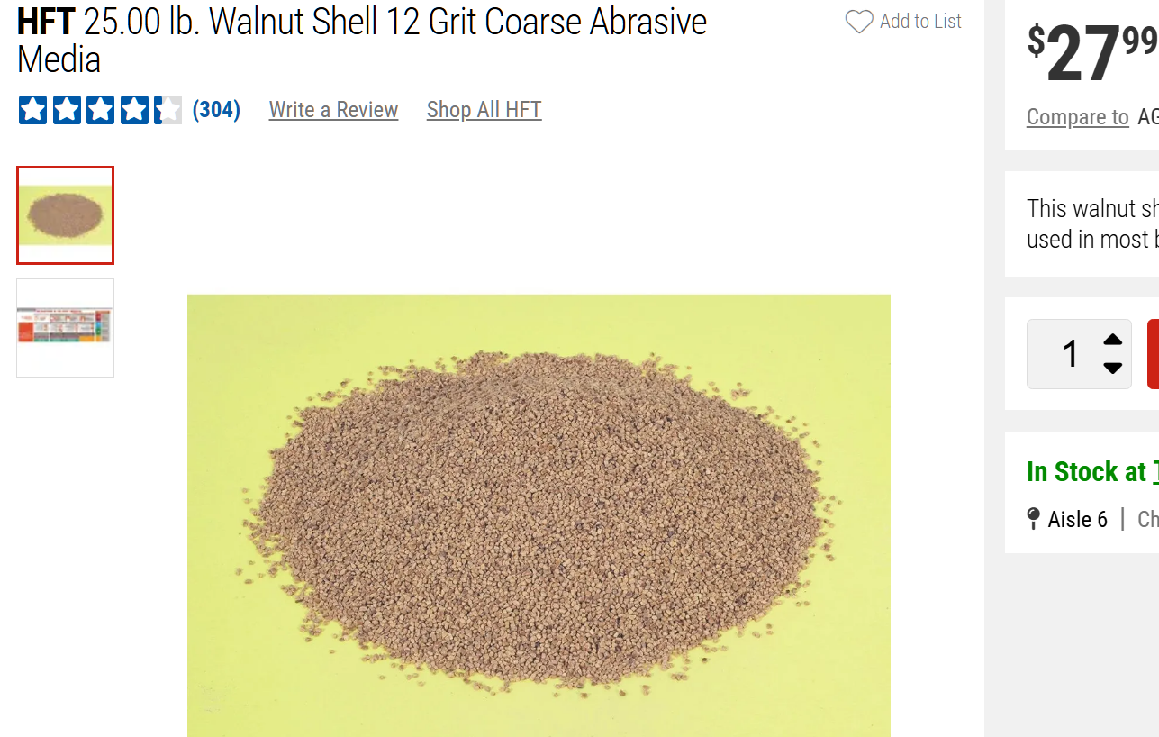

Best price I've found on walnut media is Harbor Freight.
Works just fine. ;)
