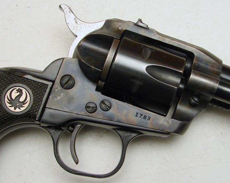

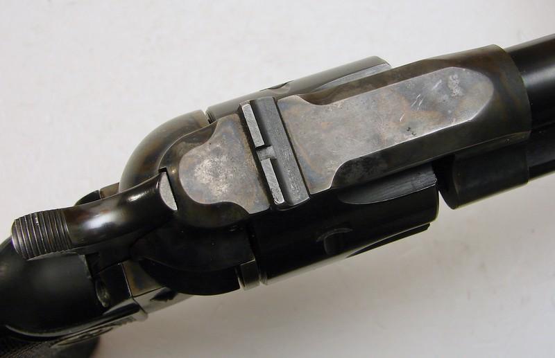

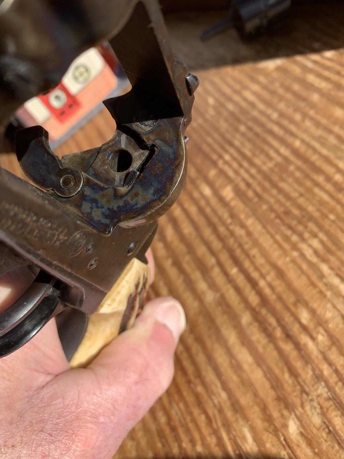

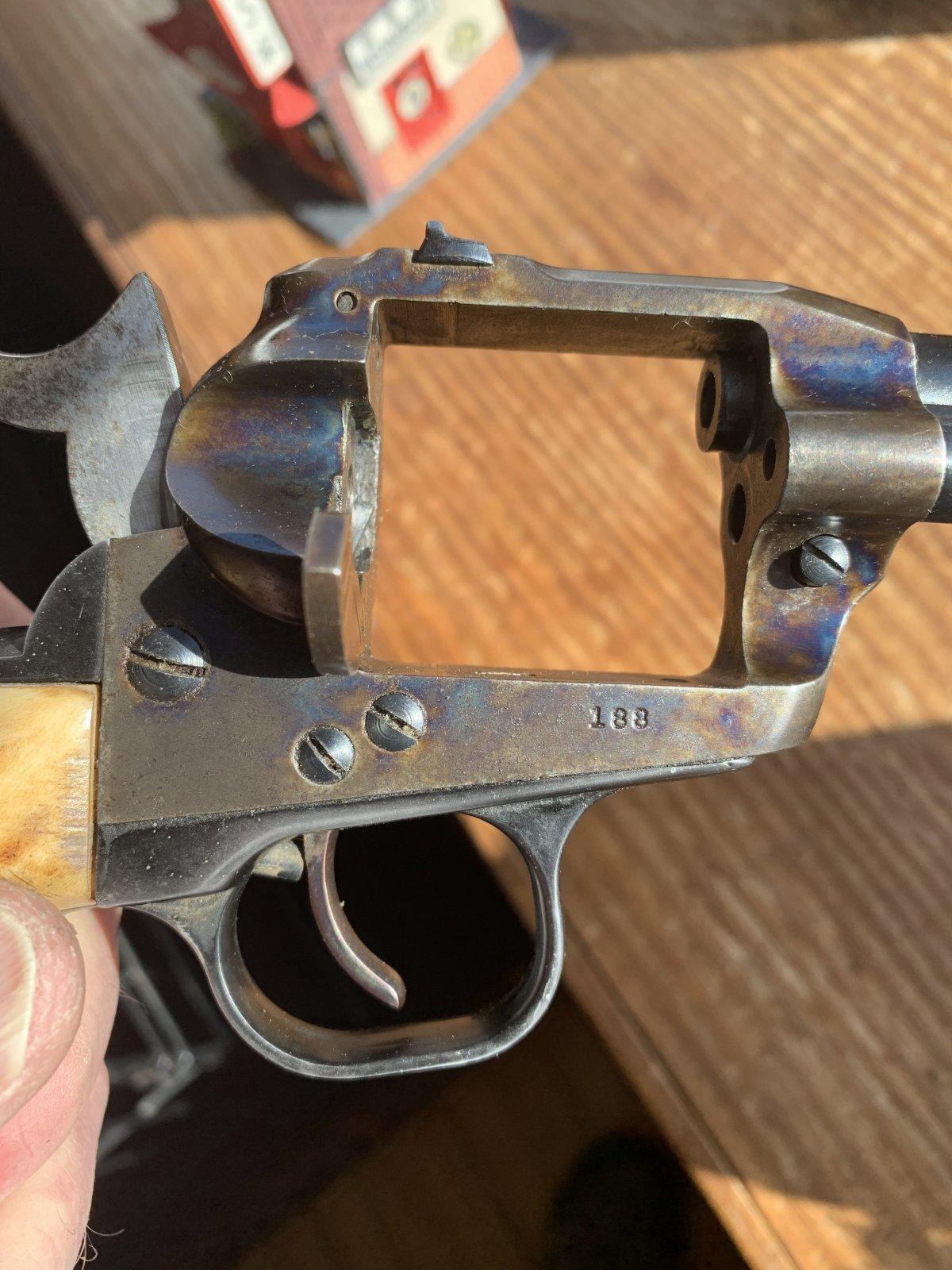

I have a type 1 flatgate with a case colored frame. No history on it, but it sure looks nice! Serial number 1783. I'll try to remember to take a pic of it sometime, maybe today if I can find it. I saw it not too long ago, so I have a good idea which safe it's in.

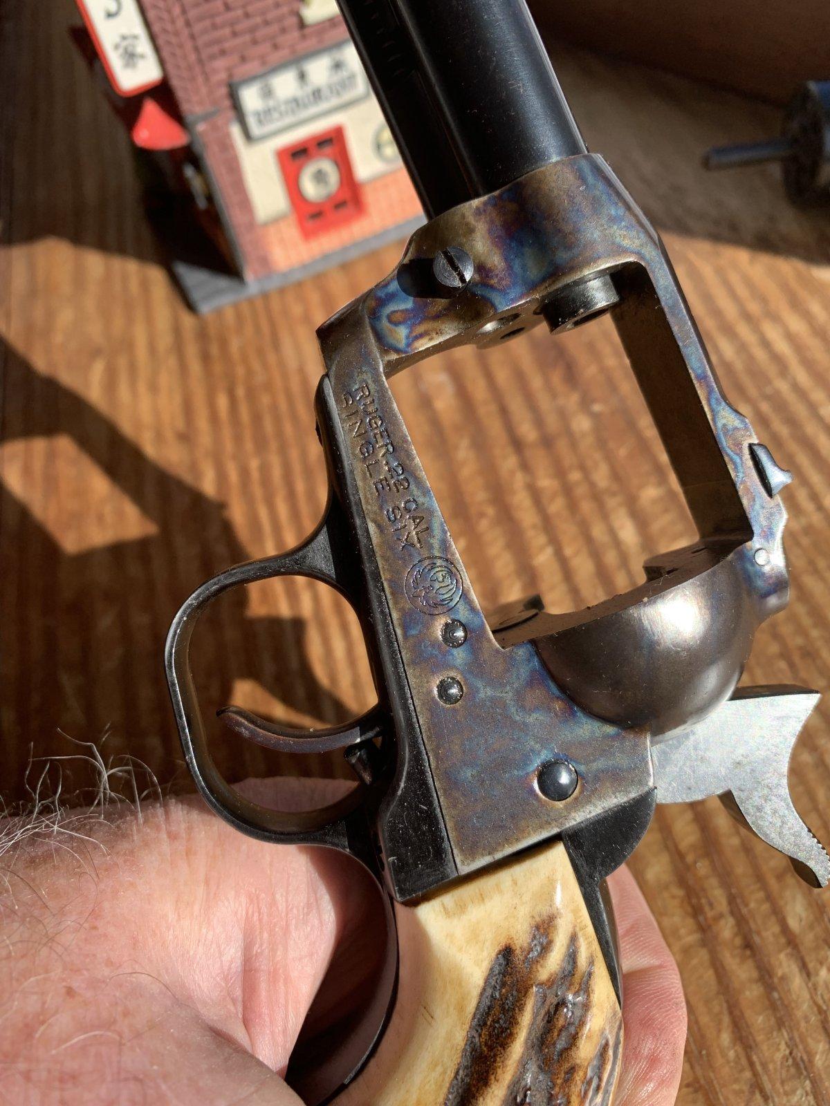

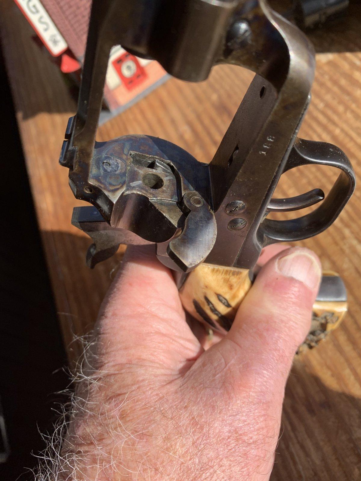

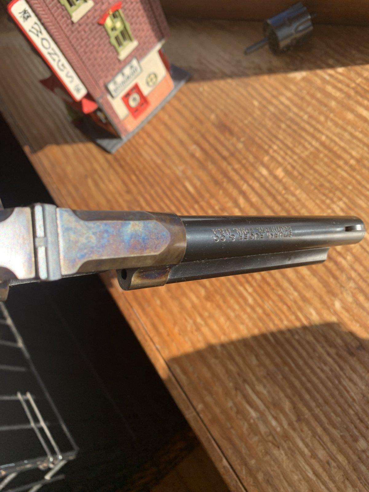

Here are the pictures

Wow.....that looks very nice!!
I'm wondering if whoever had it back in the day didn't like the any of the purple or gold from the metal mixture situation Ruger was having and had it done. Or maybe they wanted it to look like a Colt. A long shot but, perhaps an employee gun?
A letter would tell us when built, and when & where shipped, that is always fun to know, and possibly hold a clue.
Regardless, a nice looking gun and my favorite, a type 1 RSS!!!

Thanks for the pictures,
Pictures definitely display an early flatgate that whom ever did the Case Color did a nice job.
ALL the dust in the screws ???.
And the Stag Grips look very period, they look killer.
The gun has definitely been enjoyed and presents very nice patina.
Very neat gun.

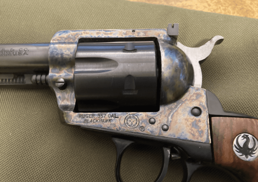

Back to the topic at hand. Here is a Ruger CCH from the late 50's. Brittle around the edges. Gramps looks much better.
TROY,
Good thought.
The factory CCH looks different than what Gramps & WMG posted.
The six 357's CCH by Ruger convinced them it was not worth the effort.

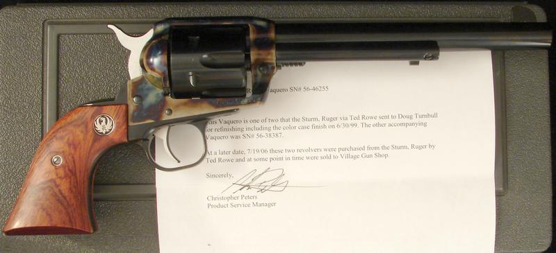

I have a CCH Vaquero that looks way better than factory work and it is documented to have been sent by Ruger to Turnbull for experimental coloring. I think they only did two and decided it was too expensive. Oh, wait, I think I have a pic...
It has the asterisk (or crow's foot) stamp ahead of the SN to denote it as Used.

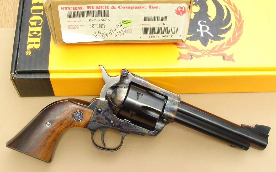

Then I have a NM .45 Blackhawk that was similarly done, its shipper is marked "Vaq Prototype".
My understanding is that there were more of those, maybe even 25 total.

I'm certainly not qualified to even guess one way or the other. What I do know though, is that is a very nice revolver.....Well that, and that it looks to me like the little cross pin which retains the firing pin cup been removed and reinstalled for some reason in the past. I've sat in on "original finish" discussions where-in that aspect was brought up as being "a clue"....I don't know if it matters all that much, just thought I'd mention it is all.

I went in and compared the pin with a few other type ones and it is recessed a little compared to the others that are pretty close to being flush on both sides maybe you got something there
