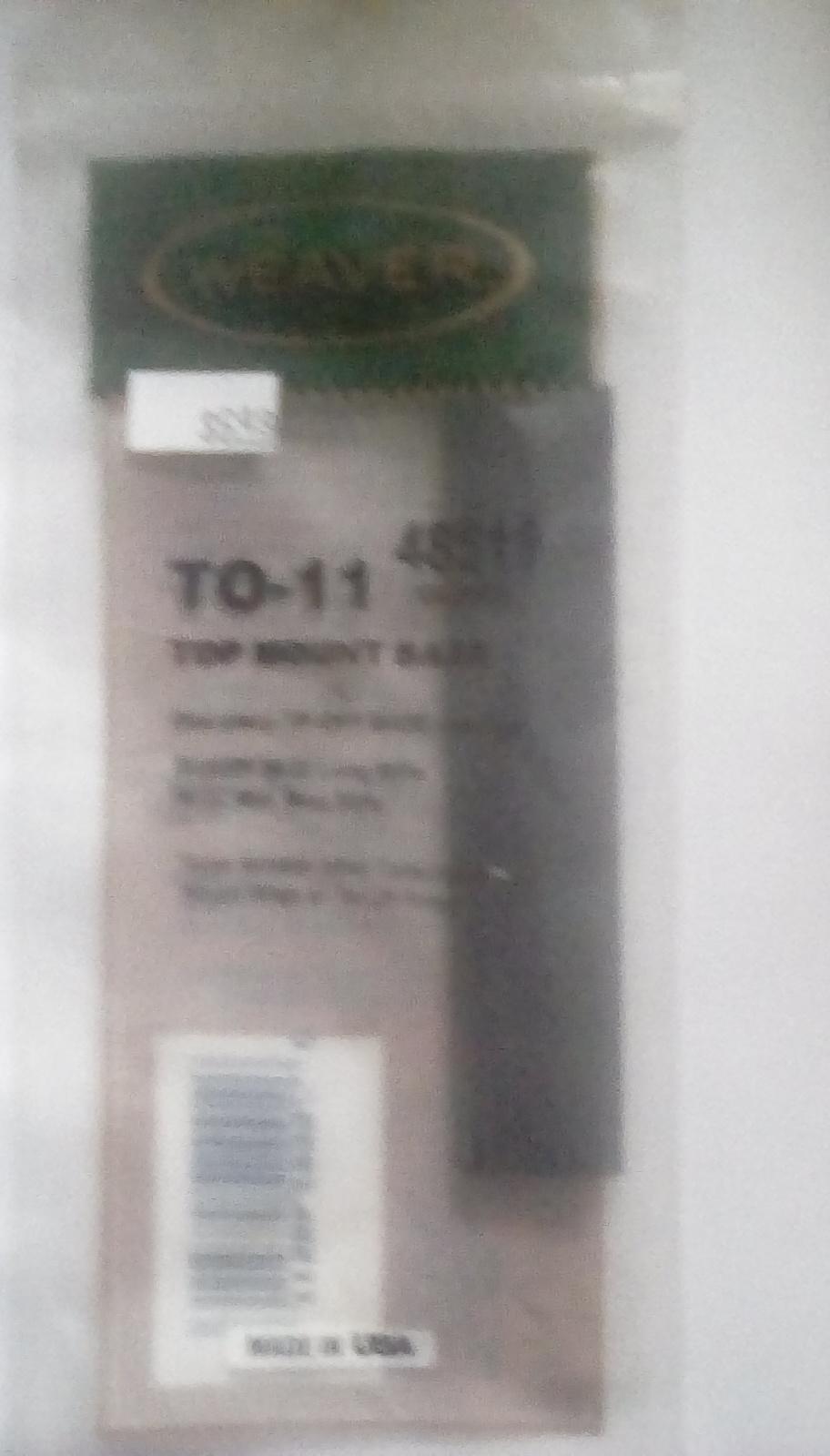

Found the info. Weaver To 11 .
Bad pic , but it's a weaver ,to 11. I have an extra I grabbed for any future buys . Possibly ruger may still sell the factory base ?
The little 3/8" base is available from Ruger and most places that carry Weaver stuff. But if you want a hearty base for decent rings, you will want the Weaver TO-11. Good luck finding one. I have been searching for a couple of years off an on. Never pass up an older gun shop that might have old stock still on the rack. Seems production was stopped long ago, and they are very difficult to find. Still scratching my head over who the guy was at Ruger that figured it would be a brilliant idea to change the hole pattern instead of just going with the same as the 10-22's?

In more of my searching (really digging deep) I also found that there are several places including Weaver that list a different base number and say they will fit both 10-22 and 96-22. The photo only shows 4 holes and I know for a fact that those 4 holes WON"T work for the 2 different guns. I won't waste time and money and trust that this information is correct only to add another unused base to my collection.
