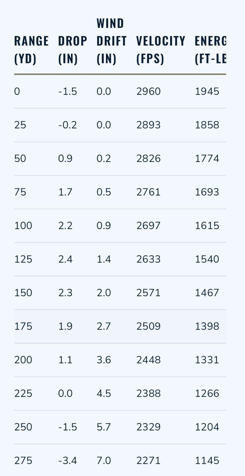

I set my Ruger American today in my back yard, I have always stepped it off and thought it was close to 100 but it isn't that close. It's 75yds and my shot was 1.75 inches high at 75yds, how will that be at 100, 200 yds? It's a 243 Winchester using Winchester 100 grain Power point ammo. I have looked online but can't find anything, thanks for any help.
I went to this site:
https://www.federalpremium.com/Ballistics-Calculator
and got the results below, estimating things about your bullet and velocity. Try it out and fill in the info as best as you can to generate the chart. There are many other such sites - just search for "ballistic calculator" and fill in the values.

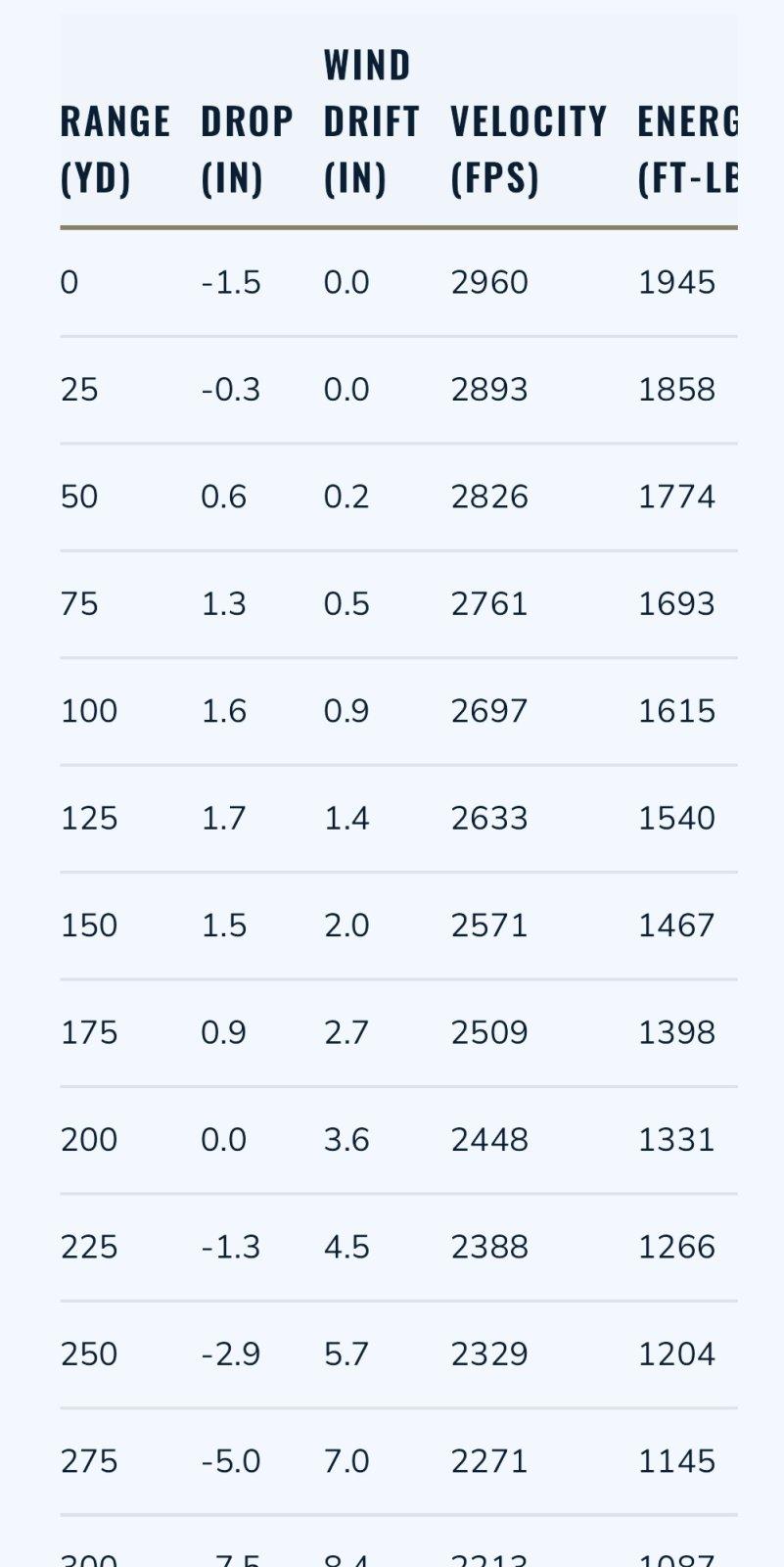

Pal K's second chart is mostly dead on according to JBM ballistic calculations., that I trust & use frequently. I gave it 3000 fps, the Win bullet, 80 deg & 850 feet of elevation which is about average for my county.

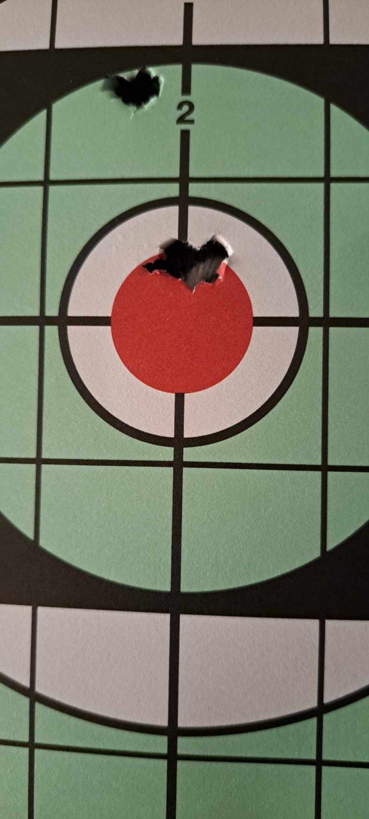

Well I got out this morning and asked my neighbor if I could ease over on him to set up and that way I could be 100yds away. I fired a 3 shot group and decided to bring it down as most my shots will be in the woods. Here is my target with 2-3 shot groups, Thanks for everyones help.

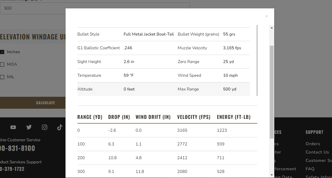

I zero at 25 yds. Never causes an issue.
That really depends on sight height. If you zero an AR in 5.56 with a 2.6"+ sight height you would be all of 10 inches high @ 200 with a 25 yard zero
