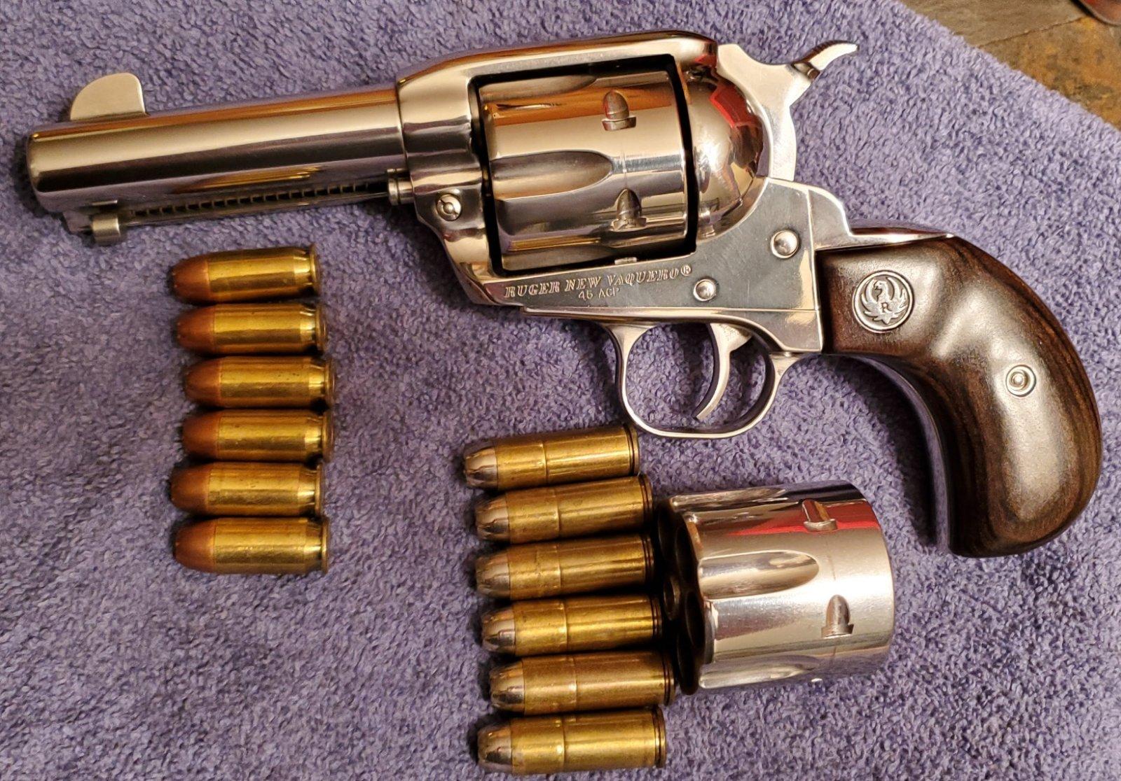

Now that Ruger doesn't offer nor will they fit a second cylinder to the gun unless it left the factory as a convertible, one must be more resourceful if one wants a convertible. I bought a NM Vaquero 45 Colt and wanted another cylinder so I bought a NM Flattop Blackhawk convertible and "borrowed" the 45 ACP cylinder from it. This cylinder I reamed to 45 Schofield by using a 45 Colt finishing reamer with a stop made from a piece of a case so it cuts the correct chamber length for the Schofield, and it worked out pretty good.
Just so happens the Flattop's ACP cylinder dropped in my Vaquero with only about .001" difference than the 45 Colt cylinder the fit was phenomenally good!
Shortly after this our infamous worst POTUS in history issued his EO making conversions like this into manufacturing instead of simple gunsmithing so the rest of us are sol as far as getting one done.

I looked hard for a Blued/CC Vaquero to use for this but couldn't find one and the price on this one was too good to pass up, with only 50 rounds fired.
