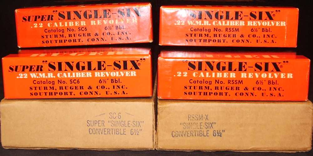

But if you are talking about the box that is marked as model RSSM and also .22 CALIBER instead of .22 W.M.R., then you have a pretty scarce box. There was a mixup at the box maker and they mislabeled a number of RSSM and SC6 boxes, mixing up the calibers. Here is an pic of all the combos, normal boxes on top and the rare misprint boxes below:
Convertibles were offered in the other barrel lengths as well. But only the RSSMX considered the LR cylinder to be the "second" cylinder, so before Ruger started marking the last 3 digits of the SN on the end of both cylinders, the RSSMX only marked the LR cylinder, whereas the RSS4X, RSS5X, and RSS9X only marked the WMR cylinder.

Forgot to add that the SC6 is the adjustable sight SUPER Single Six and of course the RSSM and RSSMX was fixed sight.
Also, the boxes never included the "X" which denotes convertible. That was only included on the rubber stamp used to mark the shipper.

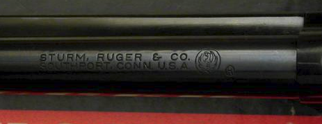

Notice that the early gun has so much text that there was no room for the eagle. So it got moved to the barrel:
Another collector variant came along when they used the wrong barrel roll die without the eagle on a batch.
That early frame roll die was so cluttered with text that placement had to be very precise or this would happen:
I don't know how often that happened but I kept that gun just due to the marking. I suspect the machine was aligned for the regular Single Six roll die but had the Mag die installed so at least one was marked with the offset and Ruger didn't waste stuff, so out it went.

My misprint boxes w/shippers are 1968 (564xxx SC6 marked .22 WMR CALIBER) and 1969 (815xxx RSSM marked simply .22 CALIBER).
There were just a few hundred misprinted boxes, so you are correct that by 1970 they would be back to the WMR marking on the RSSM box in spite of most being convertibles by then. They kept the RSSM catalog number and WMR markings through the end of OM production and never did refer to the 6.5" fixed sight gun as a RSS6 to fit in with the other 3 barrel lengths.
