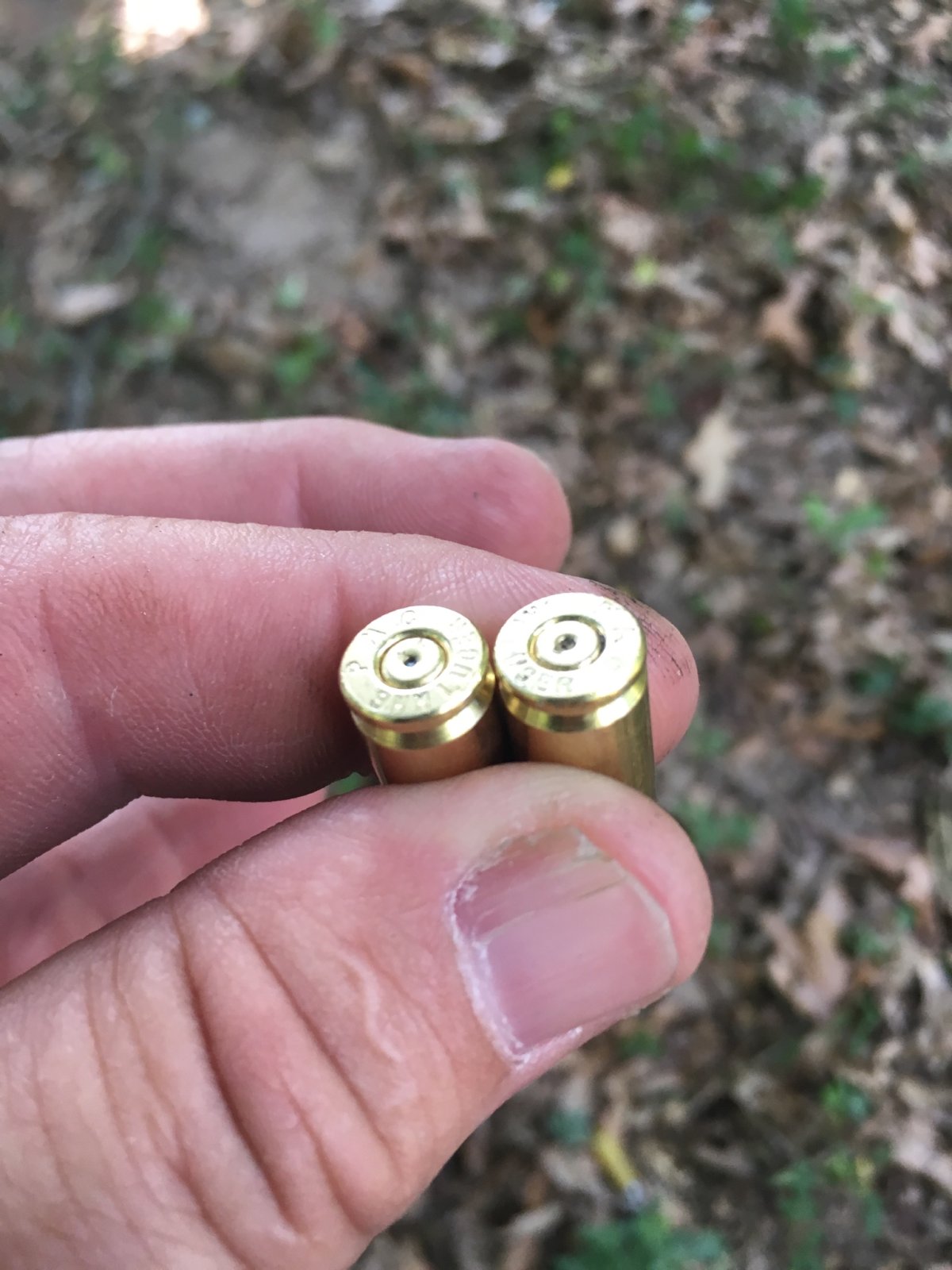

If you have any of that ammo left, I would try it again. Any misfires - I would immediately try again in the other gun. Might help narrow it down to ammo or gun. Do you have or can you get a picture of the primer on one that didn't fire in the 9E and was not sprayed with WD-40?

I've already knocked all the old primers out. You can definitely see they weren't struck very hard.
