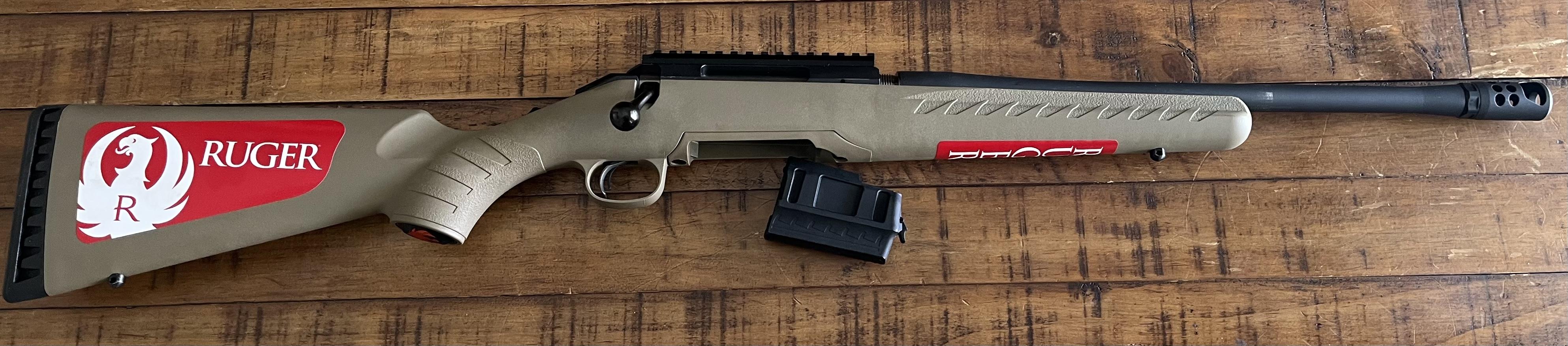

Thank you for those that offered information to me. I found a Ruger American Rifle in 450 Bushmaster. I got it brand new for a very good price. I looked at several options as a host receiver. It turns out the most economical option was the 450 BM. The bolt has the required dimensions to fit the 458 SOCOM. So no bolt work there. I removed the barrel and ordered an X-Caliber pre-fit barrel to my specifications. I have not received the barrel and barrel nut yet. I ordered the MDT LSS-XL Gen 2 chassis for the Ruger American that takes AR mags. The 458 SOCOM works well with Lancer mags. So no modification on the feed ramps or magazines. The X-Caliber barrel will come threaded to take a QD muzzle break to fit my Dead Air Primal 46. I am going to run the stock trigger for now. I have a Ruger American in 300 BO that still has the stock trigger and I have not had any issues with it. So far that rig has taken quite a few deer. All deer taken with subsonic loads suppressed. It is extremely quiet! I am hopeful that the 458 SOCOM suppressed will be equally as silent launching a 500 grain slug.
Back to the rifle. I picked up the complete rifle for less than I could get a Remington 700 receiver used. It was an easy decision to go this route. The action is not as smooth out fo the box as say a Remington or Howa but with a bit of work they can be very nice actions. I am going to lap the bolt lugs and smooth out the action so that it glides easily. It is very easy to do. A bit of patience and 50,000 grit paste gets it done. I am going to work on the sear and release interface. Using some policing stones to make the interaction between the two surfaces like glass.
I think that it will take me a few months to get this complete. The barrel will be weeks before I get it delivered. The go and no/go gauges will take a few weeks as well. The MDT chassis will be here next week. As for glass, I have not gotten that far yet.
I will try and document this build so that others can see if this might be an option for them.
Getting the barrel off the stock Ruger was a pain in the ass. You will NOT save the stock barrel nut. The stock barrel nut is smooth with no lands or cuts to bite into to remove the barrel nut. I used a standard red pipe wrench to bite into the barrel nut to loosen the barrel nut. The barrel nut was toast. Once the barrel nut is loose, the barrel screws off easily. You are going to need a vise that is secure to a bench. I secured the barrel in a barrel vise. The barrel vise was secured to the larger vise that is mounted to my work bench. Let the pipe wrench dig its teeth into the barrel nut and then loosen away.

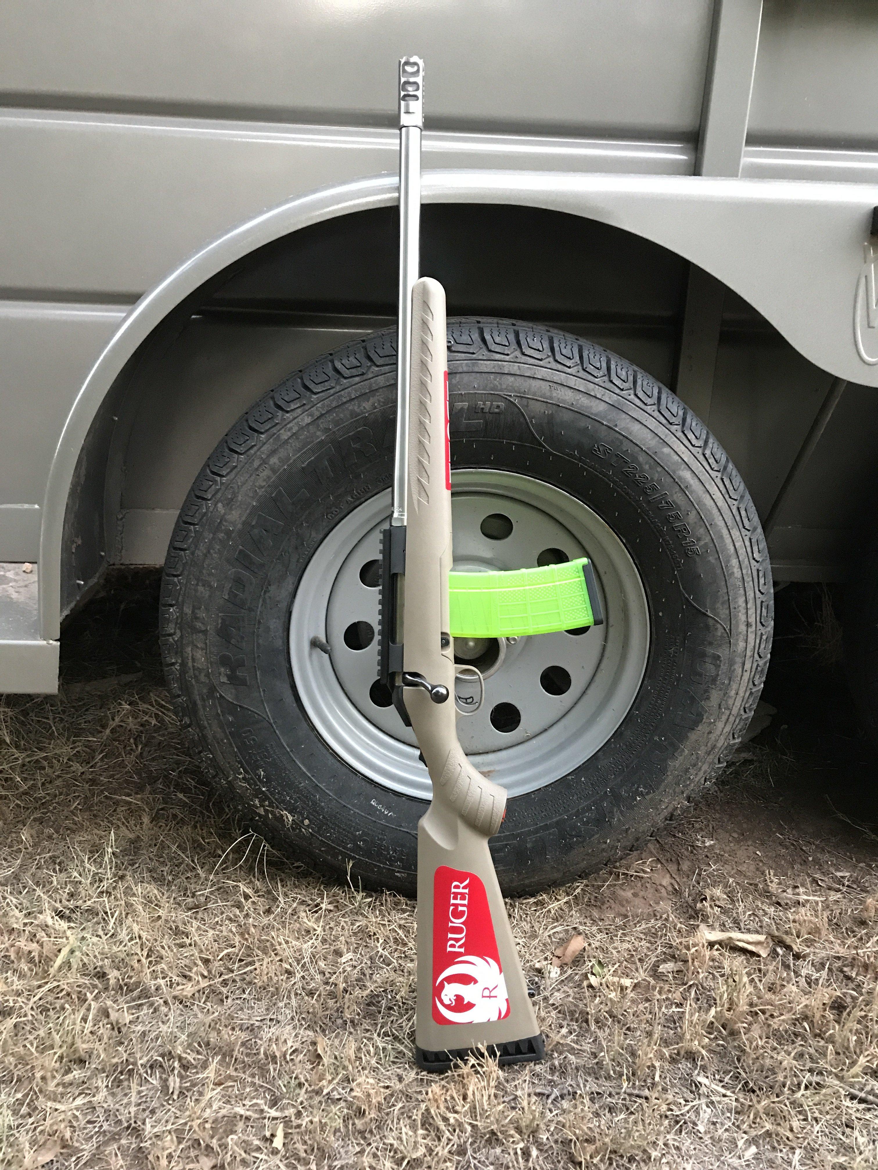

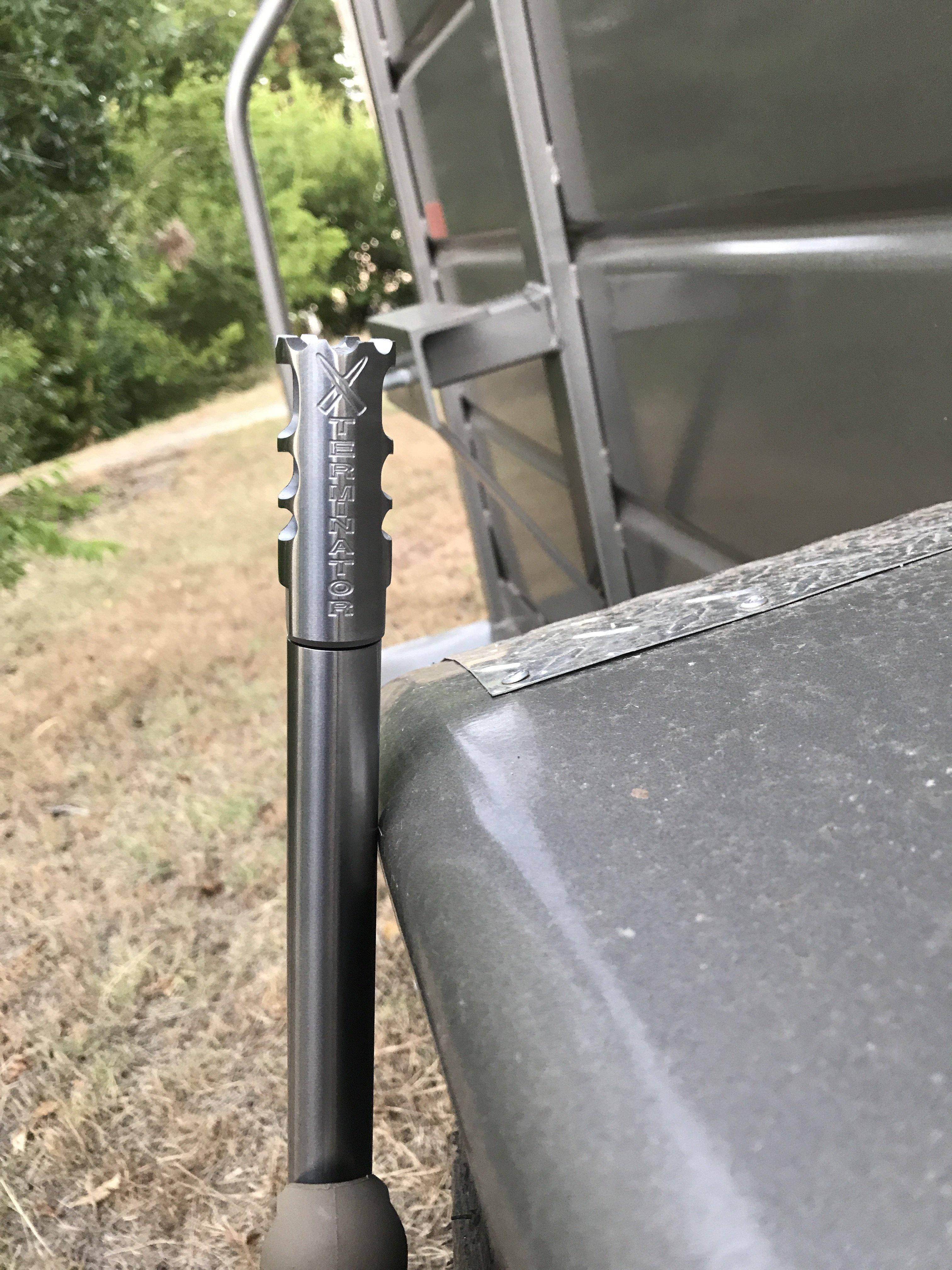

So I received my barrel yesterday!!!! It looks great and the fit and finish is very good. So far I am fairly pleased with the X-Caliber barrel. Here are the specifics.
416R Stainless Steel
16 inch barrel
458 SOCOM 6 groove 1:14 twist
Remington Sendero barrel profile
Muzzle threads 3/4x24
I set the headspace and the barrel lock nut easily. I will get to the range as soon as I have availability.
The next project will be getting the best load data and accuracy testing. I am not sure if I will refinish the rifle now or wait until I am done testing the accuracy potential. I am still wanting on my Primal 46 suppressor. Hopefully it will arrive any day.
