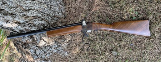

I've had three No.1 rifles re-barreled by McGowan's Precision Barrels. They all shoot great and are accurate. They were not cheap and there was a long wait, but worth it. A lot of companies don't want to work on No.1/3 actions.
I had them convert a RSI 7x57 to 35 Rem., a K1-B 270 to 35 Rem. and a 1-H 375 H&H to 454. I bought a badly abused No.3 22 hornet that the barrel looked like he had been shooting black powder loads and never cleaning it and the stock had been broken and repaired with Gorilla glue, I got it cheap. I put the 20" 7x57 take off barrel on it and then contacted Ruger and bought new RSI wood for it. I later picked up a used, shortened stock and made it a "Youth" model for the grand kids.
My No.2? 13? 31? Frankenrifle? 7x57
Have fun with your project and get what you really want.
