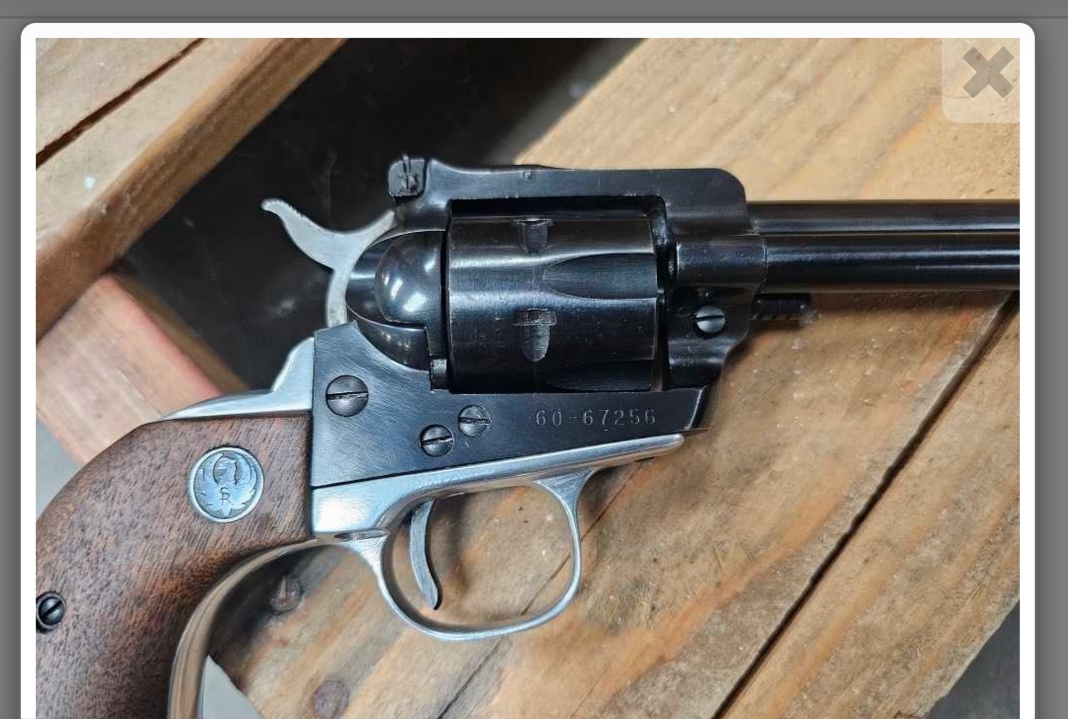

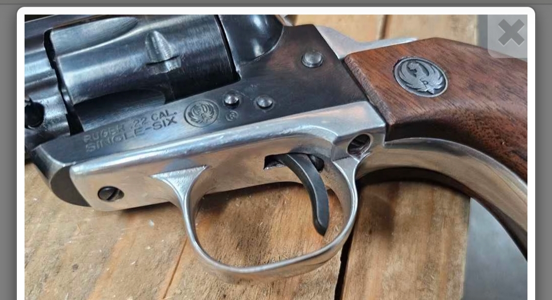

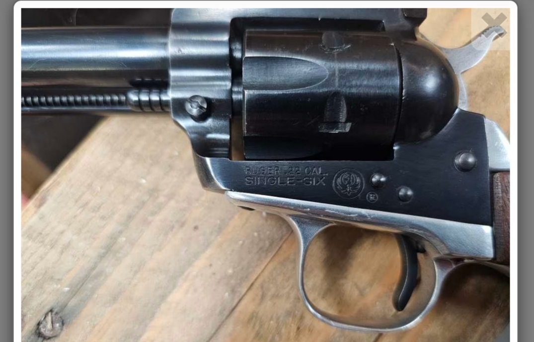

Why does this Single-Six have a polished aluminum frame? Factory? Rare model?
Dec 30, 2022
917
Pahrump

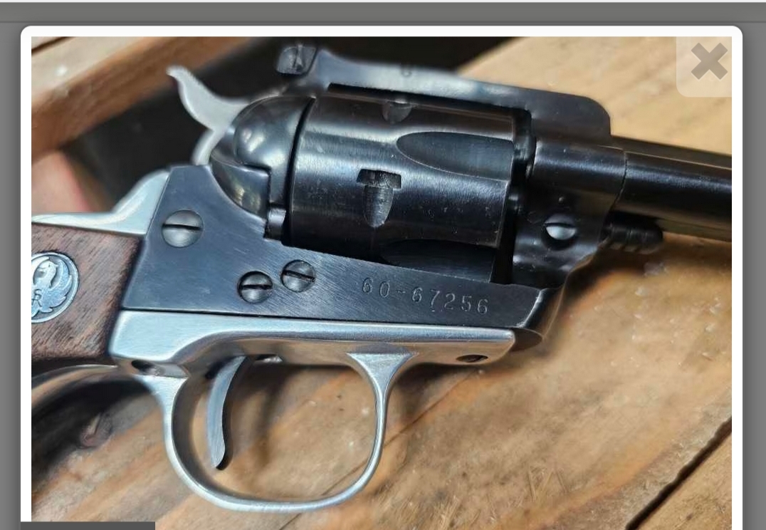

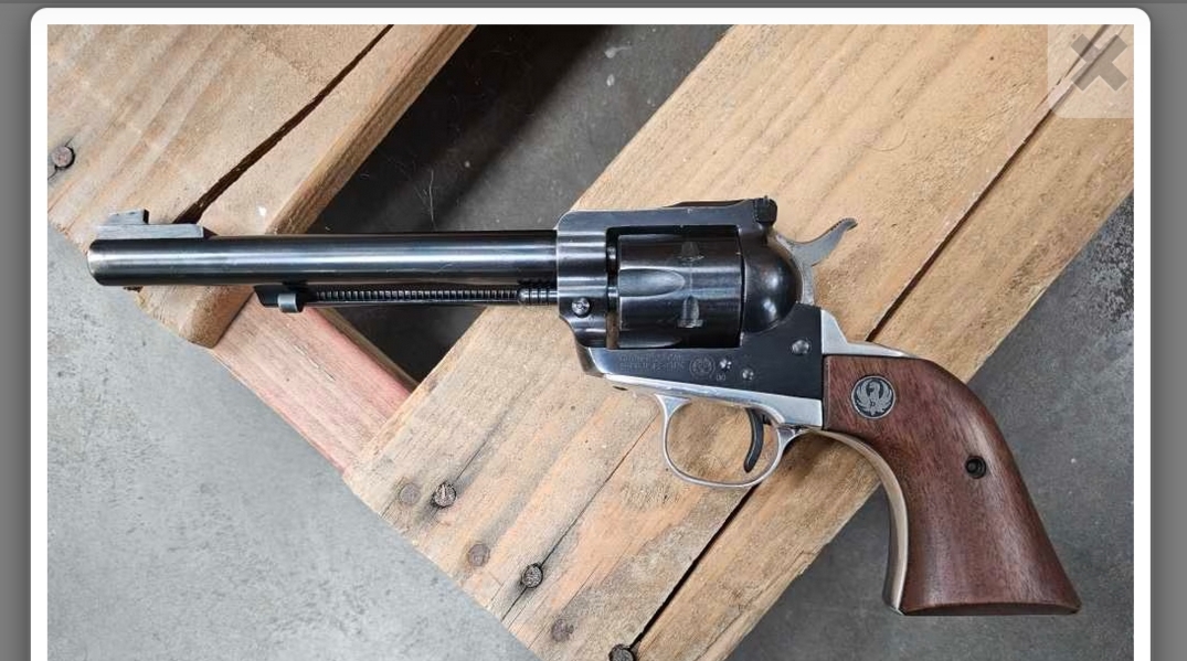

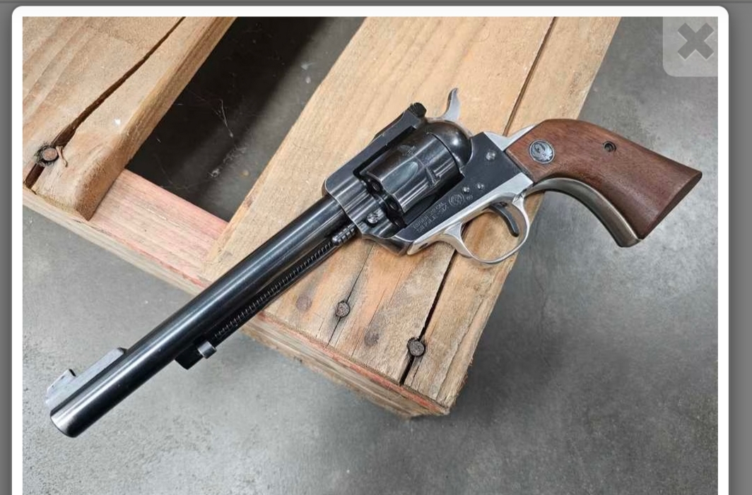

Saw this online. Made in 1971? Three -sceew Single-Six.
Register to hide this ad
Didn't all Ruger Single-six revolvers come with steel grip frames over the last 60 years?
No! Check here . . .
looks good to me, and yes its very practical, and "lasts", just don't use a stone wall or a rock, for a "rest", plays hell with the bottom of the grips frame.......:unsure::rolleyes:
...yes holsters and rings on your fingers will do a number on any grip frame, steel or aluminum.......:cool:
As noted,, not factory & commonly done by folks who want a different look or to finish removing the black to get a uniform finish.
And to answer Air-cooled,, no,, not all of the grip frames over the last 60 years were steel. Only a select few models have steel grip frames.
You can get a good detailed description by going to the GunBlast link.
Specifically referring to Single-six revolvers (not single action as a whole).The gunblast reference cited above is not clear as to when the single-six .22 went to steel. Ruger currently advertises their single-sixes as all alloy steel. Sorry if I'm not picking up on something.
I'm certainly no expert but I don't ever recall a Single-Six with a steel gripframe other than the baby Vaqueros in .32 Mag and stainless guns.

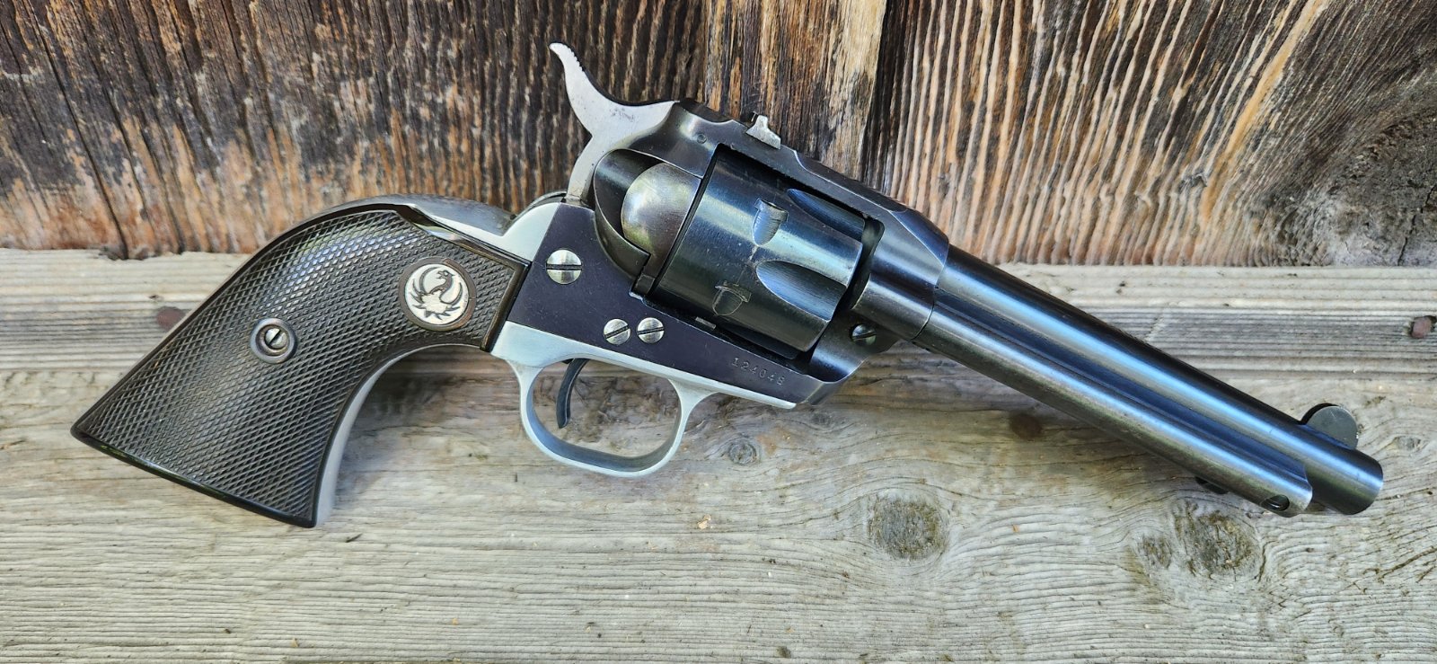

I would not call that polished. I'd say they got two thirds of the way towards a polished grip frame. Way too many scratches, dullness, and sanding marks to be called polished. Below are some of my examples. After I did these I found beat up ERHs and polished them and sold them on eBay a few times until I had an issue with a customer that took the fun out of it.

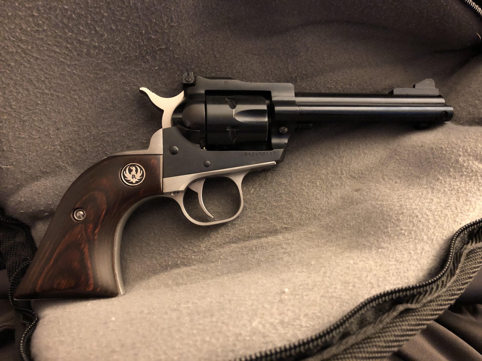

I did that to my 2015 Super single-six. The finish on mine was perfectly fine, I just did it for the two-tone look. Mine had the painted or powder coat finish and was in good shape but I just did it for the two-tone look which I like. I used paint remover and then polished it out with some Mother's Mag Wheel polish. I was surprised when I did mine because there were some imperfections in the finish which you couldn't see when covered with paint but could when you stripped the paint off. I don't have a picture after I finished it but looks just like others shown in this thread. I actually purchased a stainless steel grip frame from Brownell's for it but never got it fitted to suit me so gave up on it and kept the polished aluminum grip frame on it. Attached is a picture of it wearing the stainless steel grip frame on it.
