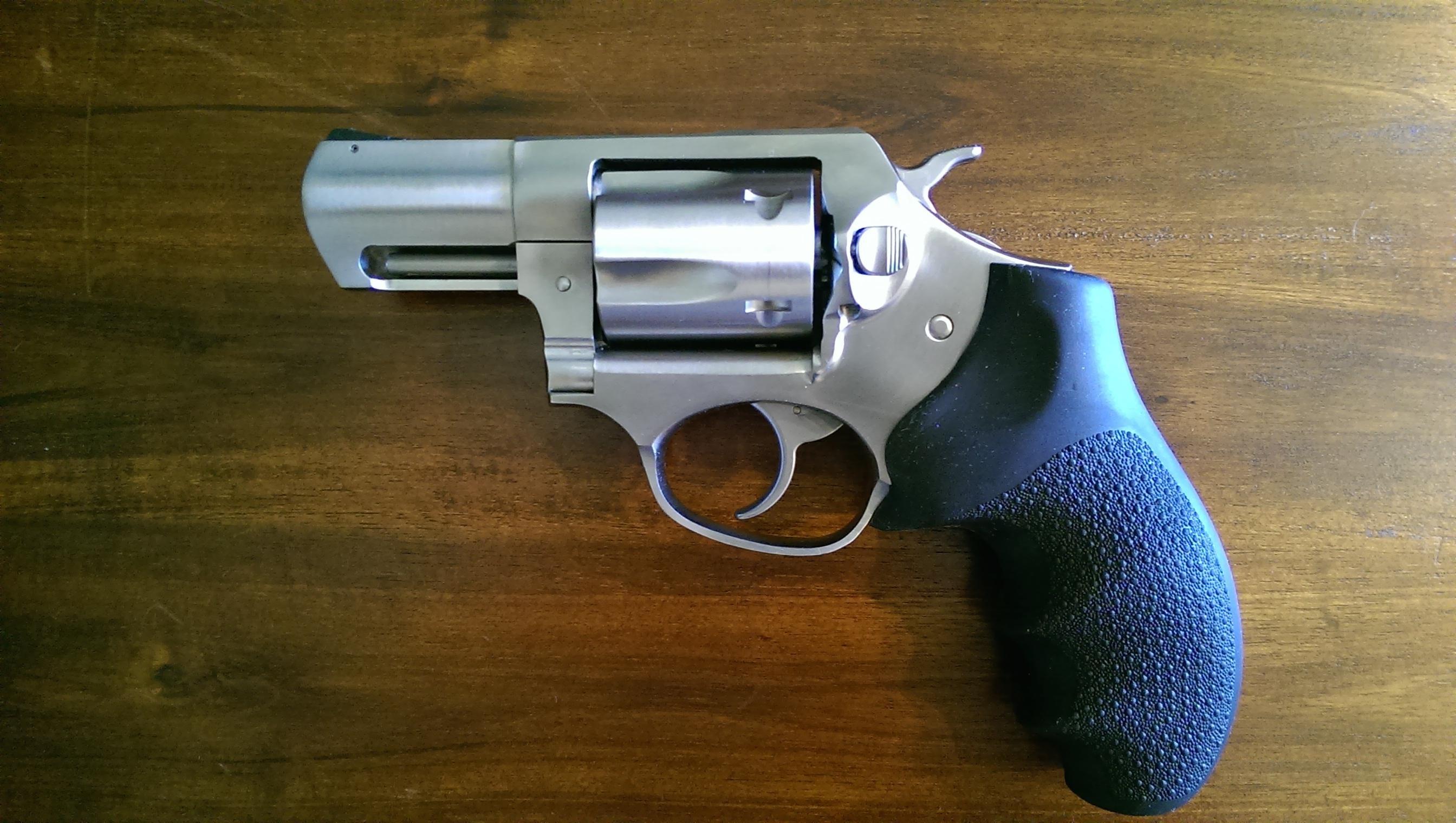

Found a Hogue Black Rubber grip for $12 Shipped NEW + Ordered a shim kit & a Wolff Spring Kit
Made sure to get hammer dog shims + Trigger & Hammer shims
Back when I had my last SP101 I had to make the shims from feeler gauges & even back then got springs from Wolff Gun Springs
Stoked to finally have a SP101 coming my way, It's been almost 20+ years = Can't Wait!!!
I do remember not being able to use the lightest hammer spring in the 9mm SP101 as the moon clips seemed to soak up some of the hammer strike
All of the old SP101s were that = the older style with non MIM Parts
This will be my 1st of the newer type & my 6th SP101
Sold many off to fund my 1st Home, But it was worth it...
2-1/2" Ruger SP101 357 Magnum

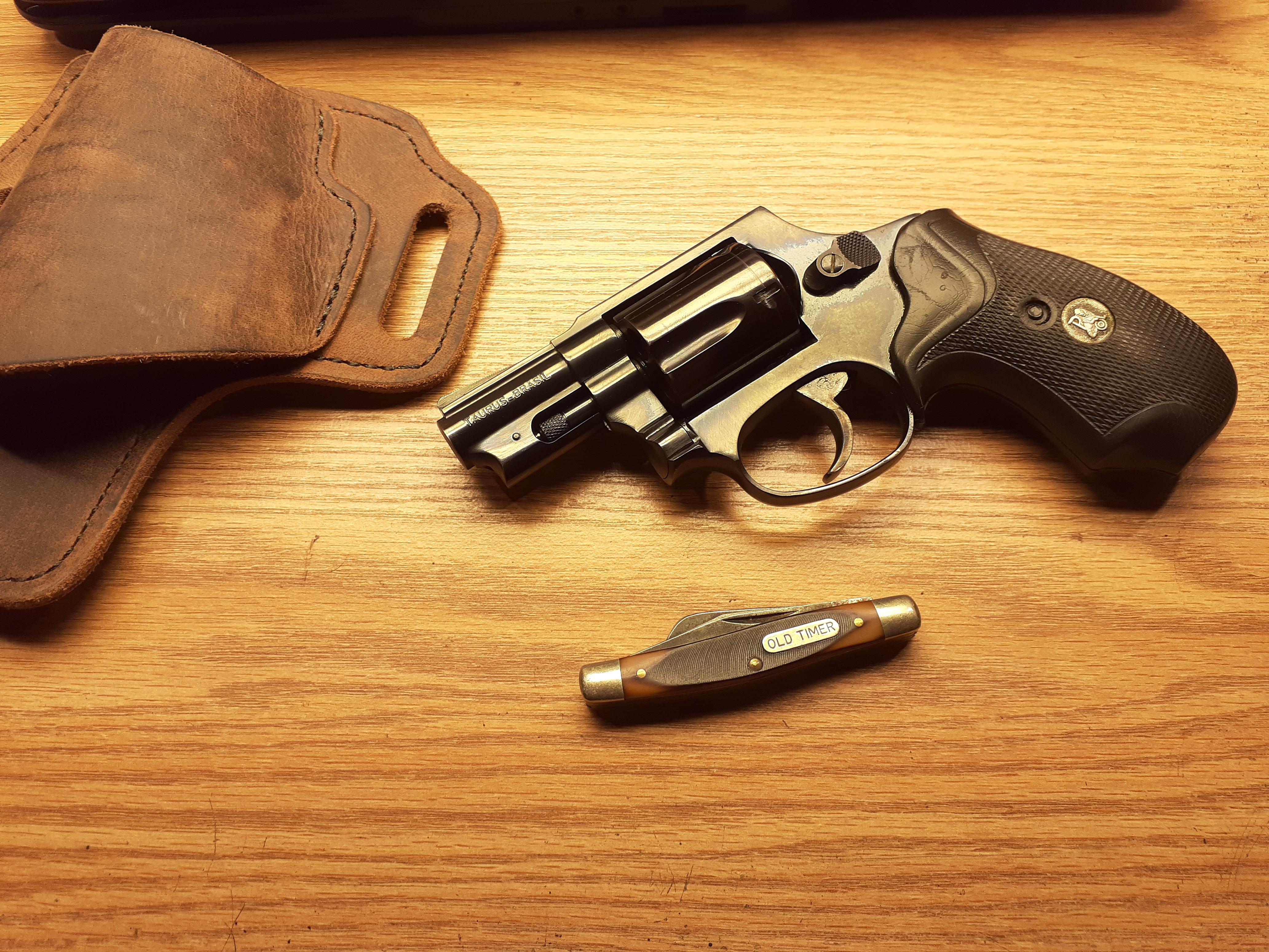

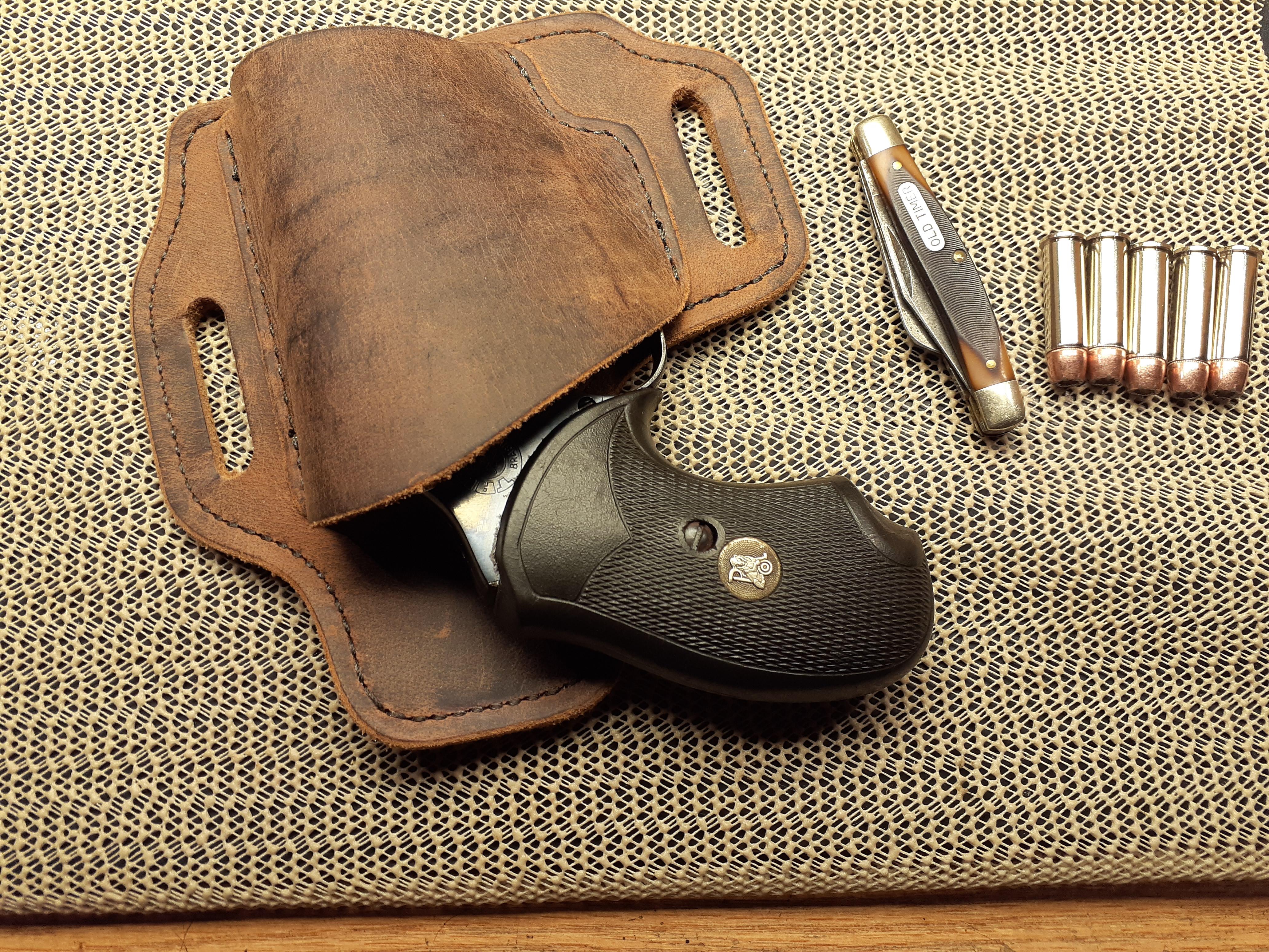

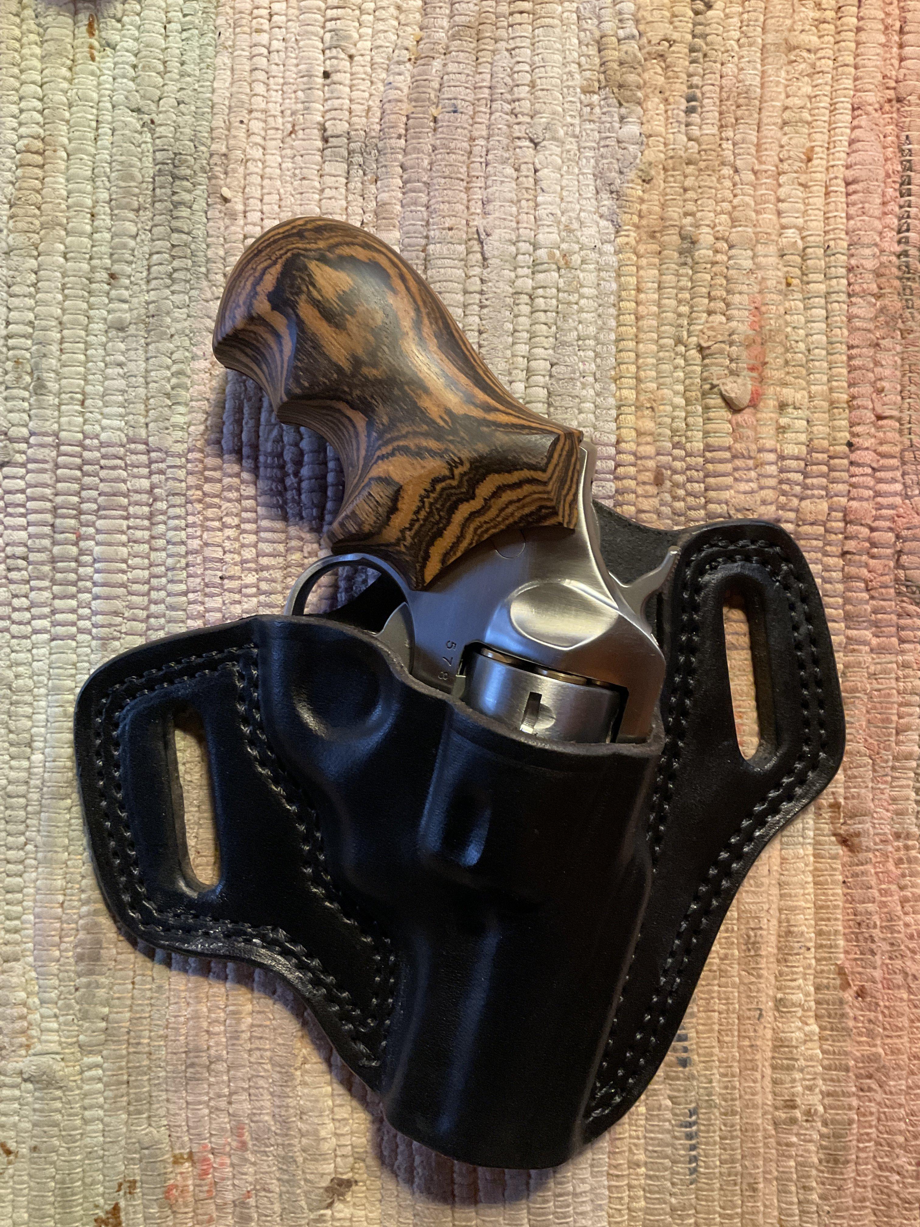

I have a couple in my stash that are big enough for the SP101 snub, It's a bit bigger than a S&W J Frame & some Colt Detective Special holsters work quite well.

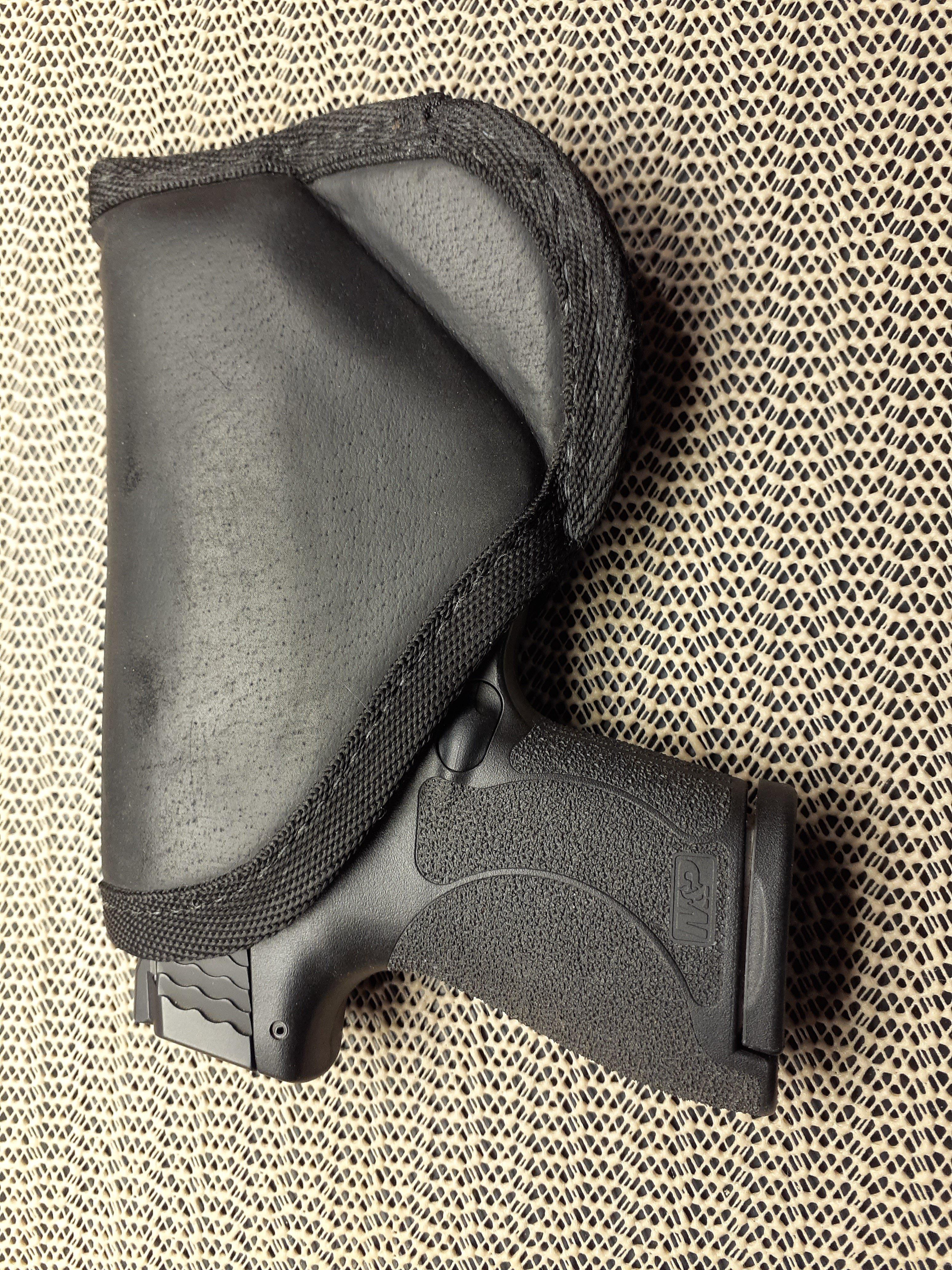

I also have a Sticky that will work too
This Holster was made for a Hk P2000sk, It's softer Buffalo Leather & gives some

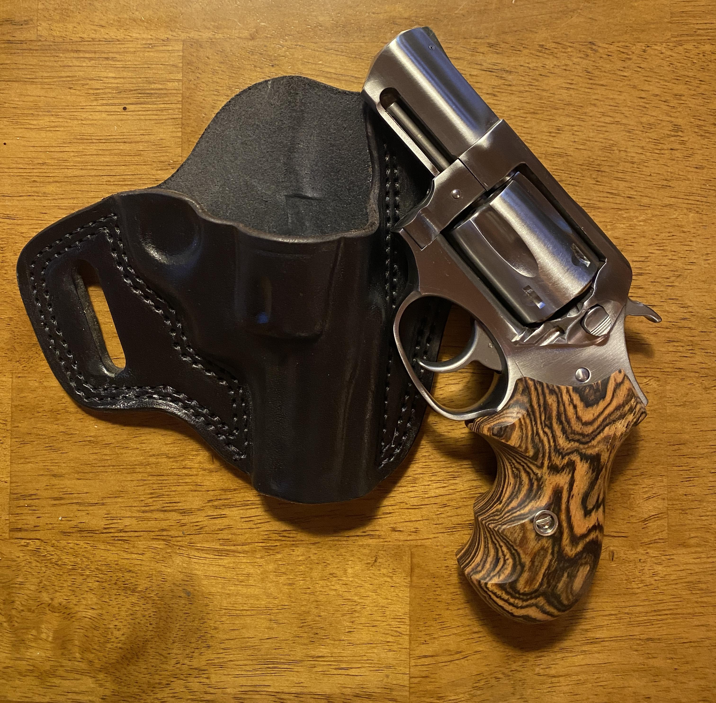

Here's the Don Hume JIT I just got from Sutter Holsters

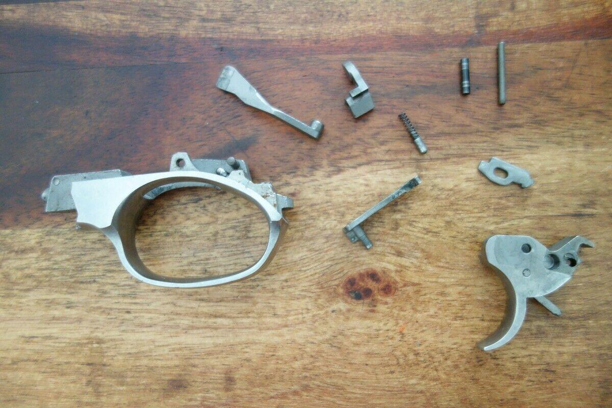

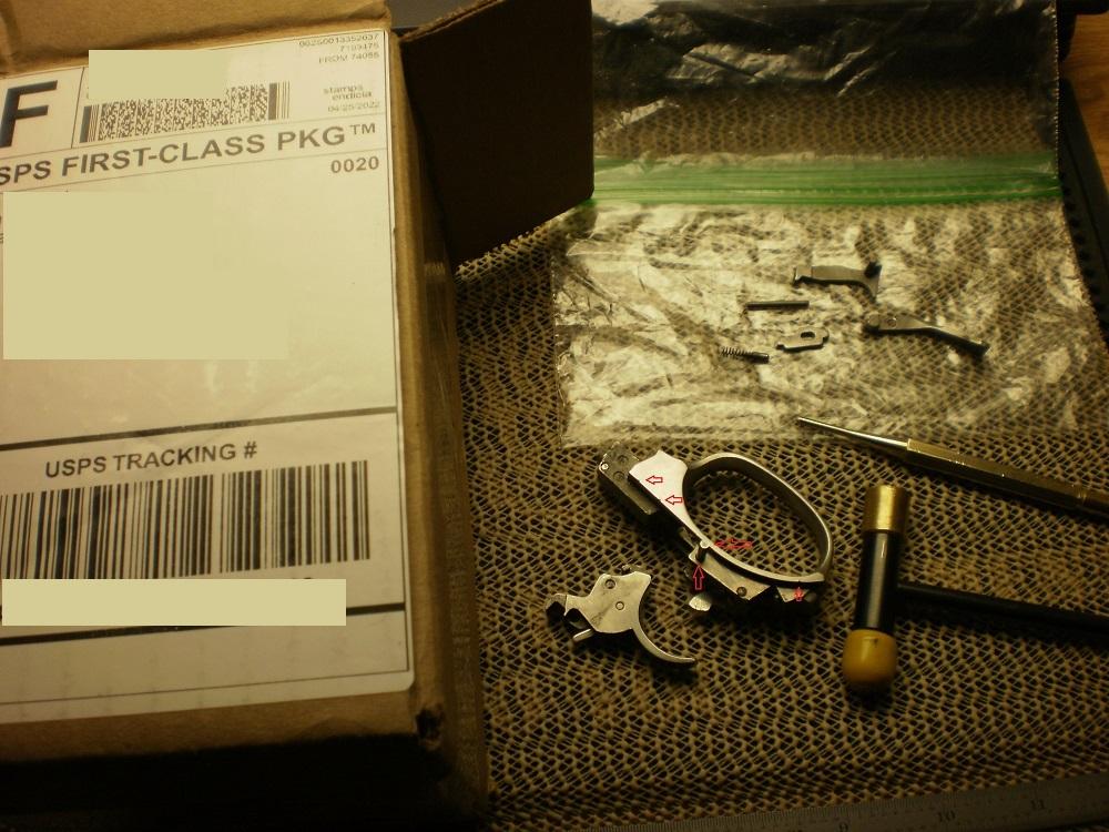

I ordered a trigger group from an early SP101 to mate to the DAO early hammer
The trigger group I received was warped & bent so bad the trigger pin wouldn't push through or even drive in with a hammer
You could see whom ever took the revolver apart pried the trigger group out with a screwdriver warping not only the group but the trigger too
Pretty much made the parts scrap, they are boxed up for a return to the seller.
Be careful what you buy
I wanted a solid non MIM trigger so I could round the face & do the shoeshine technique with a strip of crocus cloth & polish it smooth as glass
Polished the pivot pin for the trigger & still couldn't get it to push or dive through the trigger group I bought or the trigger either
Took these photos to show where they are bent or warped for the seller
Red arrows show the pry marks & where the holes aren't aligned
The only usable parts where the transfer bar, hand + plungers & springs
Total waste of my time ordering this thing 👇
