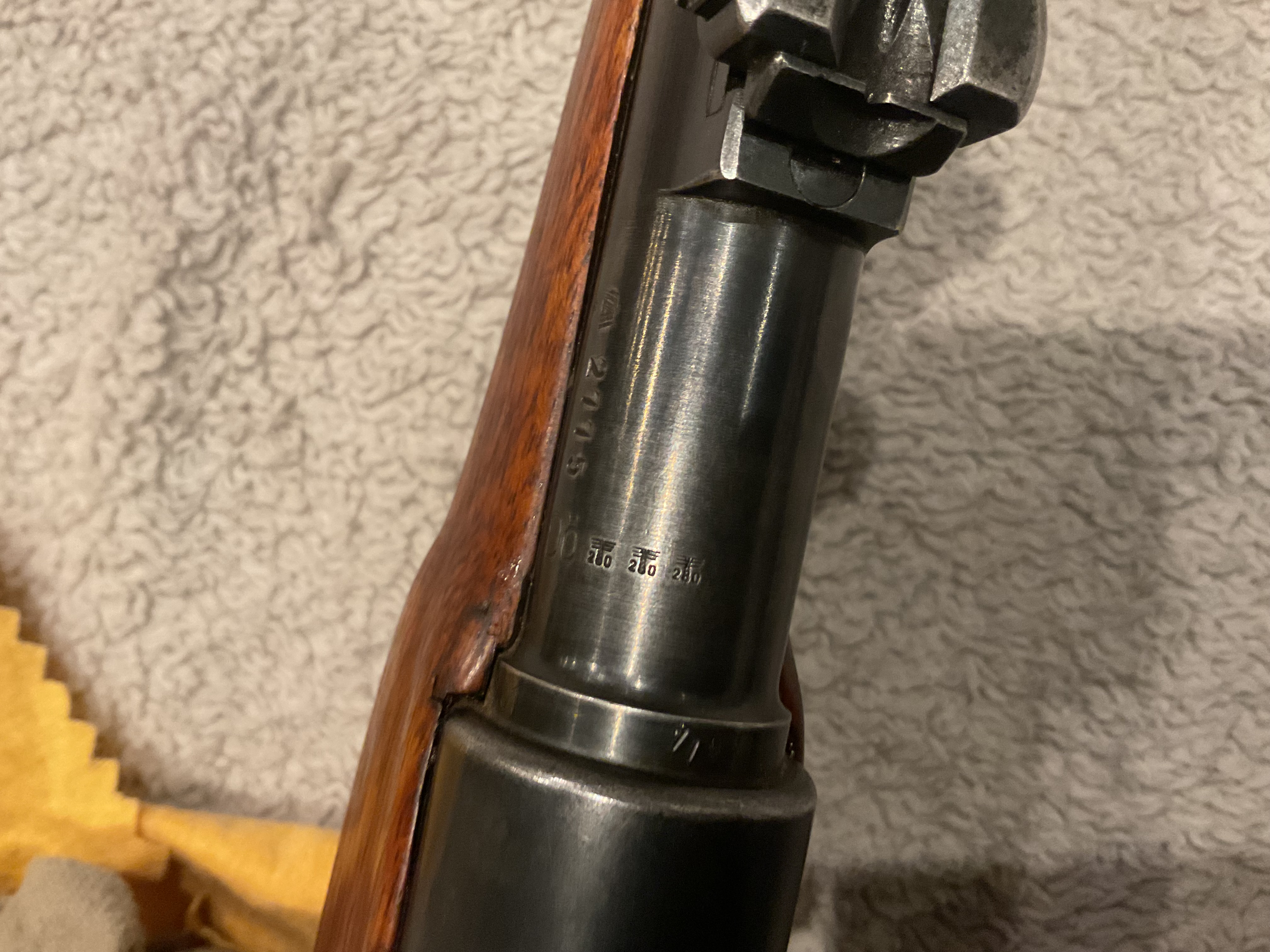

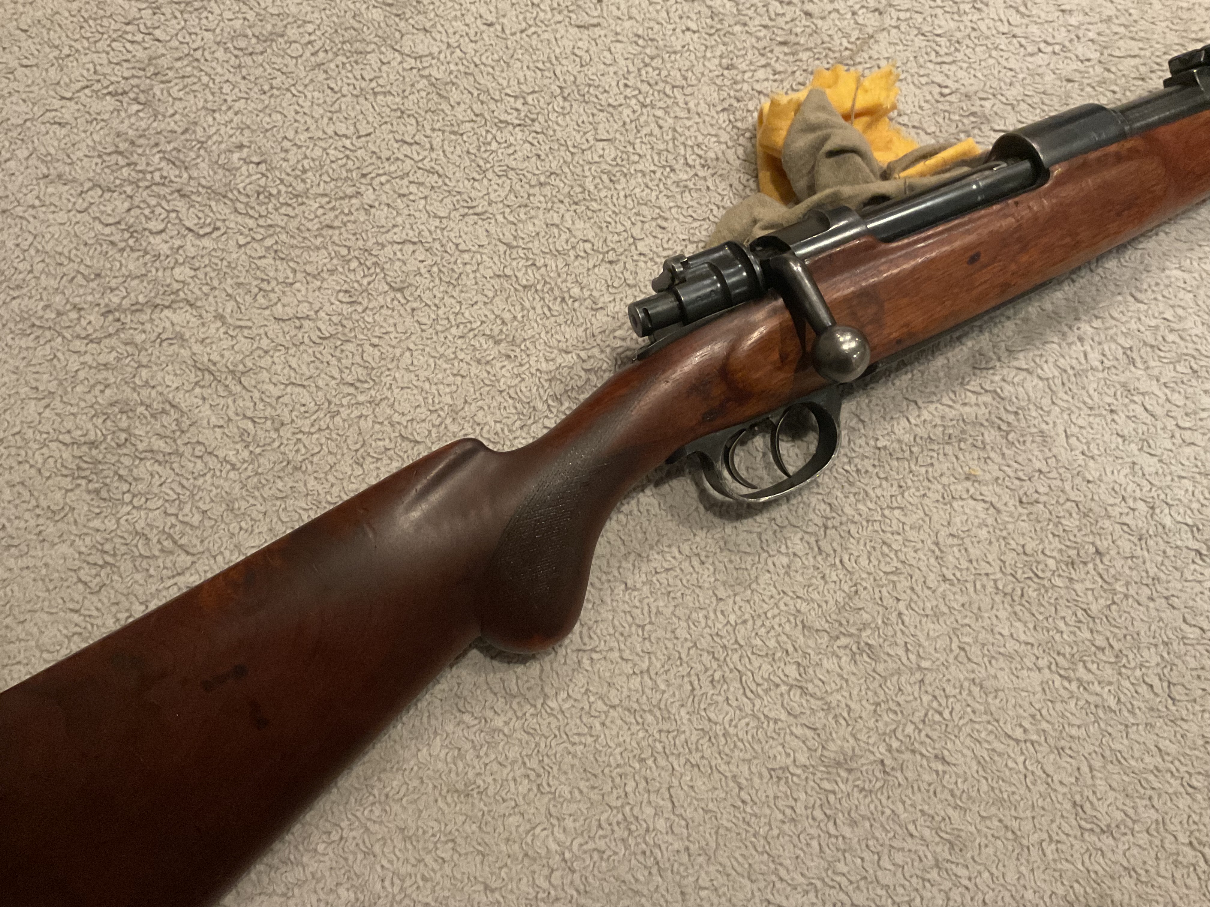

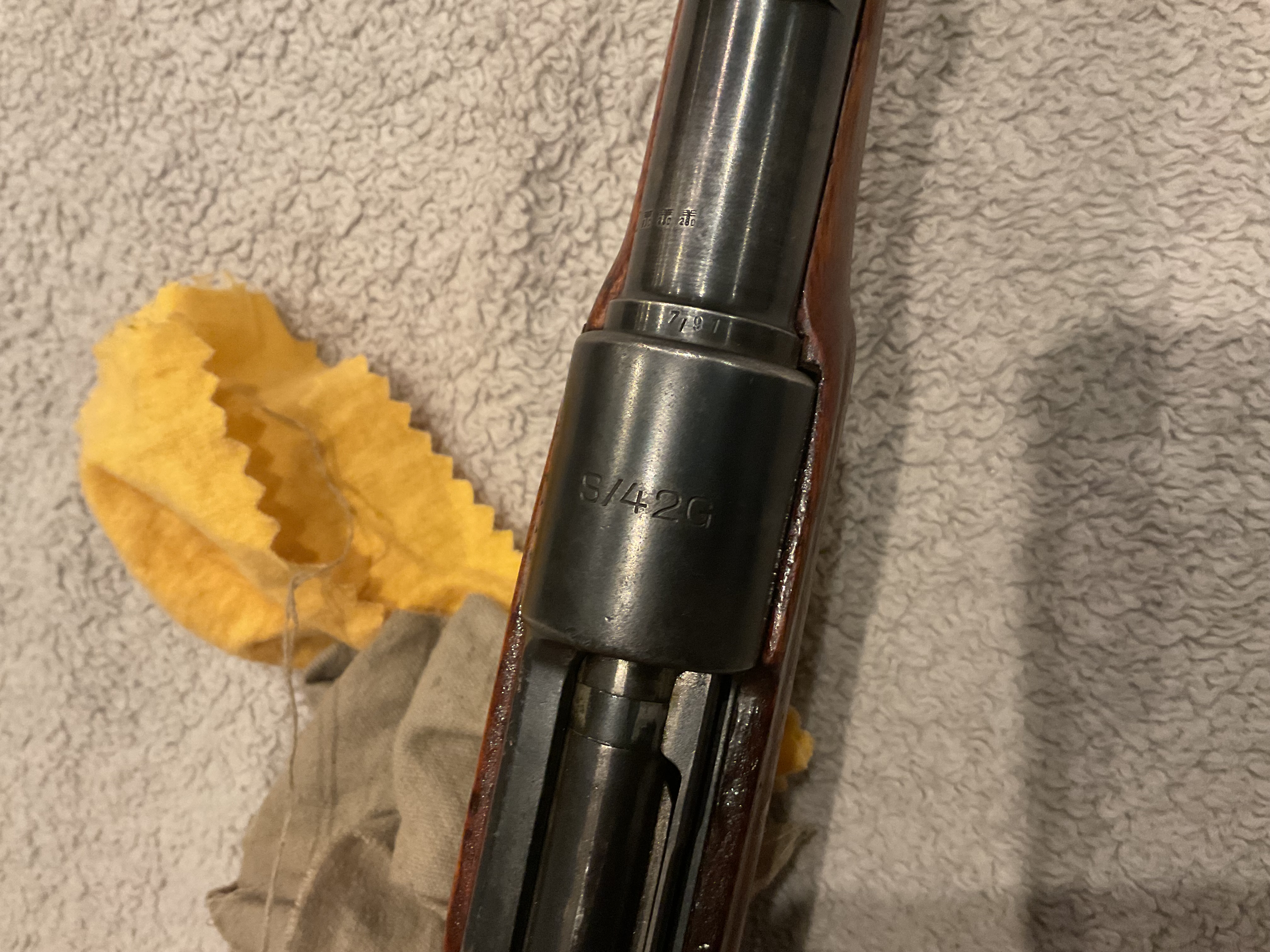

Would anyone know this bolt rifle MOD 98. The pictures are the only markings I can find.
Would appreciate any advice.
Thanks

Google "S/42G mauser", and you'll find plenty of info.
Early German issue military K98. Yours has been sporterized, likely quite some time ago by it's looks.
Has a nice vintage look to it and I dig double set triggers.
TDF
Thanks for information, I googled it early and it came up with Mauser. Unfortunately I didn’t see any pictures like this one so didn’t know for sure. I must say it is the smoothest bolt action.
It shows early Wiemar Republic eagles and Nazi eagles. It is a post-WWI MOD98 transitional rifle (made in 1935) that was reworked and issued for WWII and then later sporterized with double set triggers.
The trigger guard is not flush with the stock showing extensive wood work or sanding. The way the wood is shaped is typical of post-war German style sporting (hunting) rifles.
It looks to be in the original 8mm (7.92mm) mauser caliber.
The barrel and receiver have matching serial numbers. Typically, in German numbering conventions, every part will have a matching serial (last two digits).
The bolt appears to be unmodified.
Thanks, the serial number is on every part. It looks like it has 7.91on the barrel?
In the picture the serial number is 2115, but the number by the site looks like 2775 near “DO” I can take better pictures.
Just wondering if it’s sort of a knock off or something?
It's a shooter. It does have some value as a post-war bring back. Many GI's brought back original Mauser K98s, and purpose built converted K98s. It should make for an excellent dear rifle, especially with those set triggers. It hasn't been drilled for a scope. It still has it's original military iron sights.
I agree, shoot it. 8x57 ammo is easy enough to come up with.
Did the barrel get cut? Does it still have the military front sight?
If so, and if you wanted to, you could probably source all the correct military hardware/wood, and restore it to it's original military form. Since the bolt never got modified and it was never tapped for a scope.
I think it's matching numbers of 2115. Just a font that makes the 1's look like 7's at times.

The S on the receiver could mean the 98 is chambered for the 7.92X57 Mauser (0.323") rather than the earlier 7.9X57 Mauser (0.318"). You don't want to fire the 7.92 bullets in a 7.9 bore. I would slug the bore to make sure.
It was built after the transition away from the .318 bore, the G denotes 1935 manufacture. The S/42 on the receiver ring is the code for Mauser Oberndorf.
