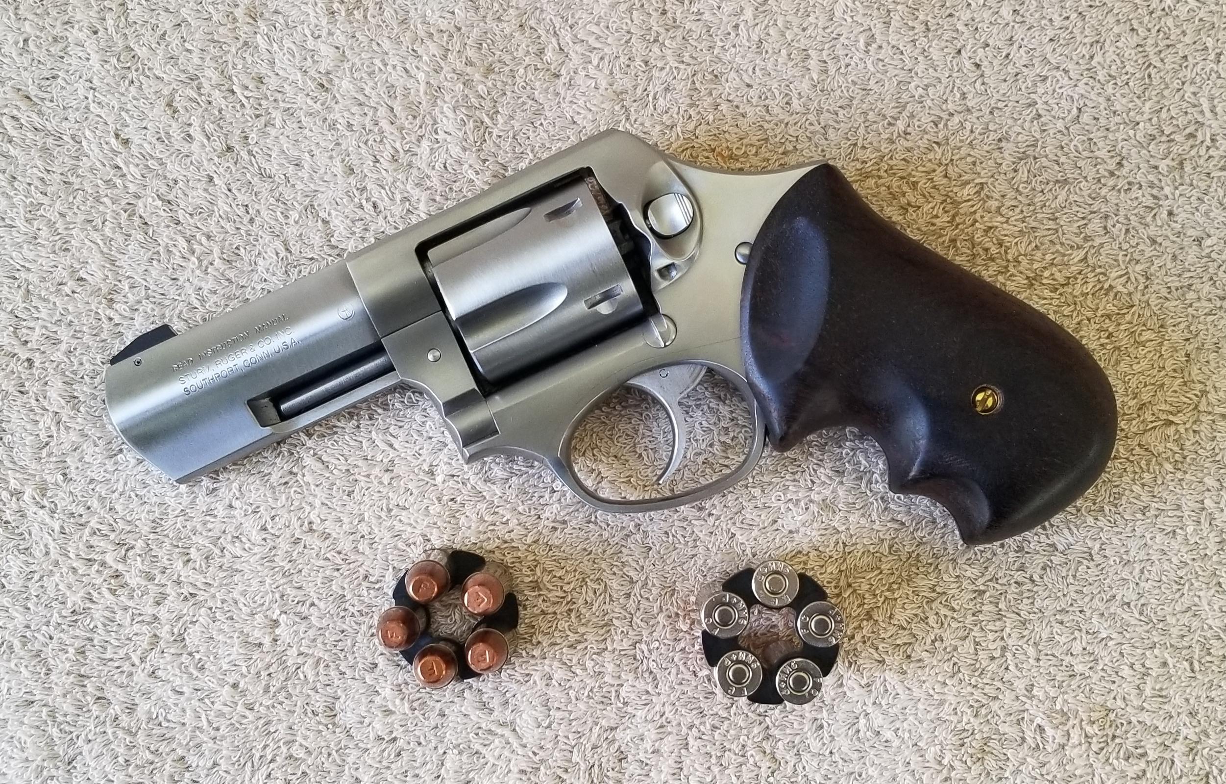

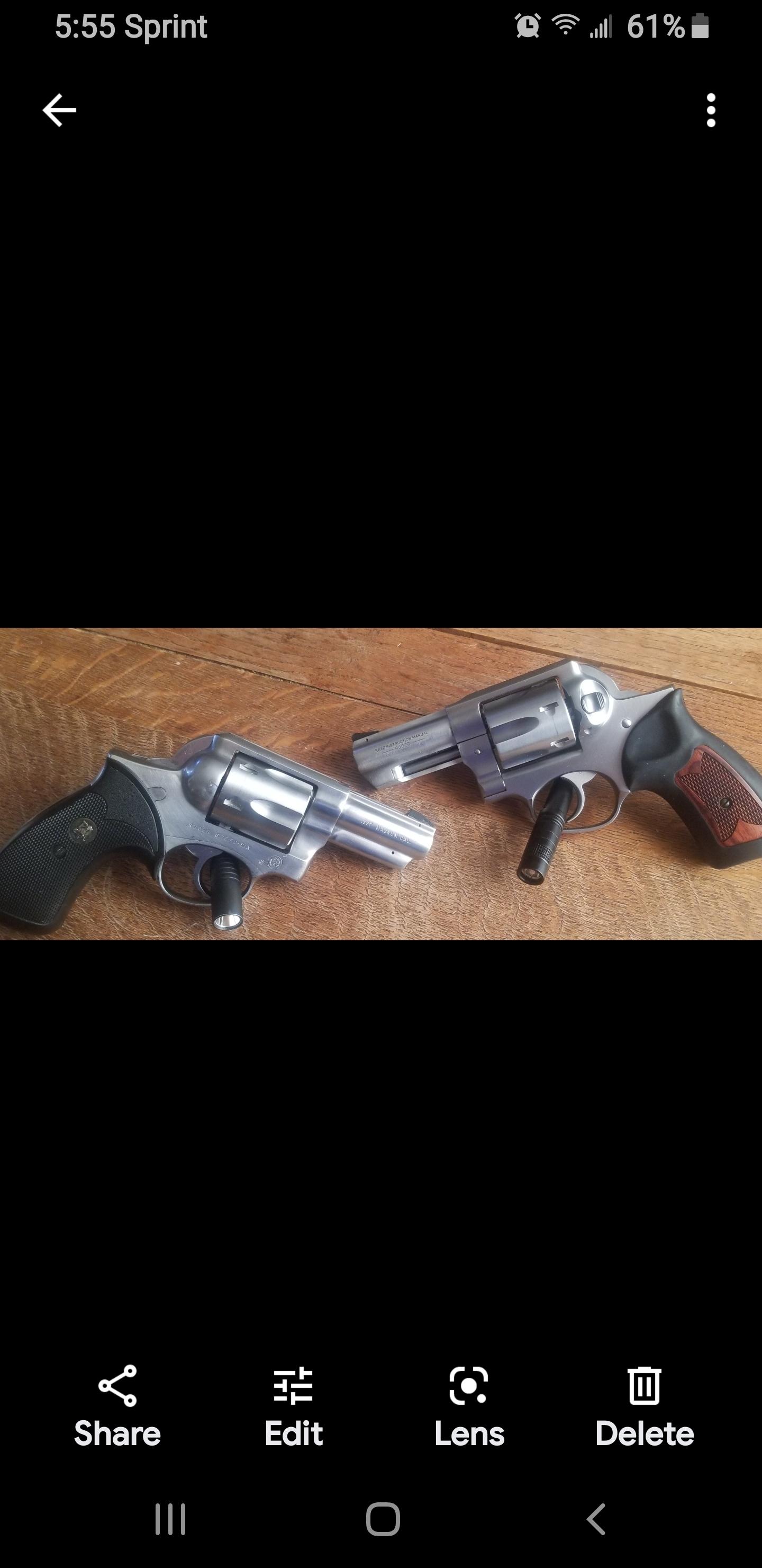

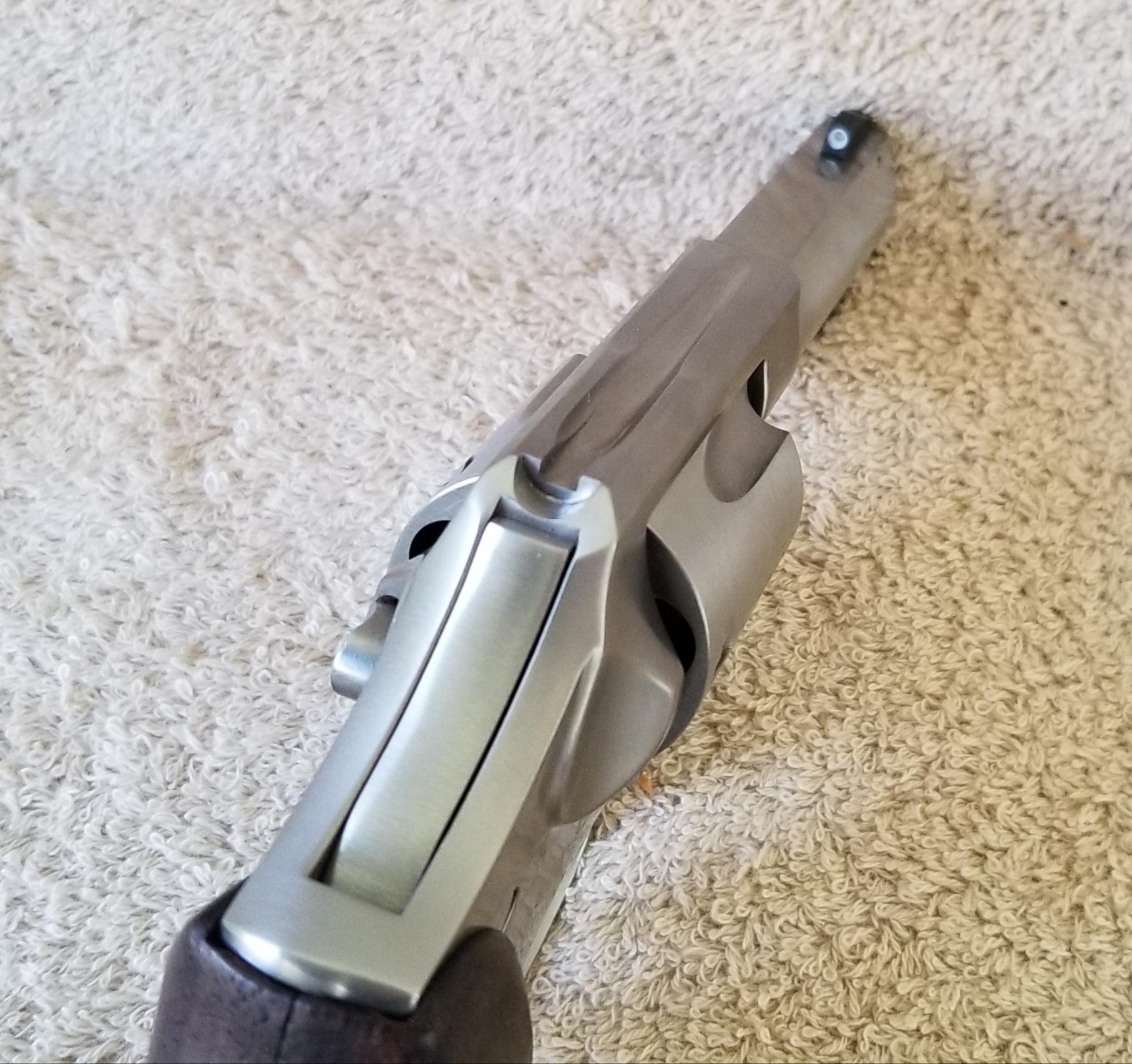

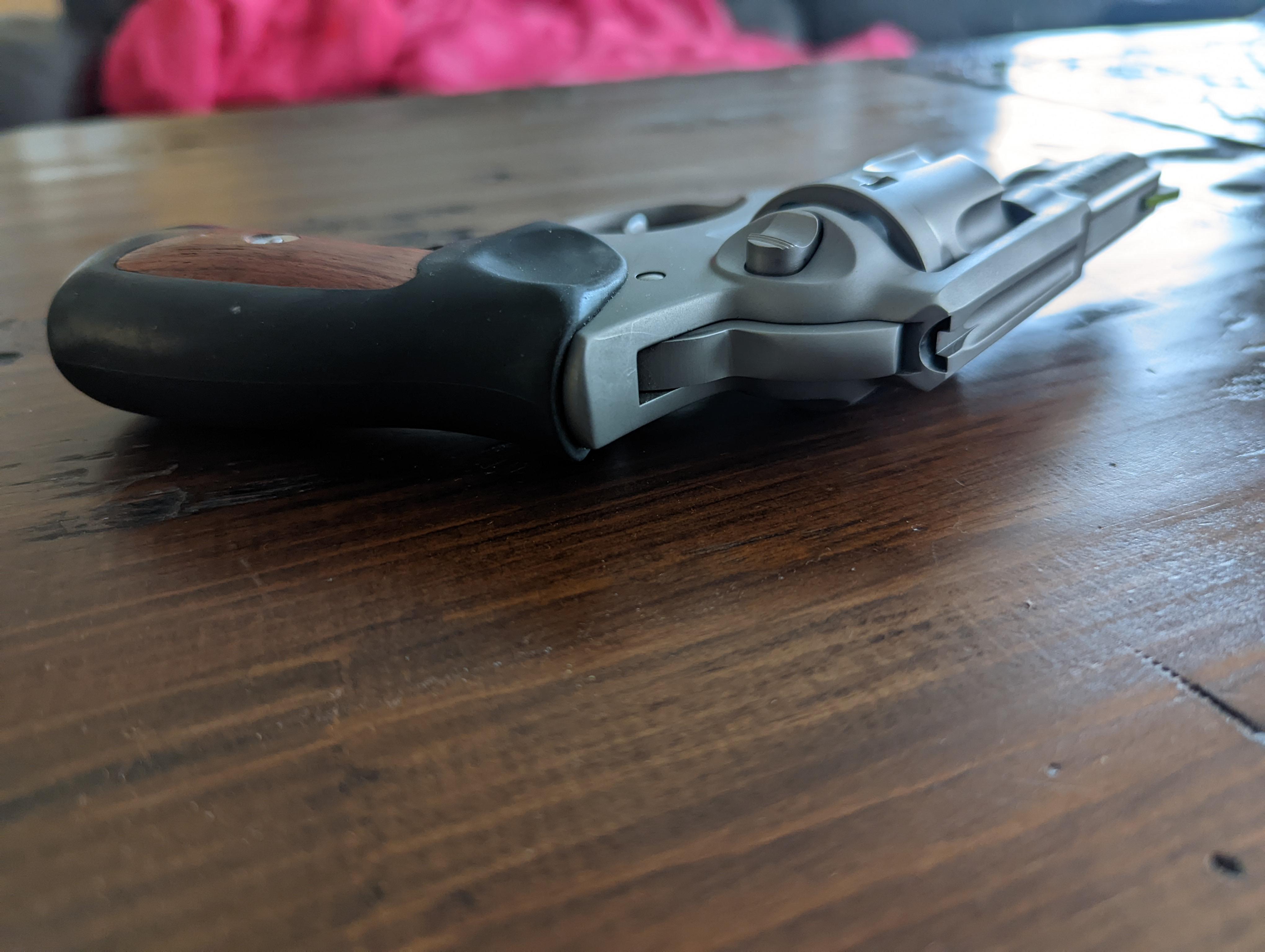

Has anyone bobbed a hammer and had it look nice?
I've done a Speed Six, a 3in GP100 and a Service Six.
Cut with cut off air tool or hacksaw, grinder, file and stone.

I have done several also. Made an outline of what I wanted it to look like with a fine tip black marker then used a Dremel cut off wheel to take the majority off, followed with Dremel sanding drums (large to small, coarse to fine) to finish shaping and then finished with automotive sand paper to smooth everything. Then used the Dremel with the polishing tips to get it to the look I wanted. Even working slowly probably took less than 30 minutes to do.

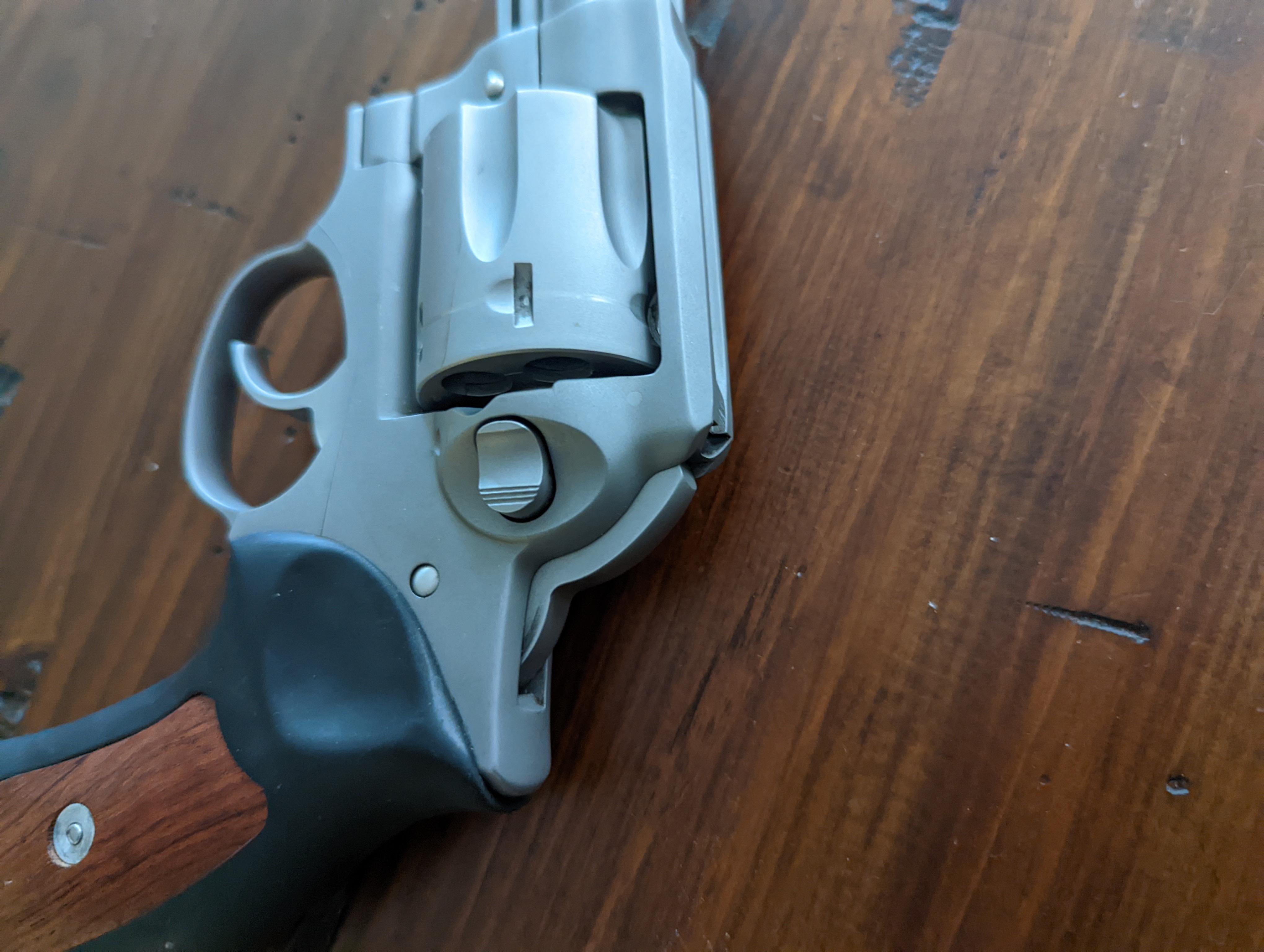

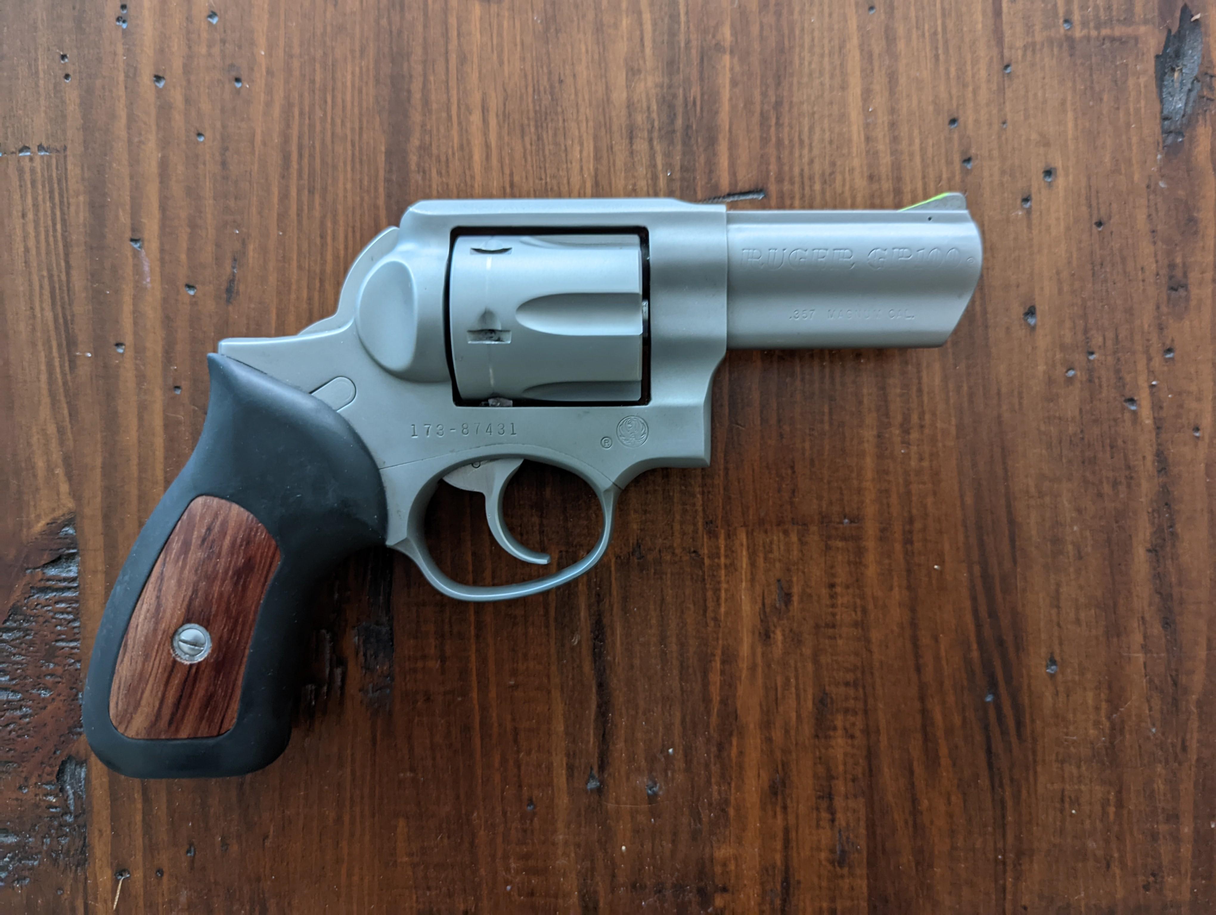

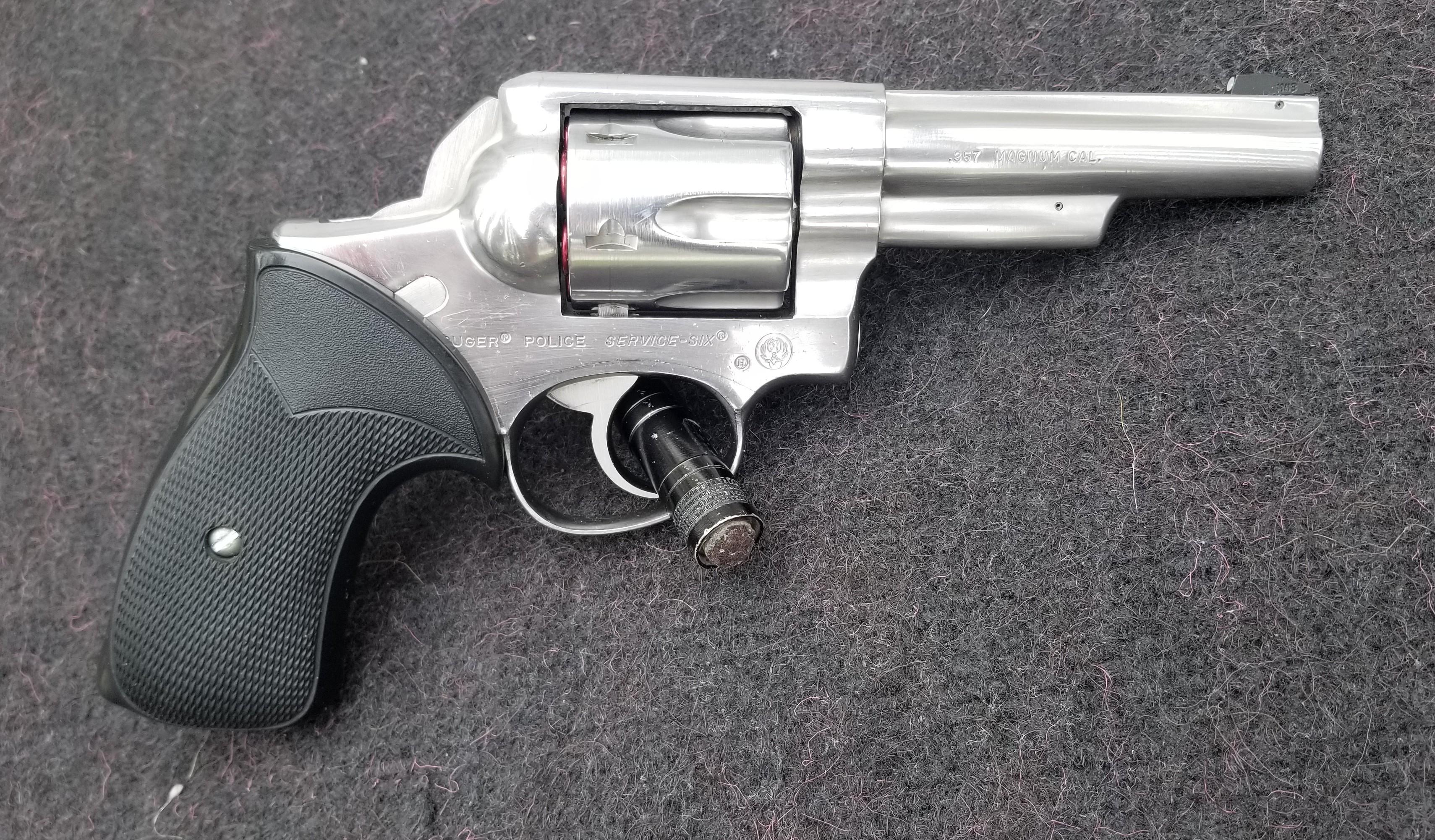

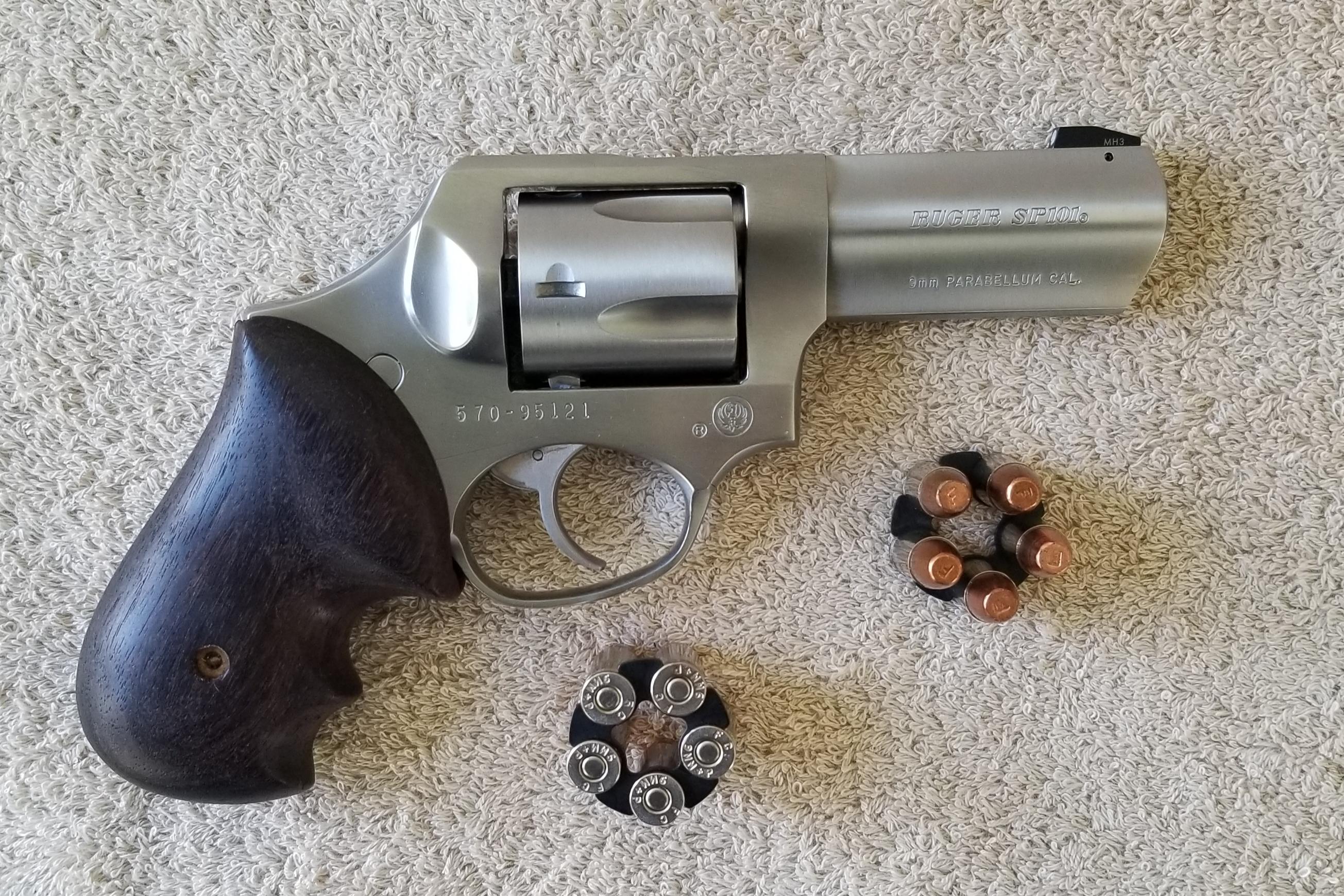

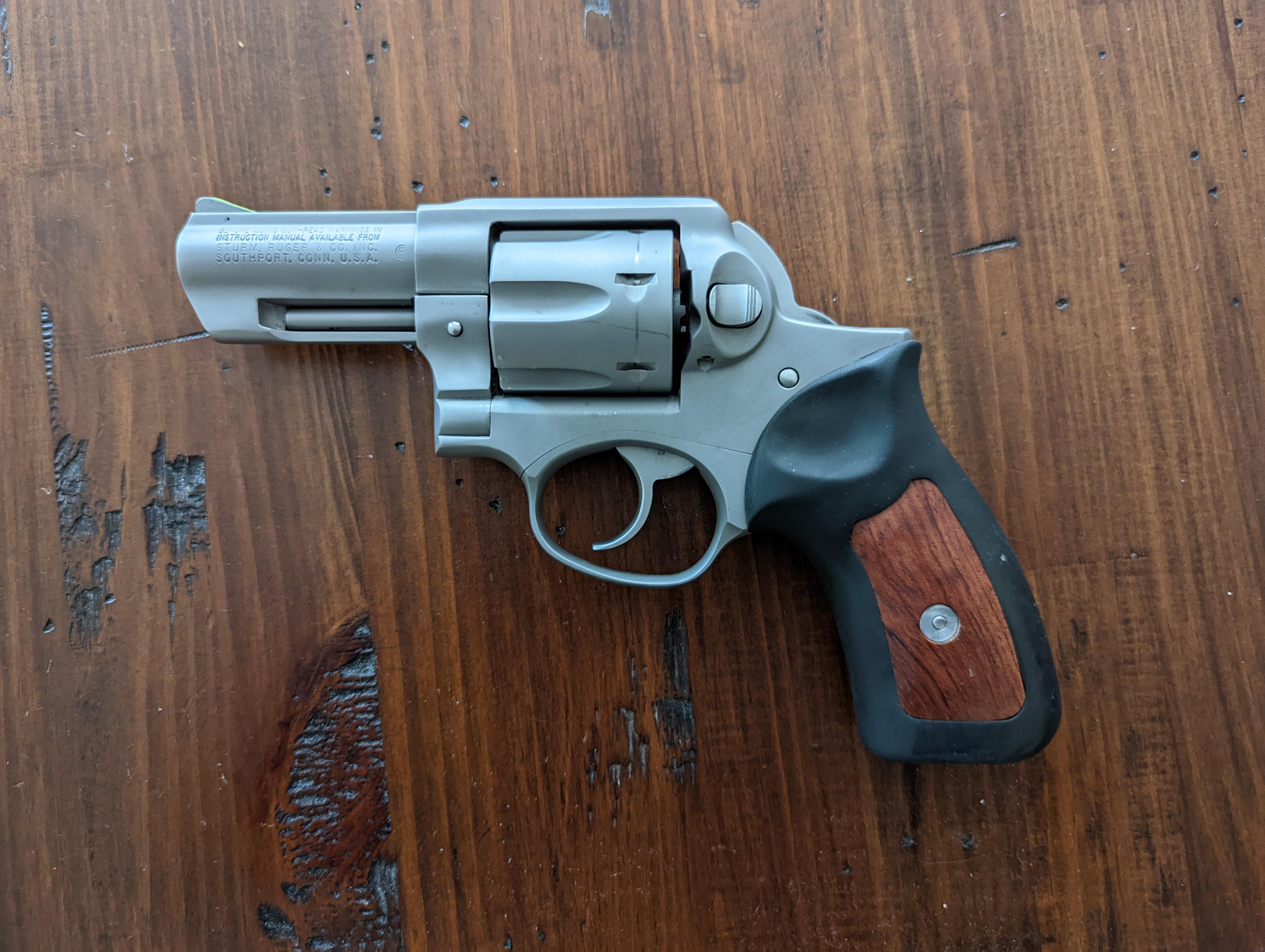

Factory DAO 9mm with 3" barrel and Tritium front sight.

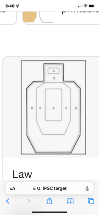

The Taurus. 605 is a small and light revolver with a smooth action after quite a few thousand Dey fires. It works nicely with 110 grain. Stings a bit with 125 and do not think I would try 158 grain.
I was doing some Jeff Cooper exercises (Dozier Drill at 10 m) a few years ago with one of my best friends (now deceased). I found I shot better with .357 than I did .38 Special. I took deliberate aim instead of forcing speed: all upper level A's and no C'abut a bit slower. Friend was an orthopedic surgeon so we aimed at top half of A: sternum and above. We only counted those as real As
