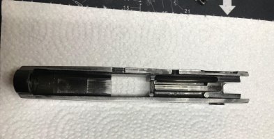

1. Complete dis-assembly of the slide, firing pin and spring.
2. Used a bronze bore brush to thoroughly clean the pin and spring bores
3. Used oil and 2000 grit emery cloth to lightly polish the back end of the pin piston
4. Swap out complete slide and barrel with another of the same model - no change - issue stays with swapped slide/barrel.
5. Shells eject as it should.
Both slide/barrel assemblies dry function as they should when swapped to a different P944 frame.

Been years for me tinkering on these so memory is weak but you don't show the firing pin block etc out of the slide. Did you remove all that?
Also to be sure I get it. You have two frames and two slides. The issue stays with the slide on both frames. right? So that tells you the issue is with the bad slide assembly. I would compare the slide parts side by side the best you can without mixing them.
My gut says look at the pin block first. Good luck and do report back.

Yes that is correct, except for the firing spring block (KV02103) I've completely dis-assembled the slides. The pin block easily pushes down and freely returns, need I go further? I did blast it really good with some Birchwood Casey Gun Scrubber upon the first cleaning and it seems to function as it should. Would it need further dis-assembly?
Yes, I have two of the same gun, one is the stainless version from 1994 and the second is the blued version from 2002. If I swap slide components (firing pin & spring) the issue still occurs.
Thank you!
Here are a couple of photos and a short video of the pin block functioning, hope they help.
Thank you

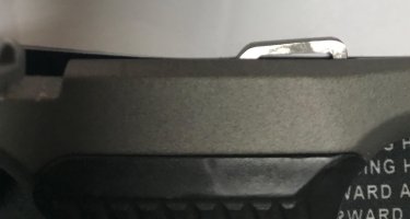

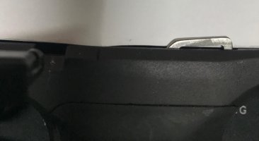

My range buddy is a retired armorer and instructor from a local PD and he thinks it is something in the newer frame. Per the earlier suggestion above, I've disassembled the blued slide and did another clean of the firing pin block in the suspect gun (blued), it functions exactly as it should and as the stainless slide does. The blued slide is what is shown in the video link.
I just performed the pencil test suggested above 6 times on both guns as they are assembled in the photo below. The first pull using the black frame the pencil shot out 24", the second and subsequent 5 pulls it shot out 12". The first pull using the older mint frame with the black slide ejected the pencil 12" with every pull. There was no delay in ejecting the pencil on either gun.
The photo you see below is of both guns but now the blued slide is on the older frame, and the stainless slide on the newer.

Looking at a similar P-series gun that I have, I might compare a couple of parts that are installed in your two frames: the blocker lever (#2) and trigger bar (#42).
Part of the blicker lever (visible with the slide removed) rises up as the trigger is pulled, to lift the firing pin block in the slide. If the tip of the blocker lever is broken/worn/modified, it might not be lifting the firing pin block high enough to completely clear the firing pin.
Part of the trigger bar is visible above the left grip panel, and you can see it move forward as you pull the trigger; it moves within a relief cut in the slide, and when it reaches the forward end of that cut, it is forced downward, which releases the hammer. If the forward, rounded shoulder of that portion of the trigger bar is worn/modified, it might be impeding the release & fall of the hammer.

Here is a shot of both frames with the slides removed and of each of the trigger bars as they protrude from the frame. I'm going to test again tomorrow. I'll see if someone is around to video.
Thank you.
Yes, grips have been removed, both frames appear identical. The only difference I notice is the hammer seems more forward in the suspect (black) frame compared to the stainless.
