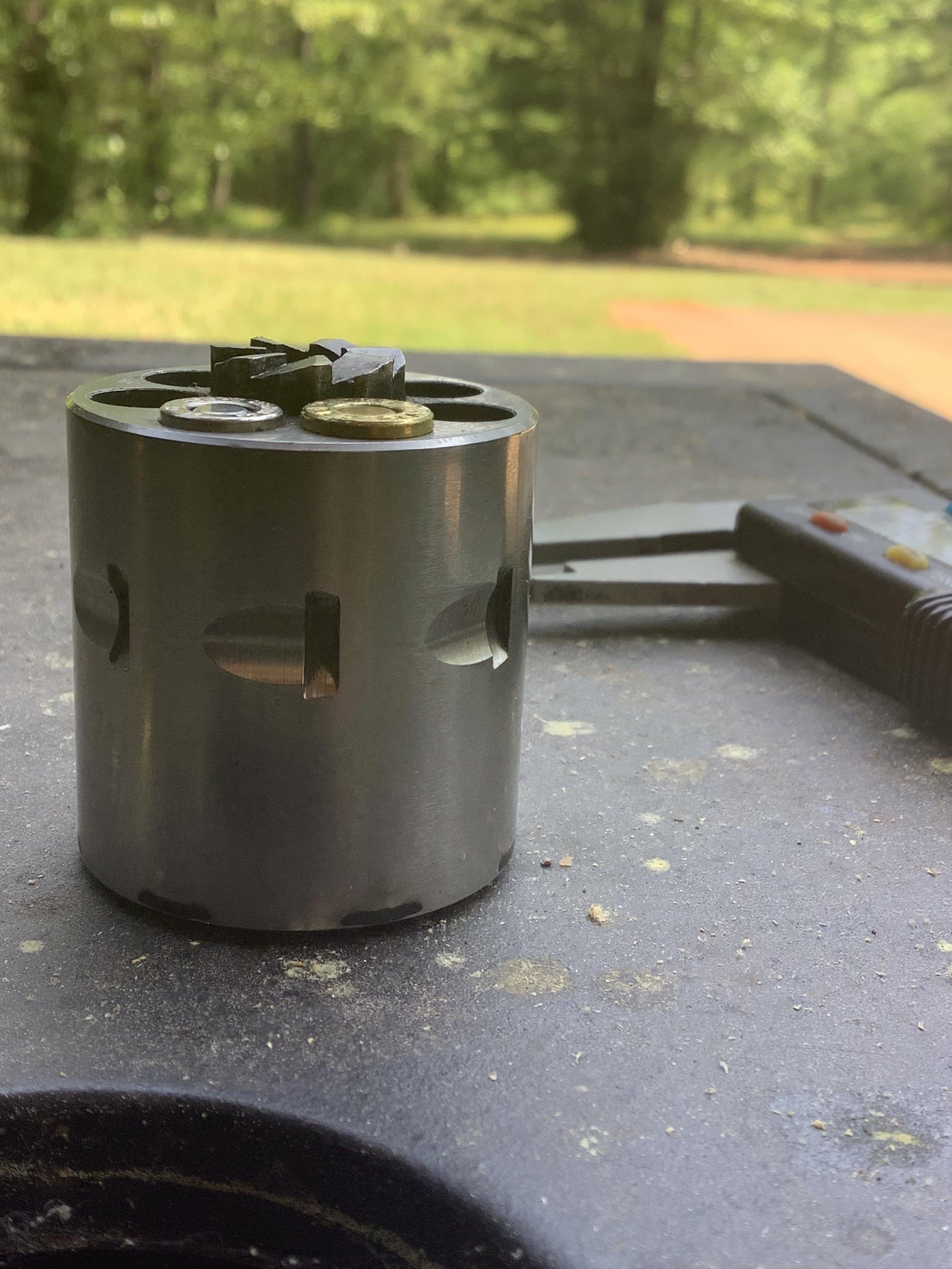

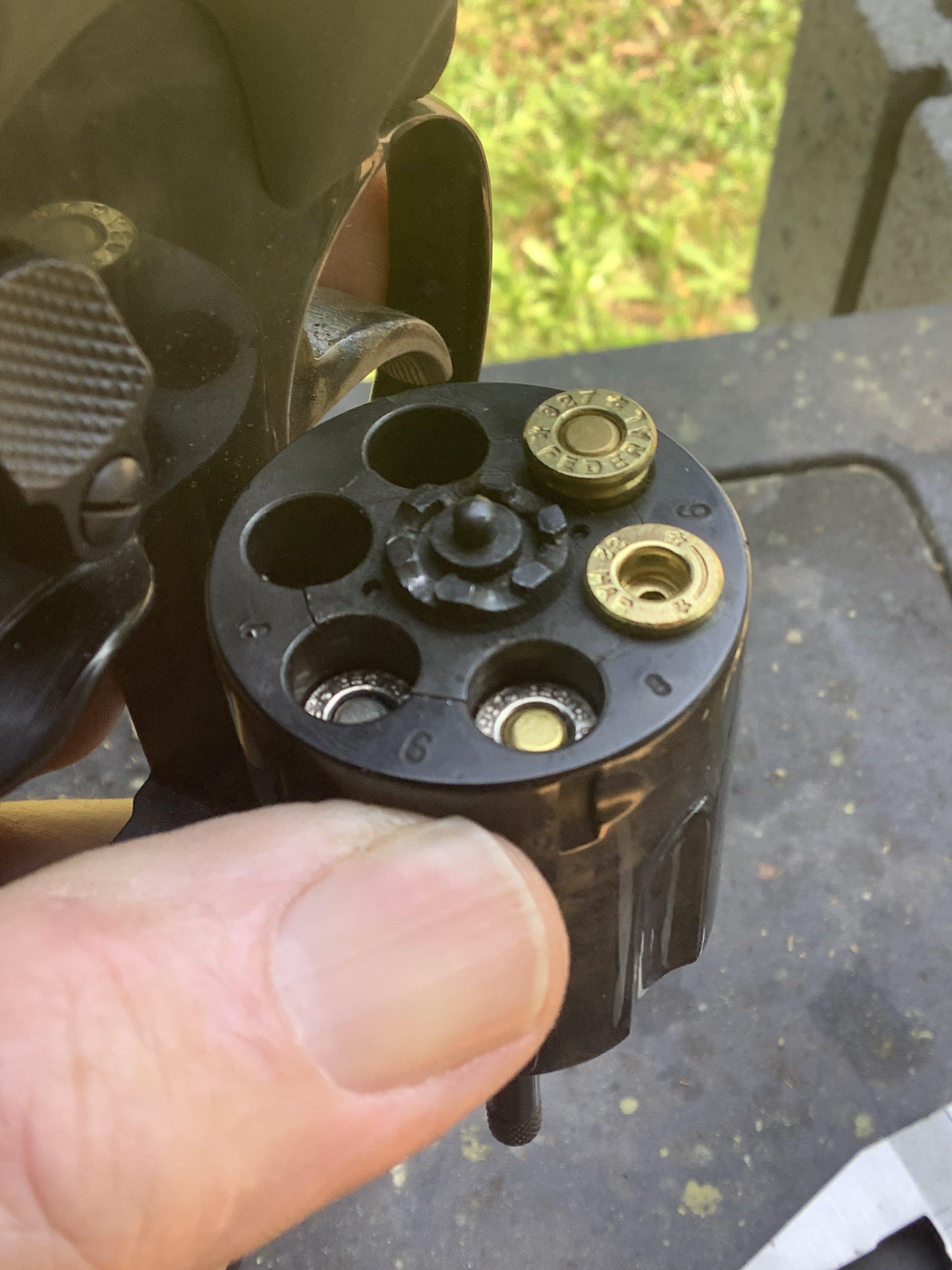

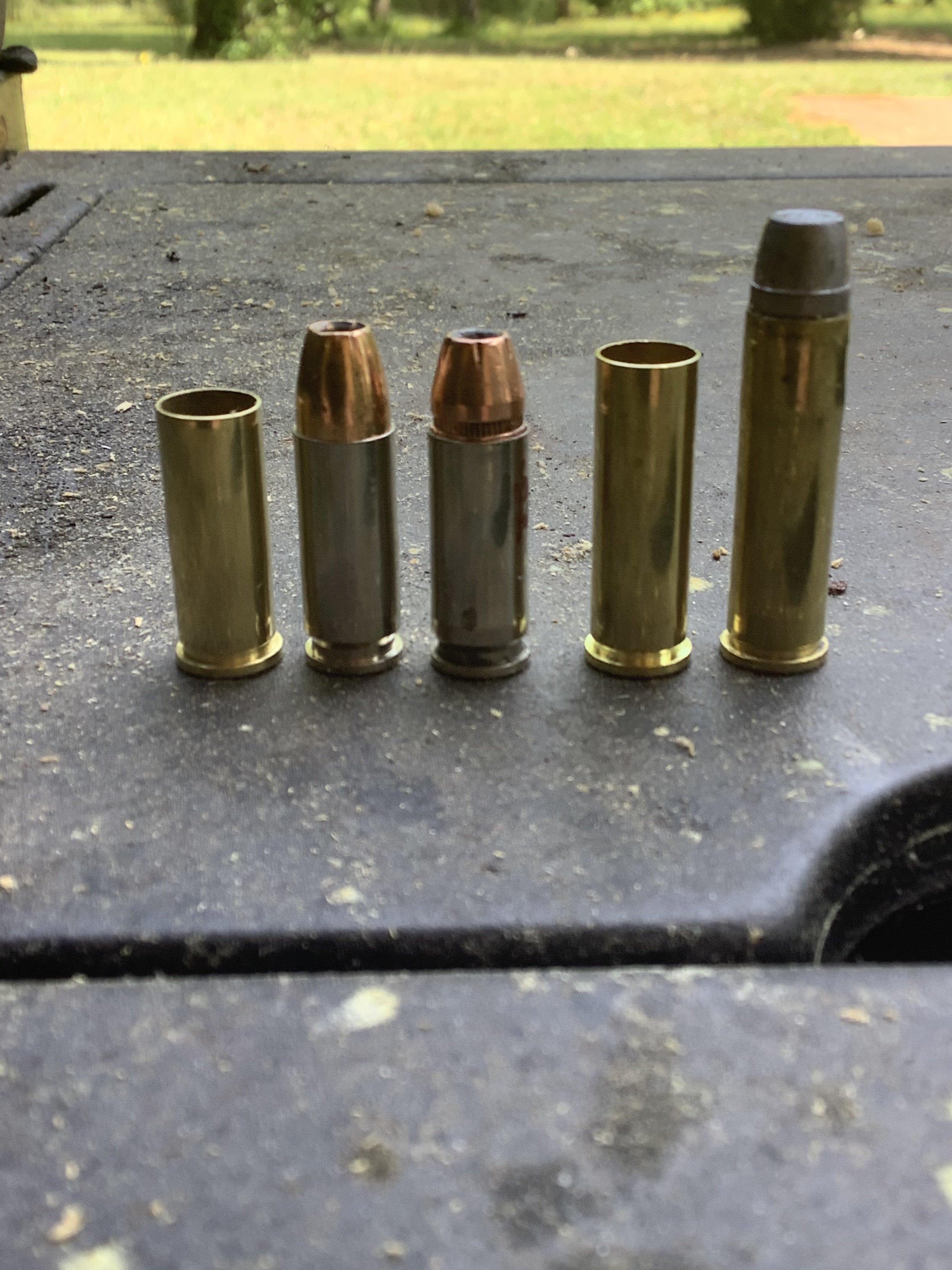

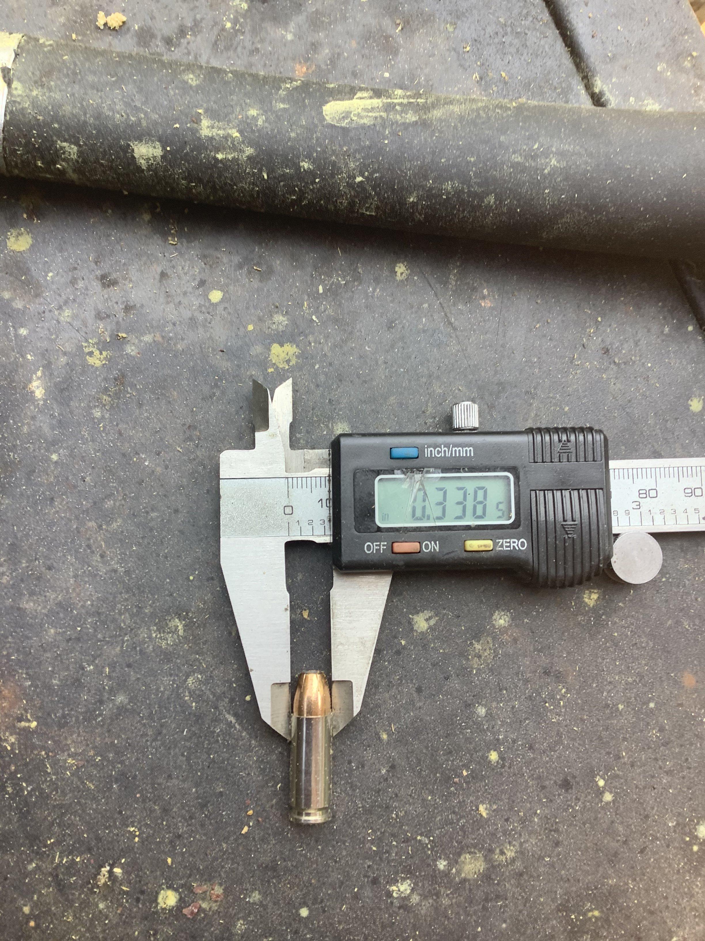

A fired .30SC (from MY .30SC) WILL NOT even fit into the cylinder of my Ruger Single-7. However, a factory loaded Federal .30SC will hang on the rim of the S-7 chamber. The rim however is only 0.0025" larger than the case ahead of the extractor groove.
A FIRED .30SC case will drop into cylinder of my Taurus M76 in .32H&H until it is arrested by the throat.
The loaded Federal.30SC is larger at the case mouth than ahead of the extractor groove because of the seated bullet.
My OBSERVATIONS of MY pistol and MY ammo. YRMV.
