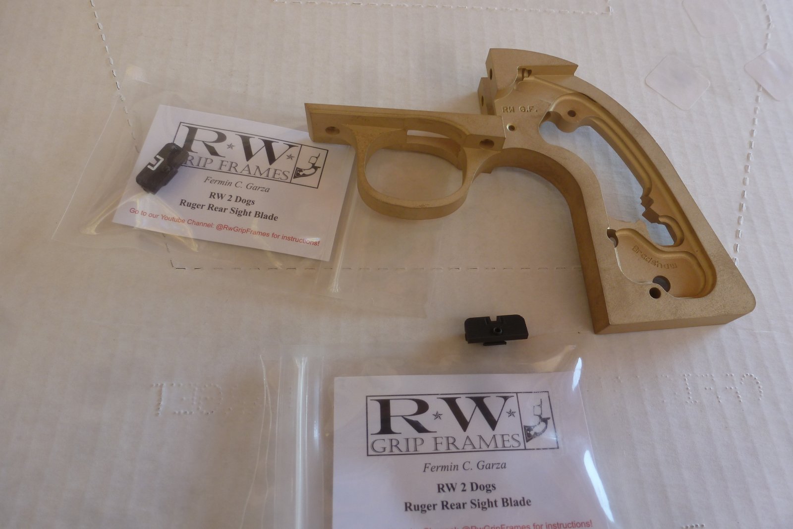

And since you mentioned accurate target shooting,, you need to swap out the front sight & add a special rear insert. Check out Fermin Garza's front sights, and the "Garza/Wells" rear inserts on RW Grip frames site.
Look closely at the RW/Garza rear insert.
You remove just the factory blade,, and add the new insert. The sight picture is much better, as they have several options. I handgun hunt with my .357 Maxi using these sights. Open sights and easily took a deer at 55 yds with them.
You still have the Ruger base & adjustment assy. All you replace is the insert.
Look at the post recently about the .357 Maxi. And I have a picture of a deer. If you can blow up the picture,, you can see the sights.
I found a picture of a pair of different rear inserts along with a g/f by Ronnie. The insert actually goes into the slot, AND comes over the top of the base. The angle, and the anti-reflecting cuts help a lot.
