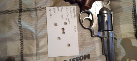

Starline 38sp brass, MP 359-640 with penta hp pins cast from 20:1 and crimped in the top groove, powdercoated, CCI 550, 12.1gr 4227. Pressure is in the 38/44 class or heavy +p. @22,000 psi so use with caution.
Same load with the Keith bullet from MP 358429 mold is just as accurate, but under 20,000psi for +p.
View attachment 6439815 yards
50 yards. The Service Six does just fine with fixed sights using the right loads.
