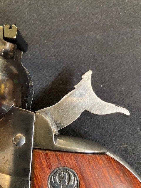

On the left is the stainless hammer I put on just long enough to get some msmts with a feeler gauge, maybe 20 times cocked. It had no scratches when I got it. On the right is my original hammer, see my first post for how it looked. This is how it looked after working it down with 1000 grit sand paper, installing it, and cocking it 100 + times. still a bit to be done, but MUCH better. When I get it right, I will sand the stainless, install it, get some new msmts. Shims are due in tomorrow. I will wait to shim it until I make a decision on the finish.

Way better.
Thanks, man. I can deal with good honest use wear on a revolver, or hell, any firearm for that matter. Holster wear, bench dings, limb brushes. I can't deal with preventable wear/damage. This revolver should never have left Ruger with this kinda damage in a few cockings. I may be a little harsh, maybe things loosened up during use. As I am not the original buyer, hard to say. But a little bit of filing shows a mountain of chatter in the hammer channel. A few minutes of TLC after milling would have taken care of this.
