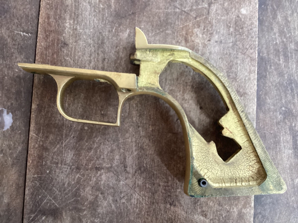

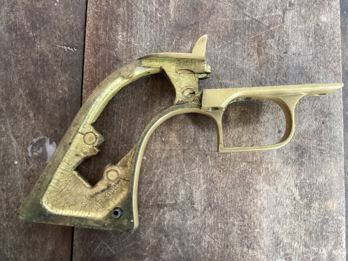

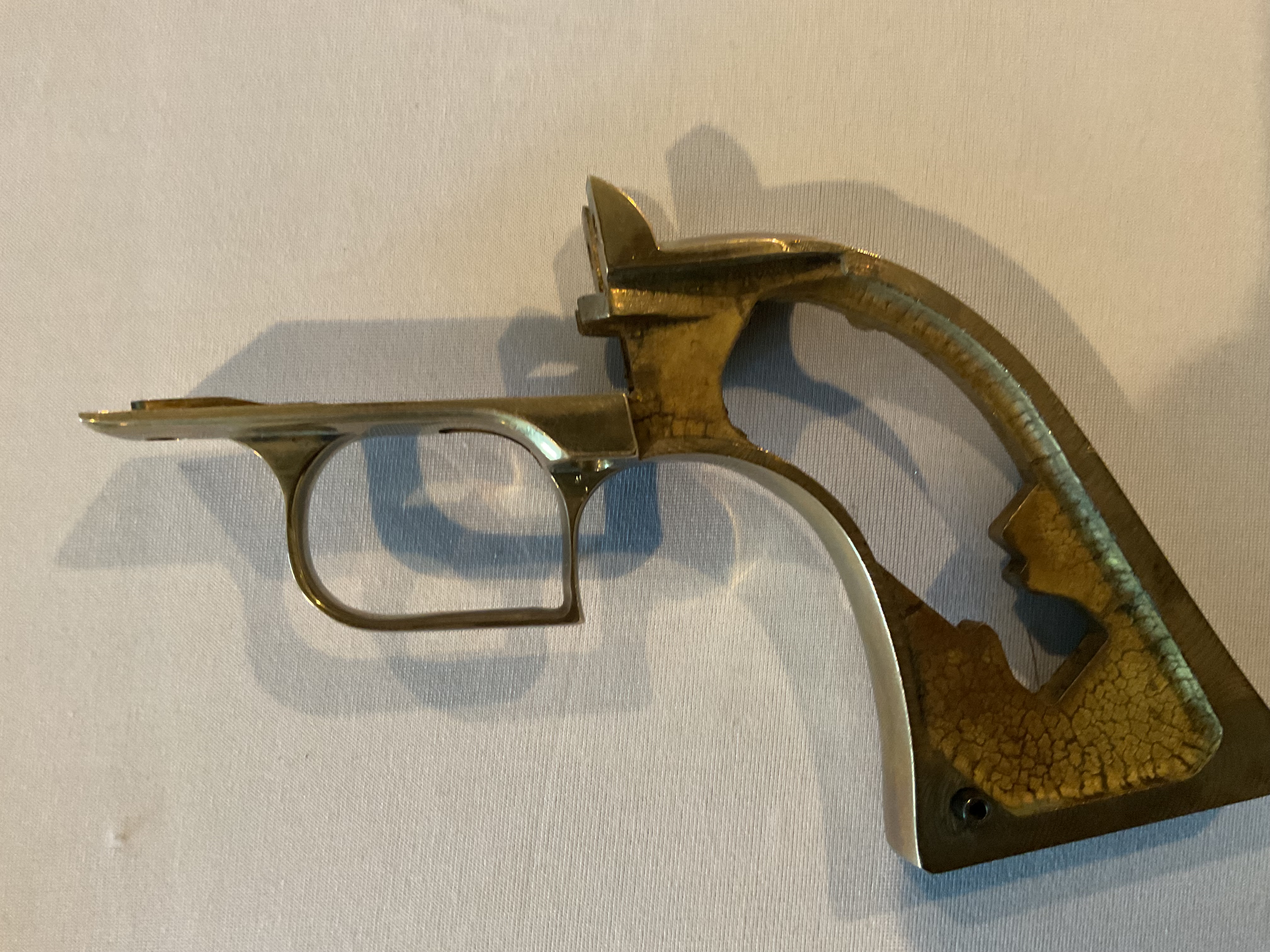

IMO the deal was,,, the NM frame @$150. The OM @$325 is right in there. Keep in mind the Factory OM frames have porosity, some not so bad, but most all of them have it. This used to really bug me, but now I kinda think of it as part of the patina.

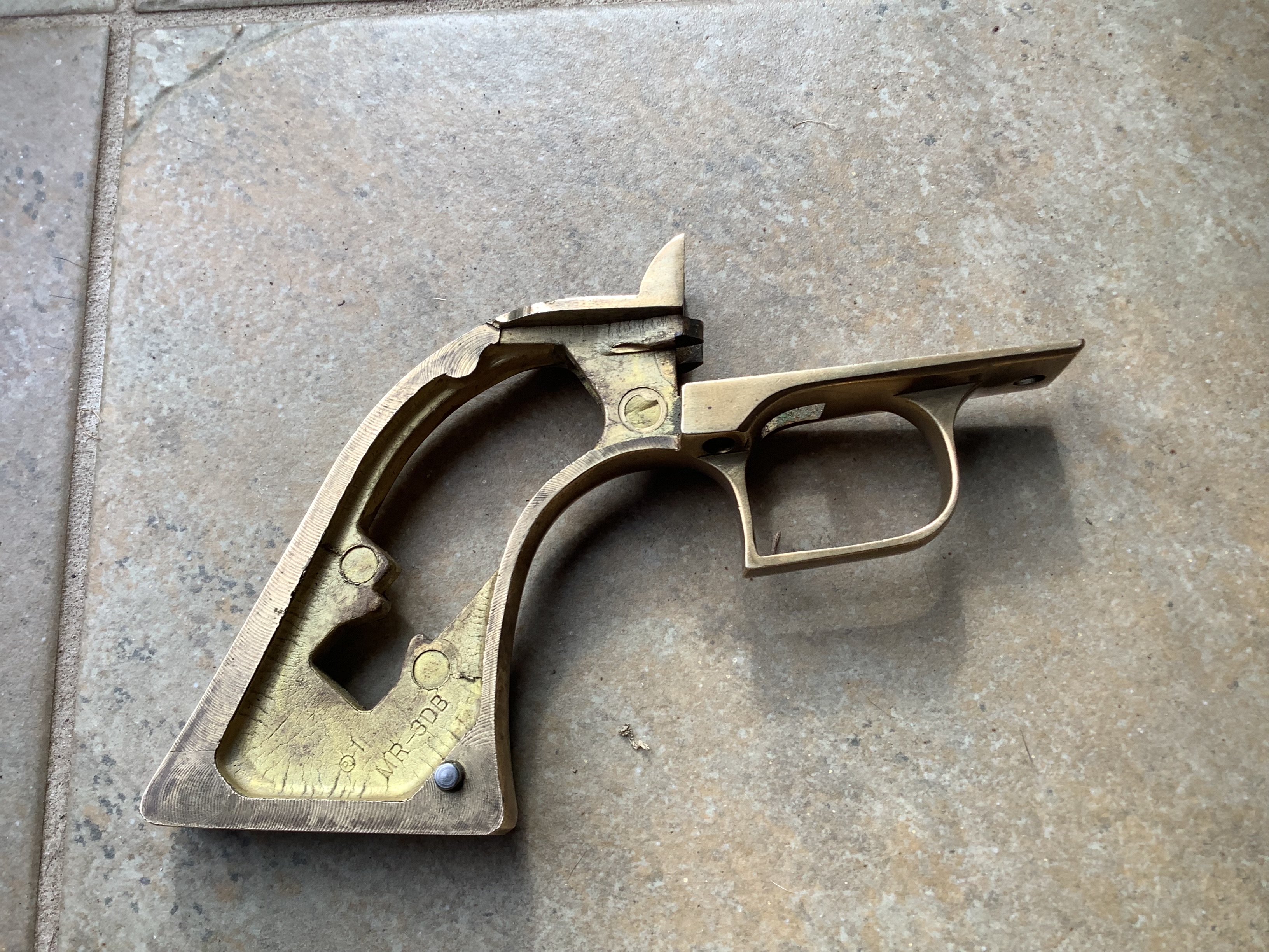

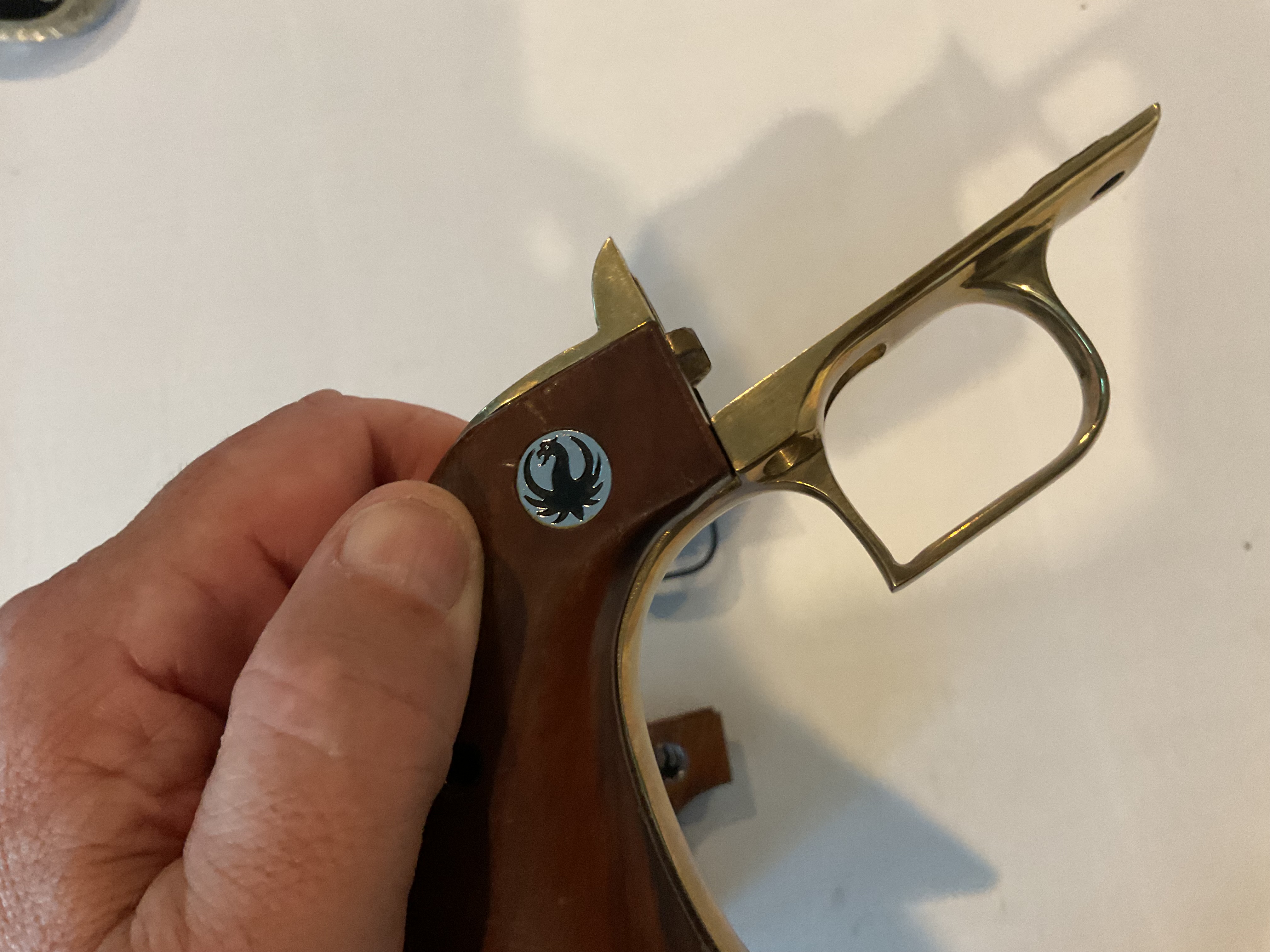

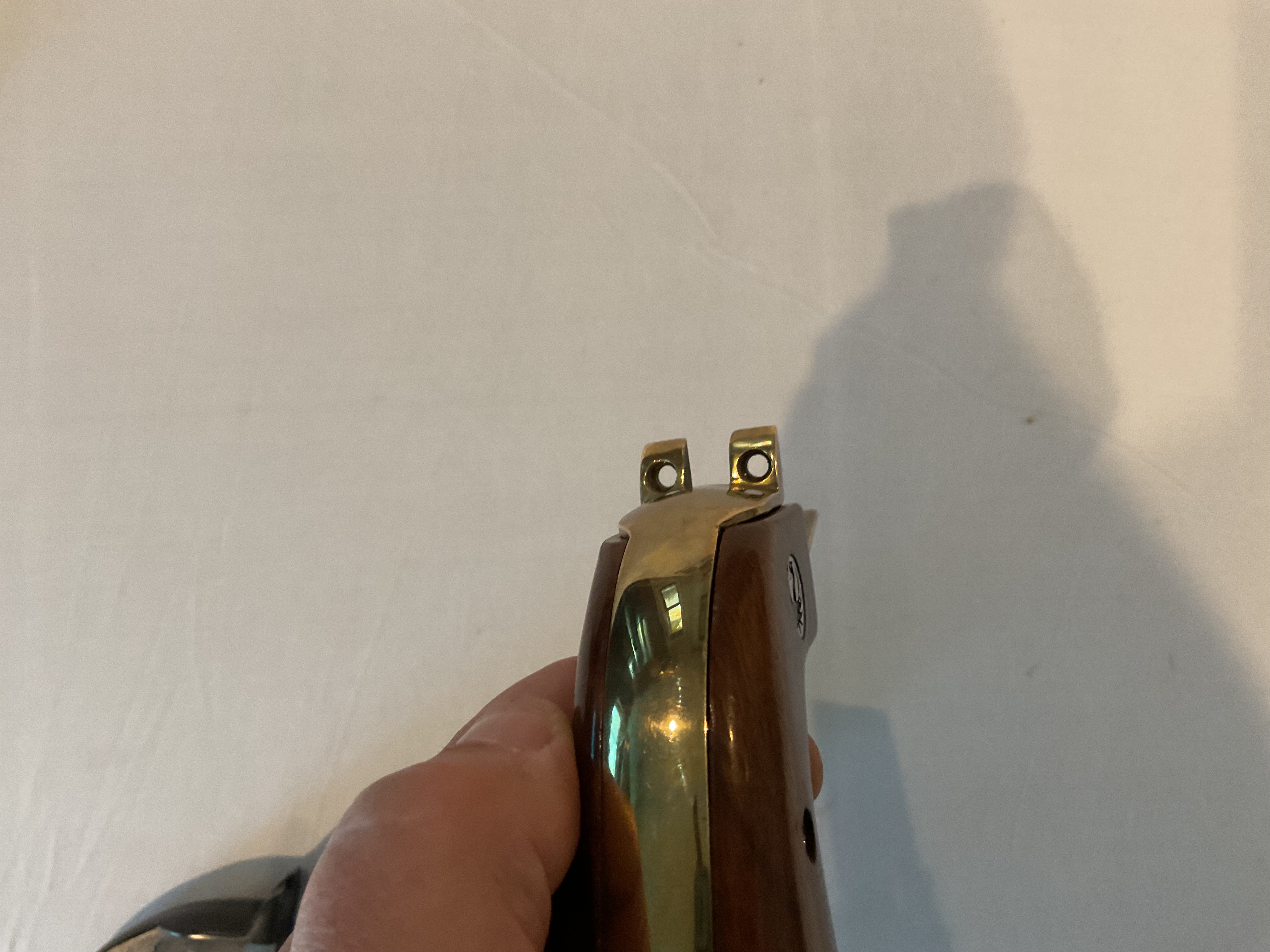

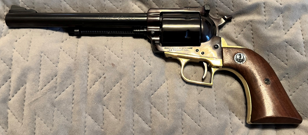

This picture is a NM Frame, on a 30 carbine. While they are nice castings, they take some patience & massage to get them to fit.
Same frame as purchased, before fitting/finishing.

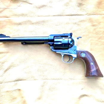

This gun is a 50th 44 flattop (2006) it came with a steel XR3, way too small for me with 44 magnum.
Changed out for a RW/ Hunter,,, Same Size as the Super Blackhawk, BUT has the rounded trigger guard. I went with this because the Dragoon trigger guard likes to smack you knuckle, especially in 44 magnum.
RW Gripframes are by far the easiest to fit & finish, very accurate part. More money but well worth it. Buy once, cry once.

Ruger only made the a few thousand MR3-DB Brass Grip Frames (Old Model) in the early 1970's.
Some were installed on the OM SBH & Blackhawks in various calibers,
MOST, went on the Old Army's, and that was to clean out the inventory.
Some were sold as an accessory kit (frame & wide SBH trigger) so that one could "Brass Frame" their gun.
A lot were scrapped, mostly because of porosity.
