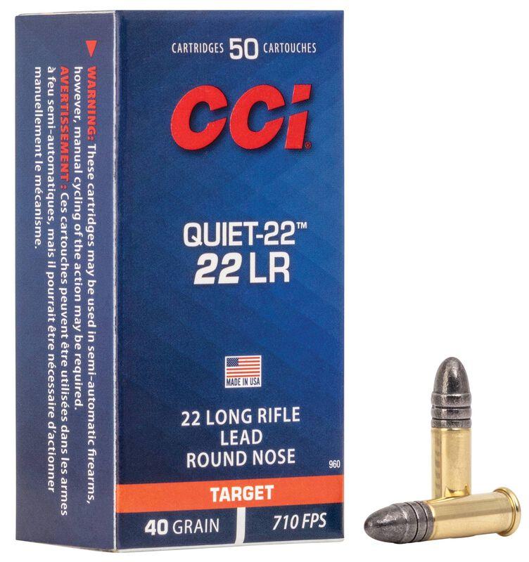

Rem subsonic 1050 FPS works 100% limited tested.
CCI clean 1070 FPS works 100% limited testing.
CCI Quiet 710 FPS would not cycle the action.
Limited testing on my part was about 100 rounds of each in each rifle.
The quiet failed badly, not sure it worked at all.
The KIDD recoil spring package is not expensive and might have allowed the Quiet to cycle the action. As said the cycling of the action is still heard even with bolt buffers. But the actual muzzle sound is really quiet. With HV .22lr ammo is not loud but also not really quiet. If you want quiet use subsonic ammo.

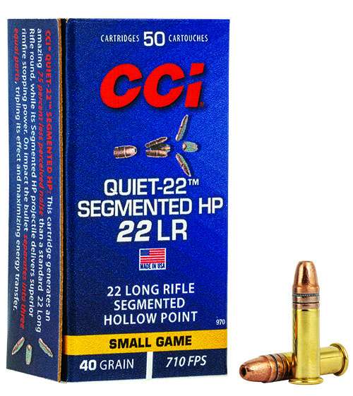

I am no help on your suppressed question.
But. I have used these cci quiet both sold and segmented to take out raccoons, gophers and foxes within about 25 yards. Had to hand cycle my 10-22. Feed perfectly in the rotary mag. They shoot about 2" lower than mini mags at that distance. VERY QUIET
Be aware that CCI also sells a "Quiet" load specifically designed to function semiautomatic firearms.

Looks to me like CCI subsonic offerings are at minimum 2x the current cost of the Aguila SV I use. I don't believe I would kill twice as many pests or use half as much ammo if I switched. I am intrigued by their QuickShok/segmented HP offering and have some to try, but didn't have an opportunity last season. That seems to me to be a possibly worthwhile added cost if it functions as advertised.
The original QUIET ammo was very feeble. I used it for a couple years in a 5.5" 22/45 and found it occasionally failed to penetrate the skull of big, old boar coons. It made the 22/45 basically a manually operated mag fed pistol. Very safe for use but the dismal terminal performance was unacceptable. Additionally, it wasn't accurate enough in my pistol to give me the results I needed. Switching to sub-sonic HP solved these problems. This year I used a folding stock 10-22 with integral suppressor and found it was a good match for my needs. Much better accuracy, better range capability for general use, and almost as handy as a suppressed pistol.
