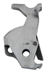

I found a spare hammer for my SP101 and removed the hammer spur. Now I would like to remove the SA notch on my hammer. There is a tiny notch at the bottom of the hammer. Is that the SA notch? See pics. SP101 hammer.jpg SP101 notch.jpg

ammo dave, if you really want to make it a DAO hammer then do this: Look at the the extreme toe of the hammer, just above the SA notch. You want to keep it as long as possible. Take a fine file and gently file on the top of the notch and the bottom of the notch at the same time. You want to remove the "V" (or "L") shape, as view from the side but try to stay away from the front/top of the toe. Get it smoothed out so that the triggers single action sear won't catch on it. Once the trigger sear can't catch it and hold the hammer back, you're done. The way I would do it is to fill that notch by welding it (TIG) and then cleaning it up so that portion of the hammer is nice and smooth and the toe of the hammer has not been shortened. If the toe is shortened too much, it may not engage the trigger sear correctly and that could cause problems with the hammer releasing early and you could get misfires due to a shorter hammer travel. Plus if the hammer doesn't go back far enough the transfer bar may not go up far enough for the hammer face to hit it.
Ronin, I carefully removed the tiny notch on the forward face of the toe but I still get single action engagement. Do I need to remove material at the bottom of the toe? Where my arrow points...

Compare with the pictures I sent. You might have to work on the contour at the toe area.
For others on the forum, here is what a SP101 Factory DAO hammer looks like.
This is a SP101 SA/DA hammer (notice the little notch at the front up near the top of the toe) :
Polished the bottom of the toe and my single action is gone. My SP101 is now DAO. Tested my work with a handful of primed cases, no ignition problems. I previously did a Mcarbo trigger job and I have a measured 7.5Lbs trigger pull. Thanks for the help.
