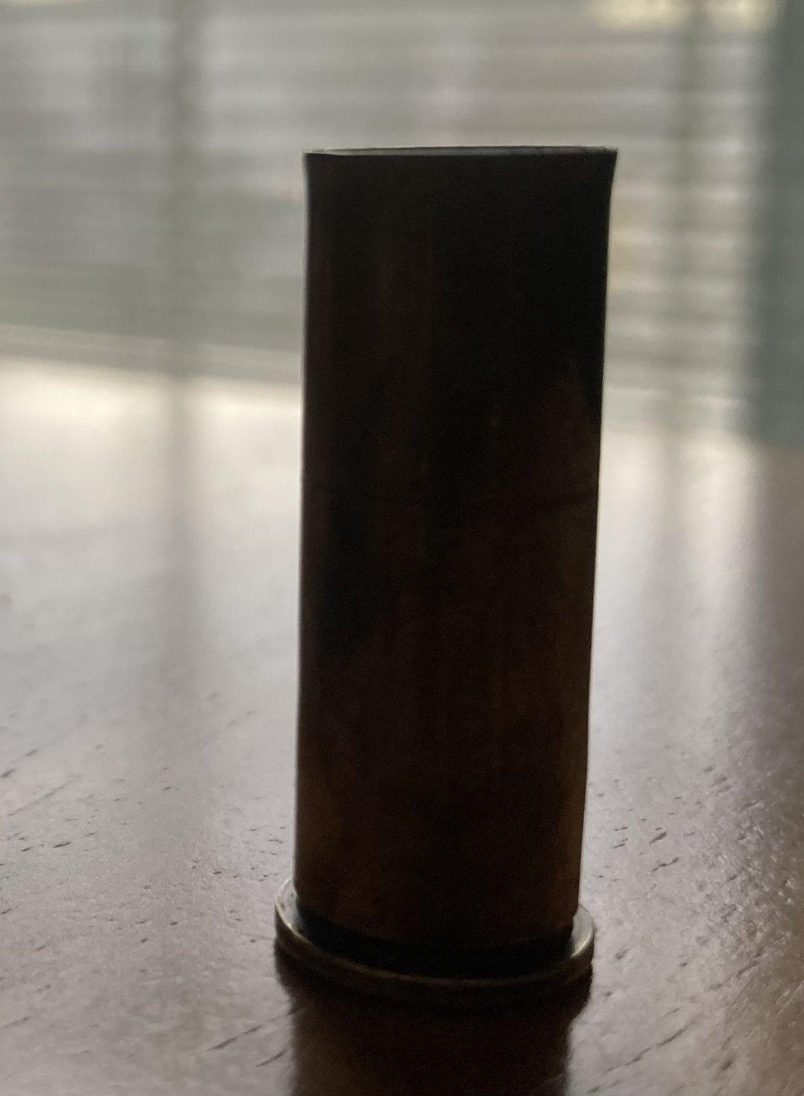

Right now I have crinkled cases seating bullets..... UHG ! Wondering if PMC brass get hardened pretty fast, and considering it can't be annealed. I just bought Starline brass last week, are they better ? Not hardened as fast ?
I just noticed seating the bullets, if seating too fast, crinkles the case, but if slow, gradually, it gives the bullet time to sit straight. Think I figured that out. Had a few XTP bullets HP close up quite a bit ! Thought the step on the expander was enough, no.

On the ammo. .44 mag cases aren't known to be easily wrinkled unless the dies aren't set right or even made out of spec. No matter the maker. All brass can be annealed,, but I don't think that would fix things. I anneal bottle neck cases & my 2 annealers could easily do .44 mag cases. I don't think the manufacturing process is the issue.
I would try to reset the neck expander to where the necks get opened enough to allow a bullet to start in them. Or,, if you have a neck chamfering tool,, break the inside edge of the brass to allow a smoother transition. If it were me,, I'd start with the expander first,, and then try & add a chamfer next.

The expander die has a RCBS cowboy plug. Surprisingly it has a step that works well. I thought letting the cases sit too long caused them to buckle. Even with the step on the expander doesn't allow the bullets to sit straight enough. I have to seat them slowly, gradually, until they reach to be crimped, no case buckle.

I'm also using .431 oversized bullets. The cowboy expander is .430 and the plug is .428. The step is like .002 over the plug. In the end the tension is .003. I never had an issue with cases collapsing before, when I used just a bell expander either, but a standard expander is undersized for the bullets I'm using. I have an odd expander that is .423 (44 mag stamped) and slips in a case that's sized with a carbide FL die. What diameter should a standard expander be ? I heard of tighter tension than .003 like .005, but only can contribute the case collapsing with a bullet being crooked slightly to seat, that's why I gradually seat it to straighten it out before driving it home. Your bell really don't help in my eyes to prevent the bullet from being seated straight to prevent crinkling. There's a sizing issue here somewhere. IDK where.

Part of your issue may well be the oversized bullets (the .431's) And the cowboy step expander should be used for lead bullets.
Another thought,, based upon your comment; "can contribute the case collapsing with a bullet being crooked slightly to seat, that's why I gradually seat it to straighten it out before driving it home."
If you are using a proper bullet seating plug that fits the nose profile,, you should get good bullet alignment to where it'll straighten out things & let the bullet seat evenly.

The XTP's aren't quite RN'ed, they are the ones collapsing the case. Roger that. The Roze RNFN don't give me a problem with the stem I have. Maybe I could get the right stem. I was considering a seater for each bullet. Doubtful Hornady .430 will end production but the .431 Roze may.

"The XTP's aren't quite RN'ed, they are the ones collapsing the case. Roger that. The Roze RNFN don't give me a problem with the stem I have. Maybe I could get the right stem."
You may have uncovered the problem. Bullet seating stem.
Years ago,, I've been known to send a stem back to RCBS with a bullet as an example to get them to re-cut the internal profile to allow the bullet to be properly supported as it's being seated.
Nowadays,, if I need to do that,, I have been known to use JB Weld & make my own re-profiled nose seating stem. Others have used hot glue, or other stuff to make a modification.

I can ask RCBS for another standard stem and modify, thank you
Got one coming and a press die bushing.
