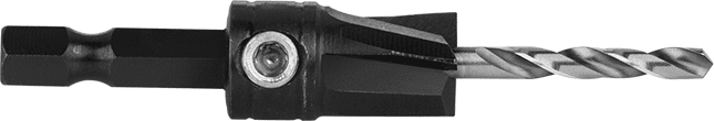

I use a counter bore with drill, but I don't have the size with me for the medallions. Something like this:

Ok, as I mentioned,, Cary V recommended the following tool for medallions when he was making grips.
From McMaster-Carr
"Changeable Counterbore pilot 1/8" shank diameter, 5/32" Pilot diameter."
"High Speed Steel changeable Pilot Counterbore 1/2" body Diameter 1/4" Shank diameter,
2-13/16" Overall."

The bit I show above has a removable pilot to assure a center cut of the right diameter for the medallion stud. And if you are going to use a pair of pieces,, before any contouring of anything,, I cut a hole 1/2 the size of my pilot hole on both pieces at once. That way,, when I do get the grip shape close to what I desire,, I can use the bit shown & pilot guide in the first hole as a way to assure an identical placement on both panels.

The bit & pilot set I showed above is not called a Forstner by McMaster-Carr. The interesting part is the way it uses a removable pilot to assure a correct hole diameter for whatever purpose you seek. In the case of this cutter,, you match the pilot with the stud size, and the cutter diameter to your purposes.
I like precision tools,, and the one I have is just that. And if it was good enough for Cary to make his STUNNING grips,, (that have become desirable to many) I figured it'd be the best tool to use for me.
I've cut several medallion holes & have never had any problems.
