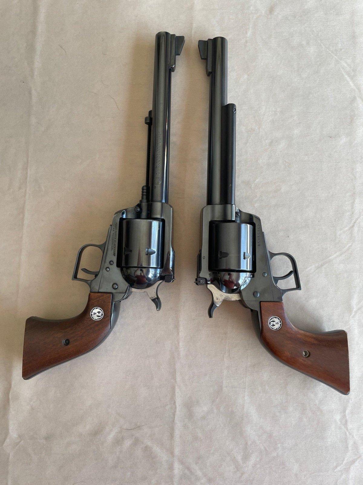

Picked up my new to me SBH
Hylander
May 1, 2008
485
California
Just thought I would post my SBH.
Almost everything is perfect.
Good timing, tight lockup, .005 BC gap, barrel clocked correct.
Only had to open one cylinder mouth a touch for all to be the same at .432 and the trigger lightened a bit.
Shot good, but leaded up just past the frame.
Looks like I need to lapp some thread choke out.
