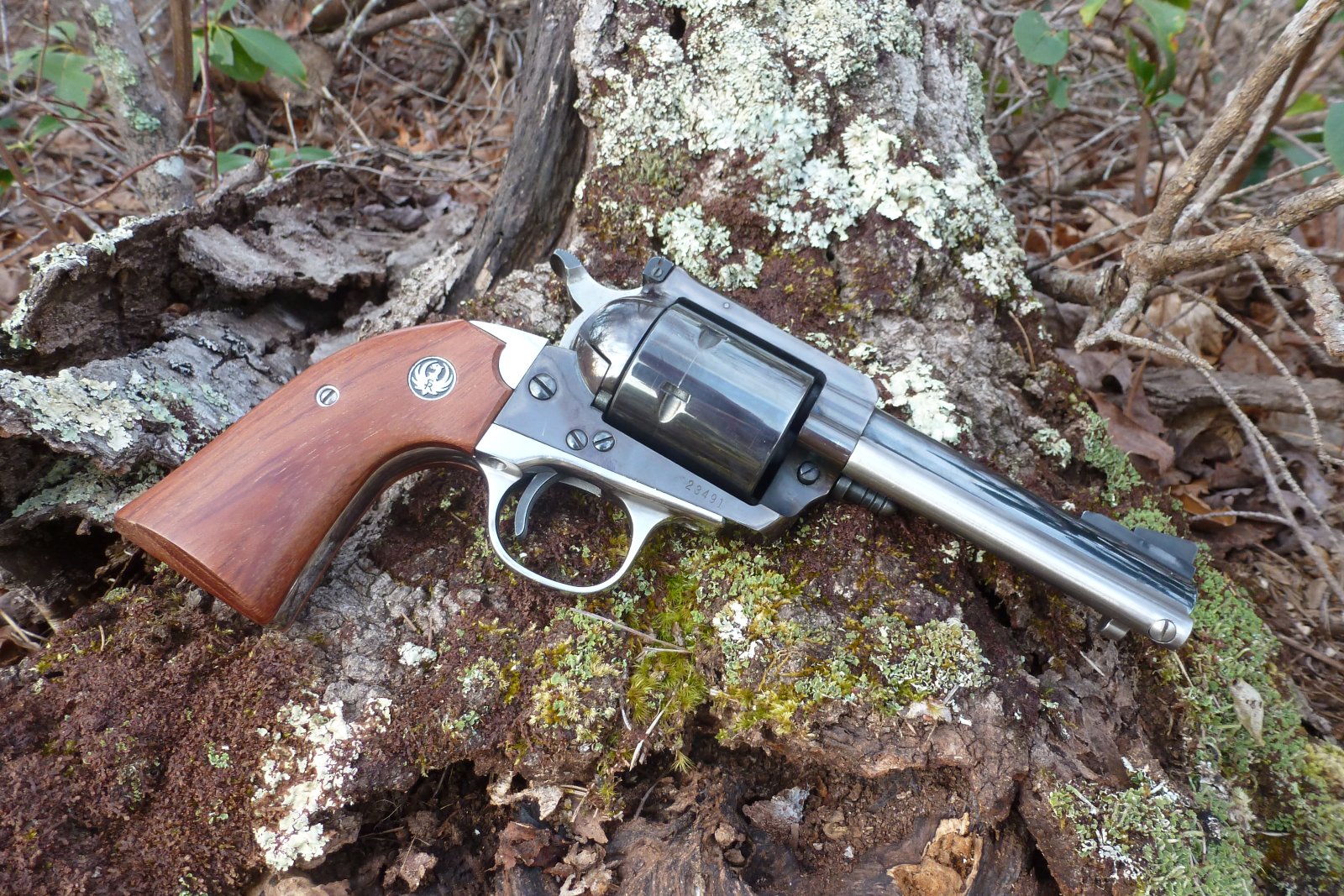

This is a OM 45 Blackhawk, used a Brass NM Gripframe with a NM Trigger Spring, with a Clements OM/NM Bisley Trigger and a OM Bisley Hammer.
More money in the parts than what was in the gun.

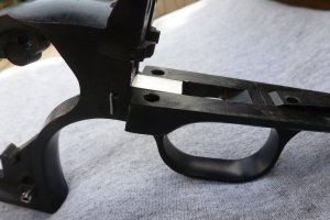

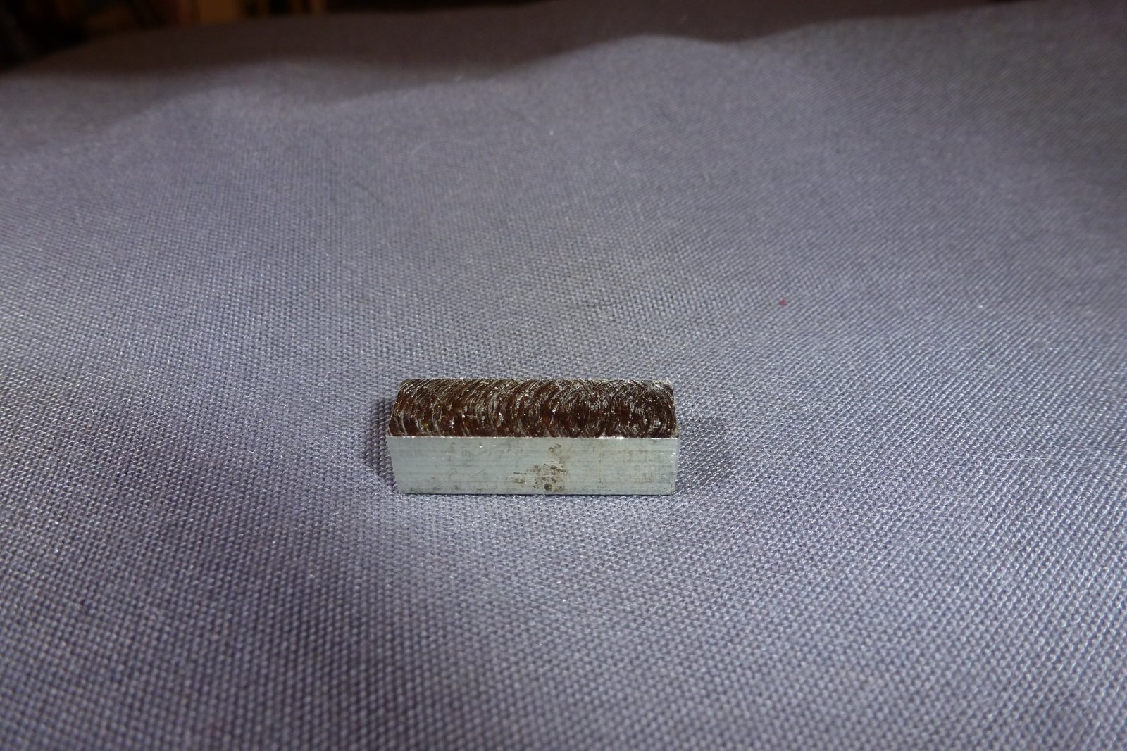

Ok, the pictures did upload.
Picture (1) is a blank piece.
Picture (2) it has been filed down for the hammer strut & spring to clear. And it's been cross drilled for the retention pin. (I drill the pin hole first, install it, and mark how much I need to file off for the hammer strut.)
Picture (3) shows the finished piece. Drilled from the end for the spring & plunger. And filed to clear the space in the frame etc. The spring hole got slightly exposed here, but it isn't a problem.

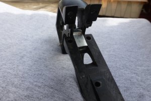

Now,, here's a couple of pictures showing you with one temporarily installed in a g/f.
(That one didn't have the spring hole cut open.)
