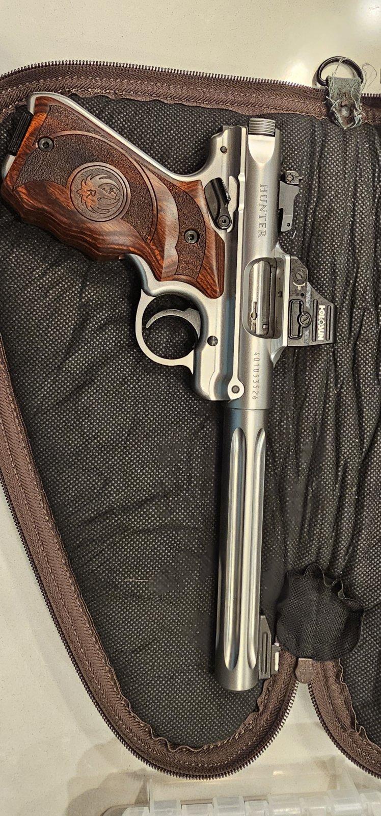

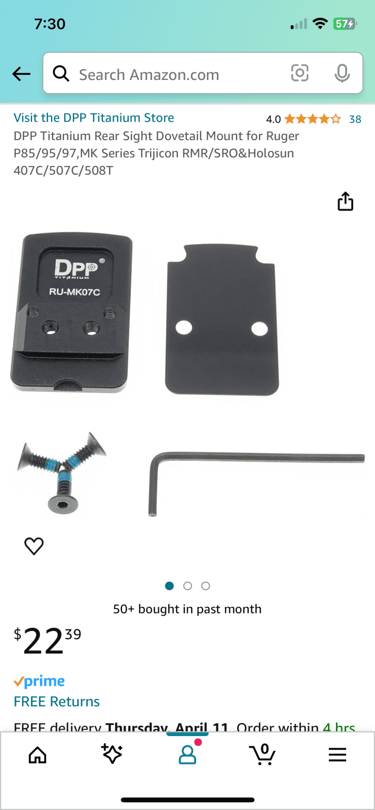

I know I'll get grief for this, but I have a mount from Amazon. I wanted something quick and I'm actually pleased with it. Close to the bore axis and clear of the ejection port. Fit was perfect and it's rock solid. Viridian green dot on one of the bargain Volquartsen blowout uppers. The upper came with the bolt and box. Planning on a supressor some day.

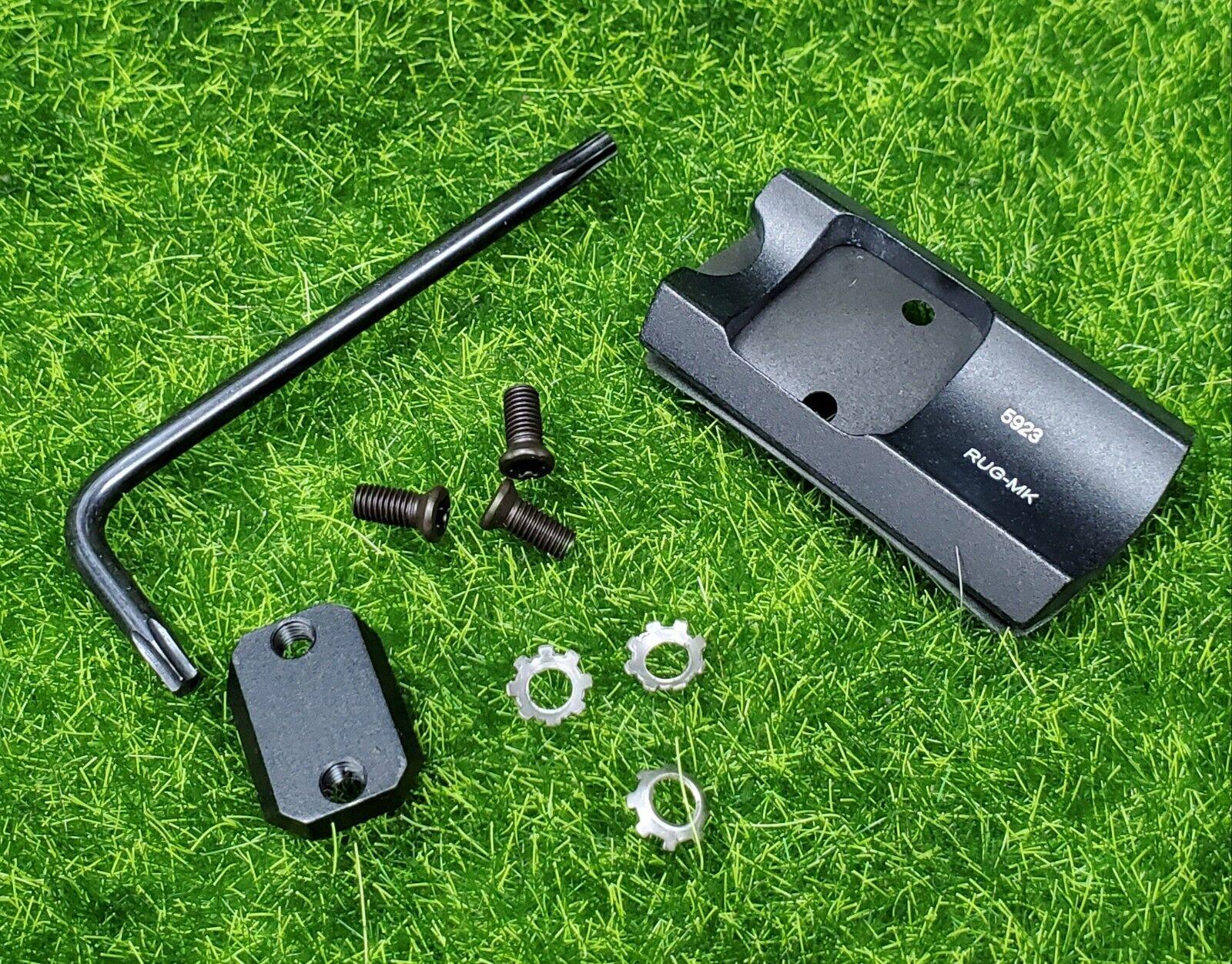

So my post is a few months late, but it might help others in the future who might be researching this subject. The Tandemkross plate is not flat underneath. It does have an inwardly curved recess that matches the shape of the MK's receiver.
One nice thing about this plate is that it has more than one mounting pattern. TK also ships very quickly too, so I like dealing with them.
