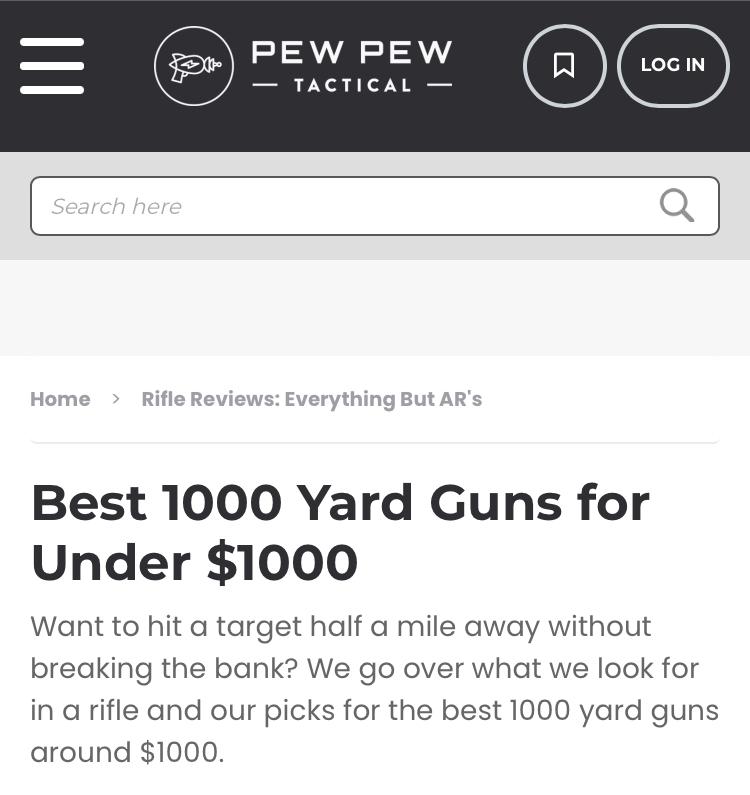

What's a "pewpew" note please..??
J.
it's where I accumulate my internet "research."
for example:
W296/H110
"These are not the powders to use for reduced-velocity loads. Moreover, handloaders are cautioned against using less powder than the starting charge shown in reloading manuals. With some of these powders, there is not a lot of distance between start charge and max charge.
For 240- and 300-grain jacketed bullets, the latest Hodgdon Annual Manual shows only 1.0-grain difference between starting and maximum charges of W296/H110. When Winchester made W296 available to handloaders back in the 1970s, load data published by the company had only one charge listed for each bullet weight, and it warned against any reduction in charge weight.
Velocity comparisons were my objective during this project, so I did not shoot for accuracy. I have burned enough of the slow burners through the years to already know that any good revolver will shoot good bullets inside 4 inches at 50 yards with either of them, and some will beat that by an inch or so."
I keep it all in my "smart phone."
