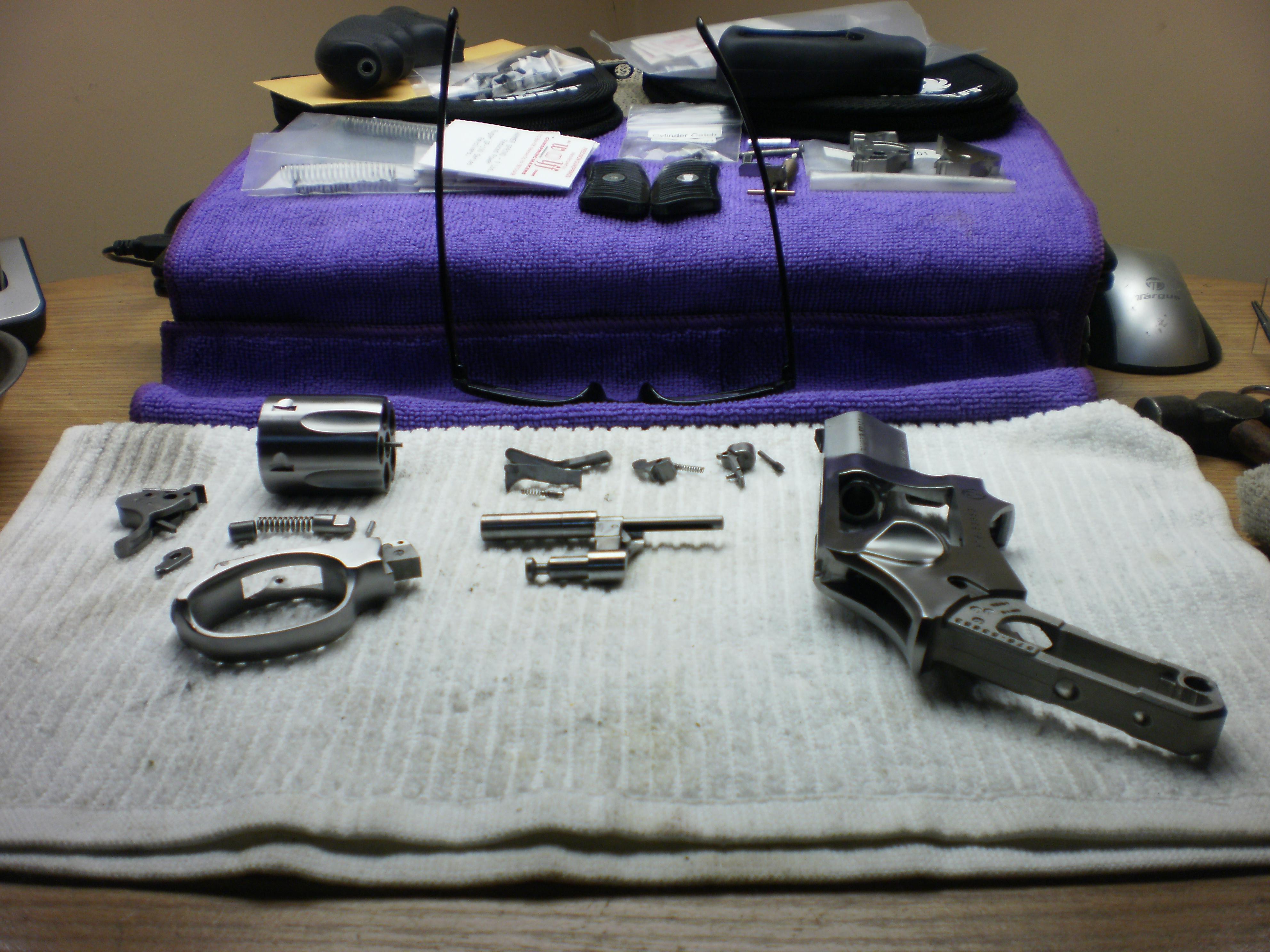

Got around to looking at the SP101 & opened her up for inspection, cleaning & spring change
The raceway for the trigger return plunger was the worst I ever came across, I didn't do as some suggest & use a drill bit but rolled a piece of 220 grit sandpaper up & turned it a few times & got it smooth enough for now so the parts will fit in or out
Installed the #10 hammer spring & the #8 trigger return spring & cleaned the chambers & barrel & left it for the evening till tomorrow
Need to measure & shim the parts & reassemble
Didn't plan on polishing the thing inside till later on
Here's is where I am on it currently

Seems like the first one I bought back in 1989 had some magic & so did the SPNY I got a bit later
This newer one is razor sharp on the rear face of the trigger itself & needs to be worked over to be what I want
Fit seems tighter than the older ones, in fact I can't see any play in the trigger at all = No room for even one shim
Installed the #10 hammer & #8 trigger springs & it made the revolver work a bit smoother + smoothed the raceway of the trigger return plunger some
Hogue grip gives my pinky a place to grab & also keeps the trigger guard away from my middle fingers knuckle
More to Come, really hard to get a photo of a stainless handgun with my camera

First off, I will have to just say something
I always thought that the MIM Parts made the newer made guns cheaper & easier to assemble & were IMO Rubbish
I WAS WRONG!
On this Ruger SP101 anyway it required .014" of shims to shim the hammer dog on the older DAO hammer
On the newer spurred MIM hammer it required .004" of shims
The trigger required .002" of shims total
End shake is .003" & Barrel to cylinder gap is .006"
The MIM parts are made to closer standards than the older ones were
For now, I just left the SA/DA hammer in the revolver & will change it later if I wish
I always have the option to do so easily
Lovin the New Ruger SP101

I don't care for the looks of the MIM skeletonized hammer & trigger...BUT...
The DAO hammer I purchased is the older machined style & didn't even try putting it in but did shim the hammer dog being I had extra shims
I also have a machined trigger group I bought but didn't try and use these parts
The frame HAD a sharp burr near the screw that holds the release button for the cylinder release, I took a micro file & deburred that tiny little sharp edge, it would have cut you easily... See Orange Arrow...
That made it more user friendly as this little Tank is going to be with me a lot & will be making my Glock 43X & S&W Shield 2.0 be left behind
I also took the trigger & mounted it in the padded vise & removed al the sharp edges at the rear of the trigger & smoothed & rounded the trigger face with crocus cloth & the shoe shine technique, polished it some with mothers polish to remove my sanding scratches, This also made it much more user friendly along with shimming the parts & adding the Wolff Springs
Won't get around to shooting it for a week or two but found some 38spl Speer Gold Dots 135gr & some Winchester Silver Tip 145gr 357mag in my ammo stash + a couple HKS 36 speed loaders & Bianchi speed strips & have a GR8 Don Hume JIT holster
Don't know the specs for end shake but would assume that the .003" is just fine or I would have shimmed it if it was excessive... I used No-No Go feeler gauges to check it, The cylinder gap is .006"
Really Happy with this SP101
