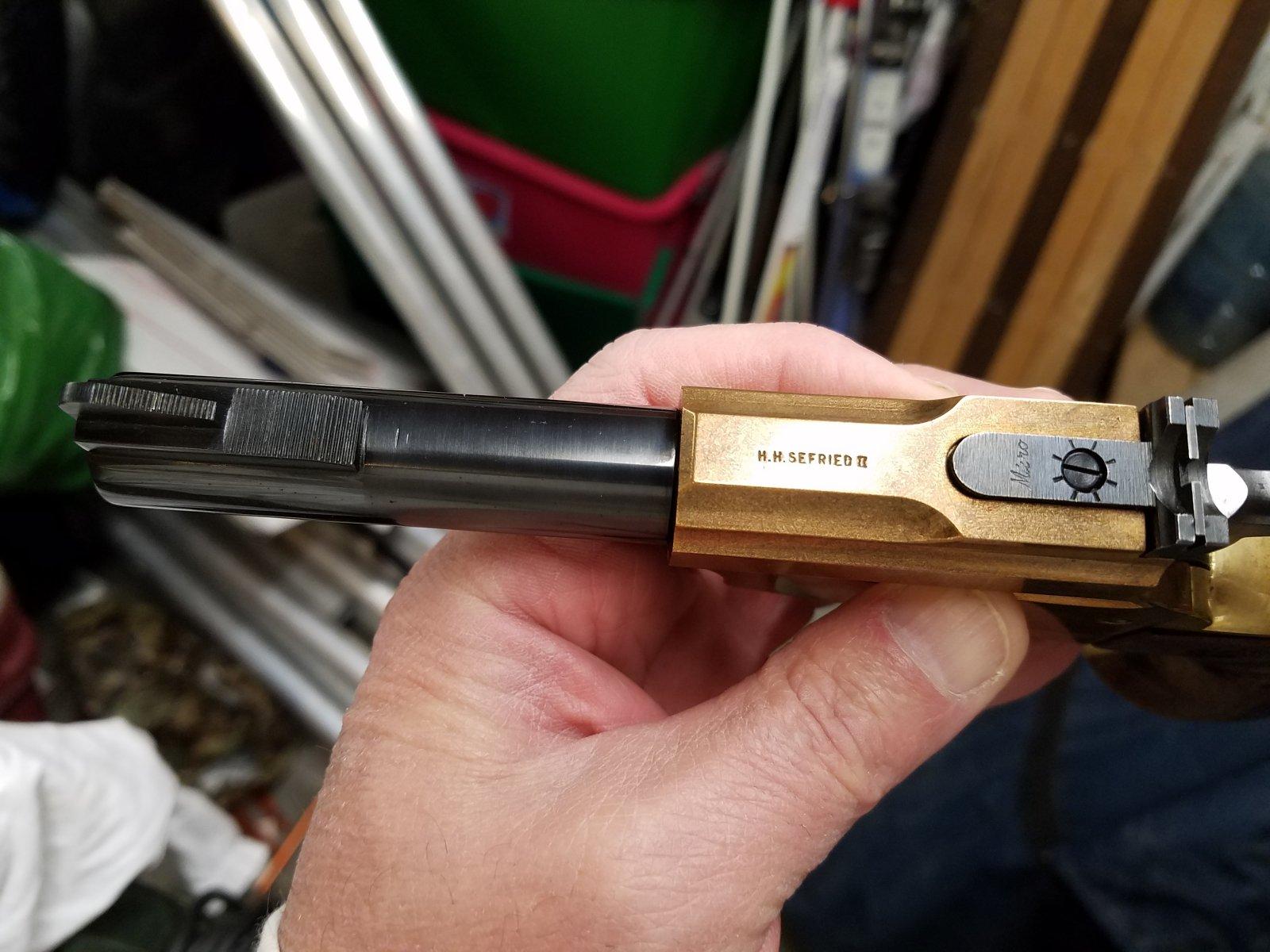

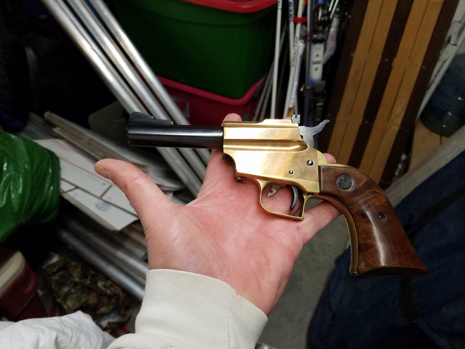

Bill Ruger was indeed a great American gun guy! but he had many great folks all around him. no doubt. but none more influential then Harry H. Sefried. master engineer and gun designer. bought into ruger in the late 50s some time. started work on break top single shots. prototype 22LR and hornet. never made into production. his Lockwork on the 1958 Super that came out in 1959 was perfection. Bill and Harry jointly developed the 1022, Deerstalker, Redhawk, ect...Harry's 1022 mag design still a master piece in its own right. designing of the Hawkeye pistol. (my personal favorite) and one of the coolest guns to own and shoot. im my option. Bill Rugers brilliance was surrounding himself with the best there was at the time. Harry H. Sefried was that guy. here's one of only two known H.H. Seyfried guns. Bill Ruger has one. and so do I. great read added below FNC.
