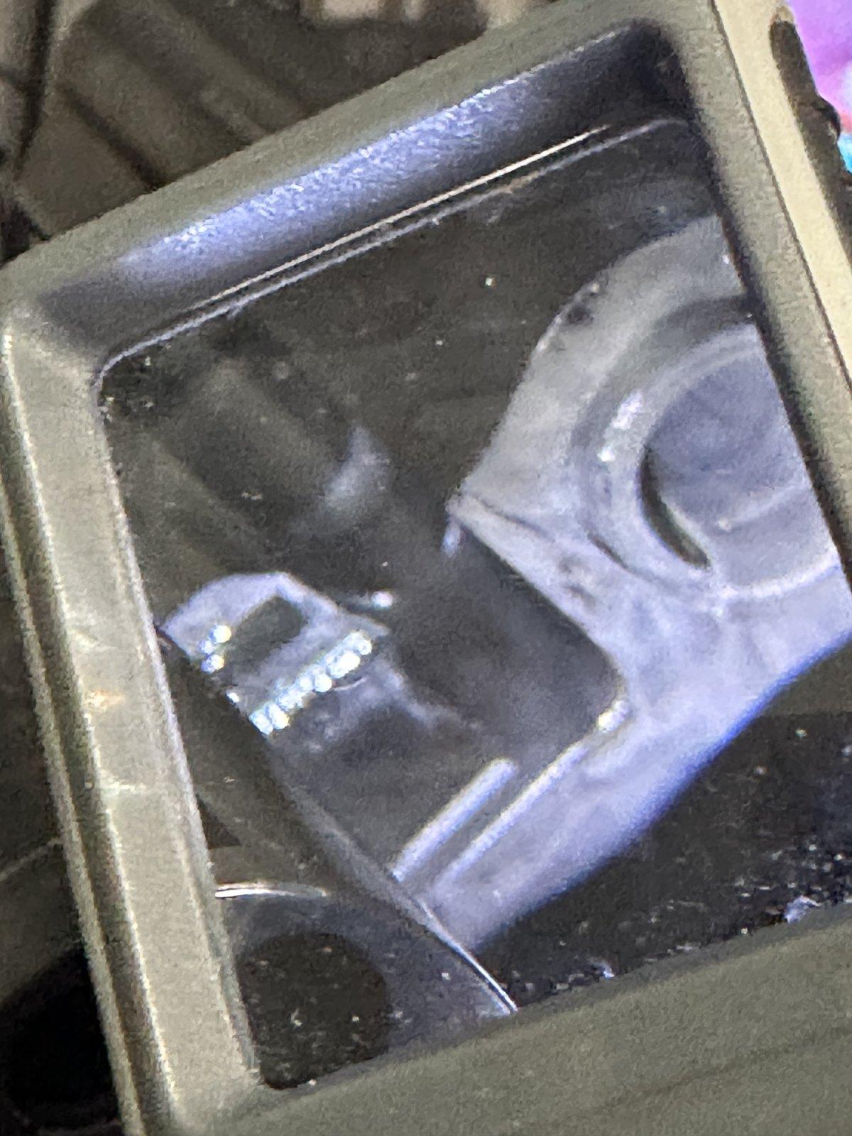

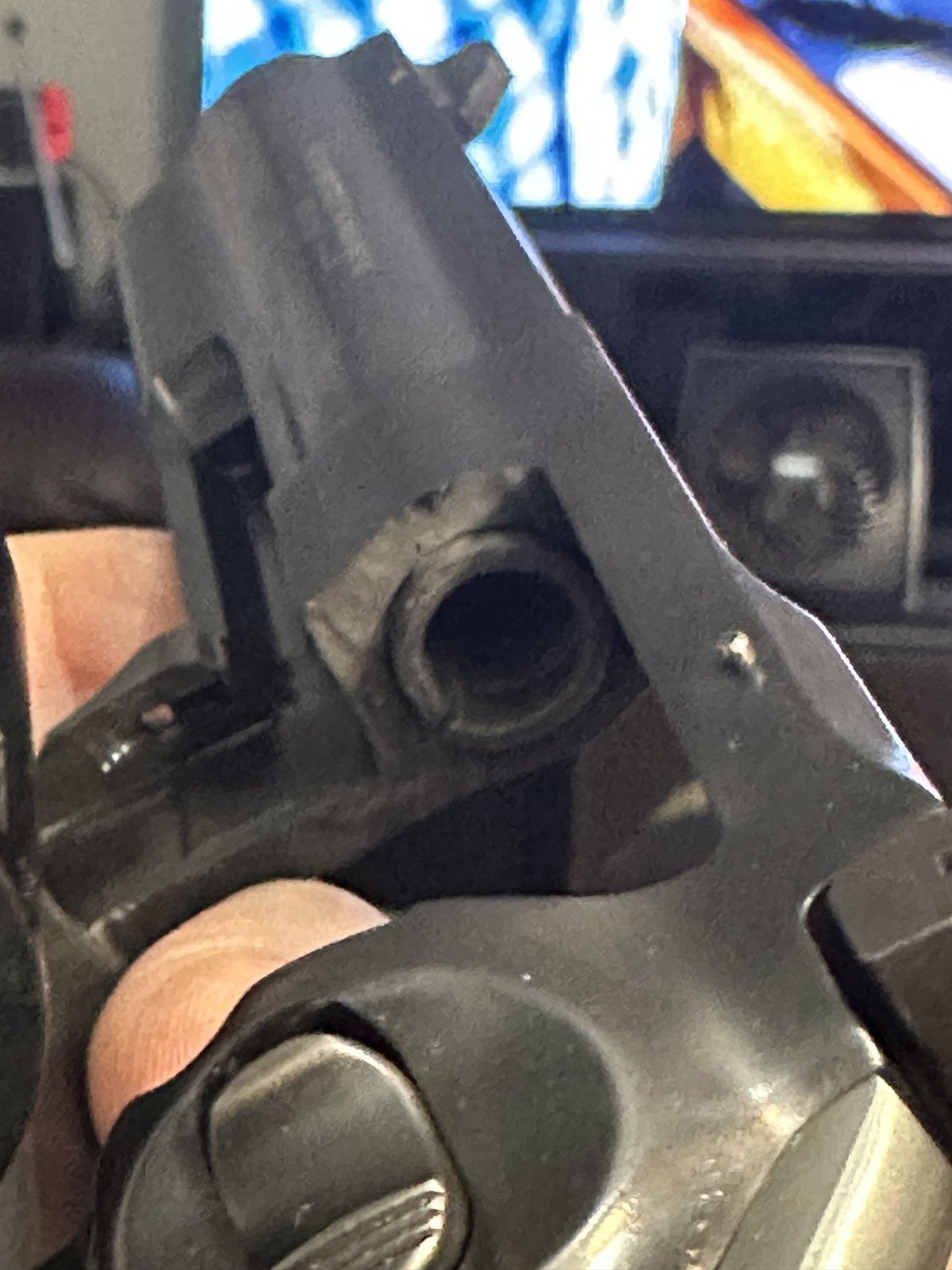

Curious if anybody has had a similar thing happened to them. Is this a warranty issue? I've had the gun for 1 or 2 years and probably have .357 1200 rounds through it. I'm hoping somebody will say "Ruger is awesome, Just send it in and they will fix it!"
From what I'm reading, it would need a new barrel, not just the "force cone"

Factory ammo, or handloads? It sure looks like there's a ton of lead buildup in there, which chokes down the bore and raises pressure. Ruger will probably fix it for you despite the apparent neglect/abuse the gun was subjected to.

First off Duckfart,, "Welcome to the Forum!"
As noted,, YES,,, a polite call to Ruger will most likely get you a pre-paid shipping label to return the gun. And yes,, they will also most likely fix the gun free of charge. Ruger doesn't have a written warranty,, BECAUSE Bill Ruger discovered long ago it was CHEAPER to just fix the few problems than have a written warranty that "forces" the subject.
The pictures aren't clear enough to show how much "stuff" may be built up in & around the forcing cone. But arfmel has a point,, they are machines & do require maintenance. But many hundreds of thousands of Rugers have been subjected to a lot of use & abuse & not had a forcing cone crack. The forcing cone is part of the barrel and a whole new barrel will be required. Forcing cones are not a separate part.
Contact Ruger,, and be polite. I'm SURE they will be quite nice & helpful. If not,, it would be a big surprise! They are "awesome!" :D

Thanks arfmal, idk if it's the cheap factory ammo or I did a poor job of cleaning. I'm new in the gun world and listen to a lot of different advice. I've always cleaned it after every range day. ( I enjoy the process ) I've also heard that cleaning after each use has its disadvantages or is overkill. What you are seeing in the pic, is after roughly 250 rounds w/o cleaning. It was a hot day and considered the crack was heat related??

First, it probably was not outside temperature related, just shooting gets a gun a lot hotter than being outside. Second, I don't believe you can hurt a revolver by "over cleaning" it. That said, there may be firearms that may be affected by over clearing, but not the GP100. I clean my guns every time I take them out no matter how many rounds I put through them and have had no indications that they show any extra wear. In fact, when I was shooting PPC, I would clean my revolver between every stage (as most all the competitors did also) and nothing bad every happened. Third, 250 rounds without cleaning is going to be hard on any gun, especially with cheap ammo. The build up of crud could/will affect pressures and that isn't a real good thing to happen. If you see a lot of crud/lead build up and can't get it all out with your normal cleaning tools and solvent, a Lewis Lead Removal tool is you friend. It will pull out stuff from a barrel/cylinders that looks like they are clean.
Even with what your barrel looks like in the picture, a call to Ruger, as stated above, will probably result in them fixing your revolver at no charge.
Oh, by the way, from the picture, it looks like the rear sight retaining pin is sticking out too far, if it falls out under recoil you could lose your rear sight. If it moves easily, take it out and put a very small bend in the middle of it, that will make it a lot more secure and won't come out under recoil.

Op, I'm sure you're freaking out a bit and want answers as I would in that situation, I get it. That said, cleaning the GP first, good lighting, and a clean magnifying glass first would certainly go a good way for the resident experts here to likely help diagnose your issue. As said, Ruger will make it right.

A few years back I bought a used 6" GP with a crack in the same spot. Paid $199.99. GS had me sign off on firing the thing - sure, no problem .... :rolleyes:
Contacted Ruger, they paid for everything including shipping and installed a new barrel. Quick turnaround too.
