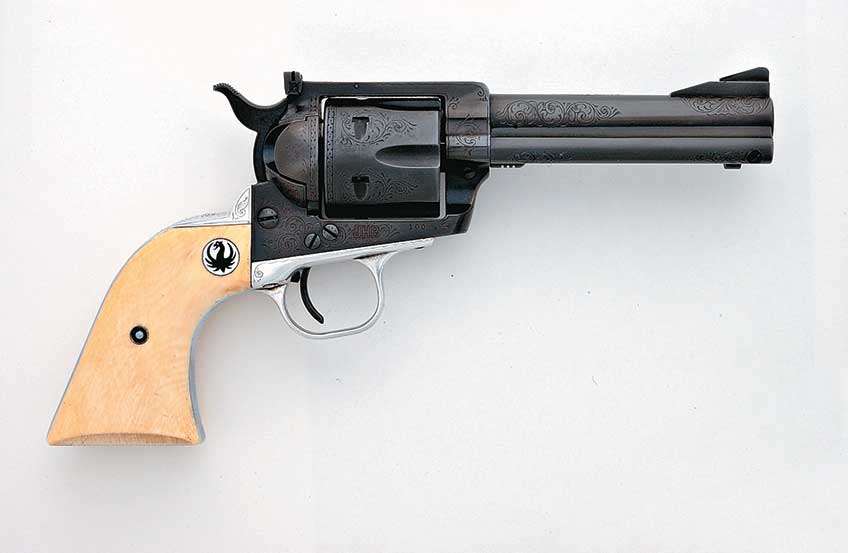

If there was one in my gun safe I wouldn't have asked for pictures. But, never mind , here are some pictures of Ruger engraved revolvers from the web.
