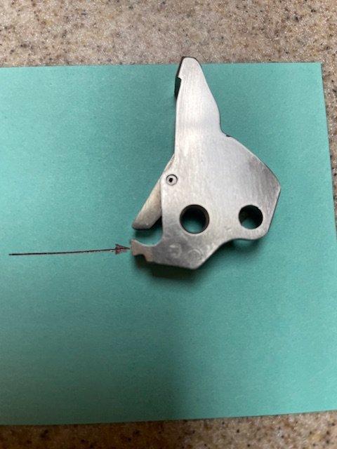

Now the spurless hammer model that Ruger currently makes ( Model Number: 5720 ) shows that it is a DAO but I have not had a chance to operate one to see if it was made without the SA notch or if it was just made with no real capability to grab the top of the hammer to pull it to the rear where it will catch the SA notch.
That said, Ruger did make a SP101 (I have one) with a spurless hammer and without the SA notch (true DAO) for a contract for the NYCPD. It is marked on the left side with "SPNY"

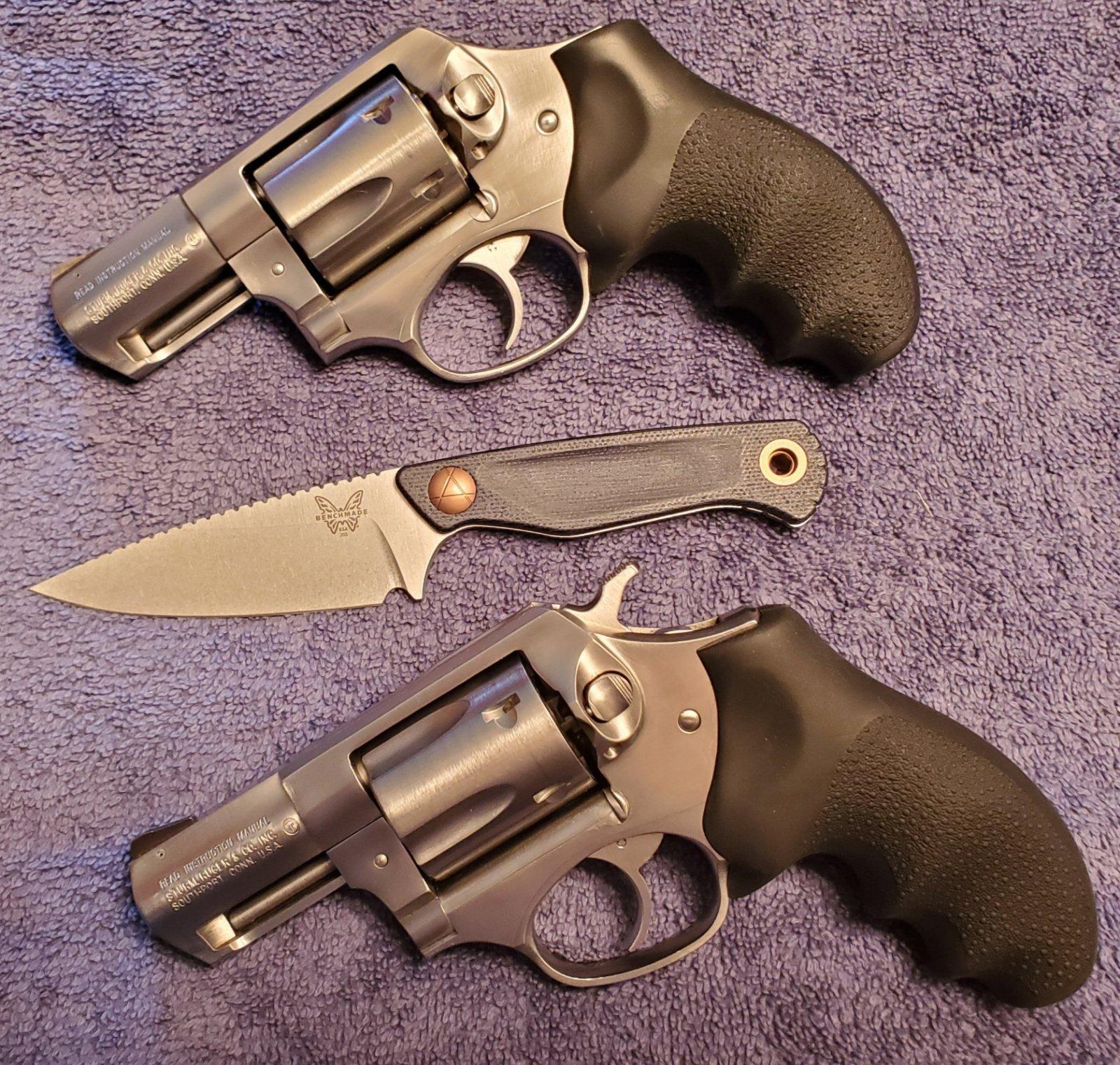

Yes there is a DAO only SP101. It's shown on the Ruger web site and I have one. It's chambered in .357 Magnum and while it does have a hammer, the hammer spur is 'bobbed' to match the lines of the frame.
When the trigger is pulled the hammer comes back and is exposed. There is NO single action capability. You can NOT pull the hammer back and have it catch and stay back for a single action hammer pull to release it. As you pull the trigger the hammer comes back to a certain point and then is released to fire the cartridge.
So if you were carrying it in your pocket, the hammer could get caught on something as you pulled the trigger or something could come between the hammer and frame blocking the hammer travel. So pocket carry is OK but pocket firing may malfunction.
Ruger did make another DAO SP101 called the SP101DOS model, but it's not commonly found. The hammer is different from the regular hammer in that it is rounded like the 1911 Commander version making it easy to identify.

I have a spurred hammer SP101 that I would like to convert to spurless but apparently the spurless hammers are not available from Ruger or any other source. I am reluctant to modify my existing hammer in case I have a change of heart down the line. Anybody have a source for SP101 hammers?
If you want the stubby, bobbed hammer, those are available on eBay. When I was looking, they were plentiful. The spur hammer was the one that was not easily found.

Yes, so the 101 I had looked like the one in post 12, but without the checkering. And you could pull it back and it'd lock for a single action shot.
I would venture to guess that the previous owner made it into a spurless hammer. If it came from the factory it would have had a hammer like in post 12. My spurless, SAO SP101 has the checkering on the top of the hammer.
I forgot about that one. I had to search for a picture. Best one I could find.
