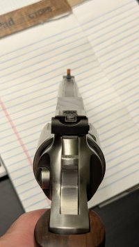

Hmmm. OK....so your saying you received it unfinished and polished and did it yourself to Rugers's engineered tolerance? The pics you posted are a bit misleading (to my eyes anyway). The "before" pic appears straight on....the "after" pic appears pointed to the right, possibly projecting an illusion the barrel is straighter than before. Even though I would not take meat away from the top strap, and I'm pretty sure Ruger would frown a bit also, understand it's just an observation.

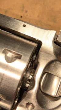

Not unfinished but having 3 of these I've measured the top strap from left to right and mine is still well within the range I had seen. My top strap is so unevenly finished that the front where I filed down is still wider than another spot further back!
Not trying to mislead with the photo. Was just trying to take a photo best I could. I can try again. Here's an after pic with the frame straight on more. As you can see, barrel is off but I don't think it looks as visually bad.
I accidentally trashed my before after measurements but I only ground off maybe 0.03" off the top strap if that.

I wouldn't be worried at this point what Ruger thought about it seeing as they couldn't get the gun right after the third try. I'd be demanding a refund at this point but it's your money 💰.
Going to test the revolver with a range rod and if it passes I'll keep her. If it fails I'll go the refund route and see if I can get Cabela's to order me a 5" GP100 as they're hard to find..

Another comment,, was about how it appears how the hole in the frame may have been off center slightly. Causing the barrel to be off slightly.

Just my opinion but I would not have accepted it or any other new gun with flaws like that. I don't care how it shoots. When I'm paying that much for something it needs to be without flaws. If that hole in the frame is off center it will never be right.
Normally I'd agree but it appears like Ruger can't make a revolver any better than what I have right now. They're claiming it's ok, and it's the best of the 3. I don't know what else to do
If people keep accepting this it will never get better.
I'd love to be the sacrificial lamb here but I'm tired and out of time and money to deal with this. At least with 3 different GP100s, Id think Ruger lost money here - no way they made a profit throwing out 2 revolvers and sending a firearm through insured mail 4 times over!!

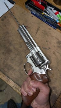

Range Rod delivered and test complete. Drumroll...
She passed. Zero drag down any chamber, and the rod reached all the way back to the firing pin. Funny enough, when sticking the range rod down the barrel only, and letting the rod stick out like a pointer finger, it's clear as day the barrel is crooked - aim the frame straight ahead and it's pointing way to the left!
Nonetheless, I'm done screwing around here. If she passes a Service Range Rod test then I'd say she's safe enough to shoot and I've seen that she is accurate enough for me. Thanks guys for all the help...
