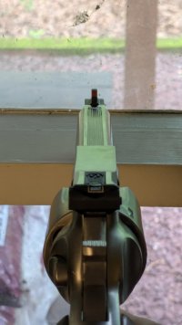

I don't see the issue you're referring to.
The barrel doesn't look bent as both sides meet the mainframe equally.
The barrel isn't overtightened, the areas I circled in red show the height on both sides of the rib equidistant on each side in relation to the top strap. If I were over/under tightened, the angle would be noticeable.
The rear sight, if regulated by you to be correct, seems centered. I don't see an issue. I mean, the front sight itself MIGHT be bent, but doesn't appear to be.
The post above with the lines drawn...the lines aren't straight. So that makes things appear worse.

Thanks for looking into it. The barrel is not clocked incorrectly as you pointed out - so it's not like it was under torqued or over torqued
Take a look again. It appears the hole threaded into the frame for the barrel to screw into was not done squarely. When installing these barrels they are screwed in and "crushed" for the final torque, so that's why there isn't a gap on either end. Nonetheless if you follow the barrel from muzzle to frame you can see it's not going straight into the frame.

Quick Update: After looking at this GP100 until my eyes went numb, it now looks like the barrel may not actually be canted, but that the front of the body of the revolver is slightly imperfect. When I ignore the front of the body where the barrel attaches, and instead focus on the rear sight, the hammer, the rear backstrap above the grip, etc and try to make those straight, the barrel appears to be perfectly straight with them. That would explain my gap measurements too I think...

For future reference for anyone dealing with a similar issue, here are a few photos showing the crooked barrel on the third GP100. All had the same problem. It is not a trick of the eye as I was able to measure a 0.03" difference in space from side of the other when measuring square against the barrel.

Its harder for me to tell but it appears as though the cylinder is square with the frame, meaning the cylinder and barrel are out of square slightly.

Sorry guys, things are more active on the other forum so havent updated here. I came to realize that, despite the barrel truly being crooked by 1 degree, that the hand finished frame was giving the illusion of the barrel being even more crooked...
So, I got out of work early today and decided I'd try my hand at grinding down the right side of the frame to aid in removing the excess illusion of barrel cant.
It was honestly much easier than I thought!! Used a metal bastard file to shape it until I was satisfied, then sanded for a bit with 400 grit, then 600 grit, and I stopped at 600 - without me even trying, the finish nearly matches the Ruger factory brushed finish! I just ensured to finish up sanding in the same grain direction they did at the factory.
I could have kept going, and could even do a bit of the left side, but thinking back to what @Scswolf said about Mouse and Mole and decided to quit while I was ahead.
Is the barrel still crooked to 1 degree? Yes, absolutely, and the Range Rod test tomorrow will tell if it's a mechanical problem or not. But visually, WOW, I can't believe how much better it looks!
I know I'm tricking my eye with the reshaped frame, but I think the way the frame was originally hand finished was creating an illusion of even more than 1 degree of cant.
Now, holding it in my hand, I can barely tell it is crooked. So much so, that I think if I had received it this way from the factory and never did some precise measurements, I would have thought it was a straight and true barrel.
Hard to capture in photos but here is a before and after, same location and as close to same angle as I could manage. Pictures arent doing it justice but even from these photos I think it looks more straight, which helps me enjoy it a bit more!!
