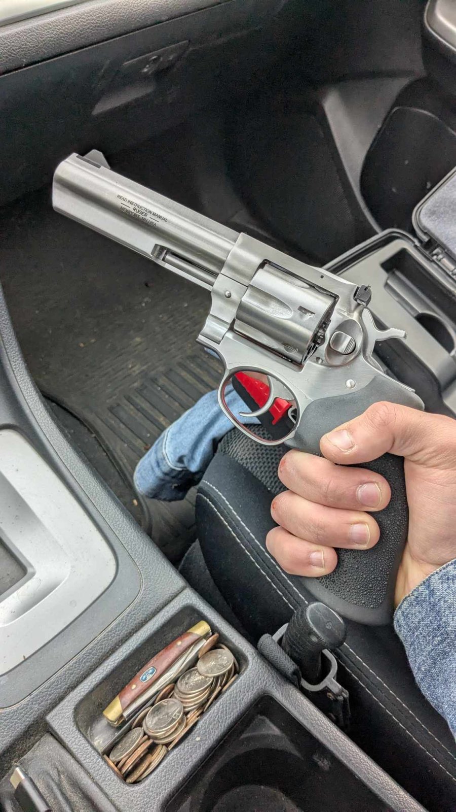

Hey guys. Bought a brand new Ruger GP100 6" in stainless steel. It is absolutely gorgeous!
After reading many QC issues with the Ruger GP100s, I decided as soon as I got it home I'd give it a good once over. Well, a few problems...

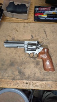

1. Biggest issue I see is that the barrel is not straight. I read some posts online about barrels being canted because they are under/overtorqued, but that is not what is happening here. The barrel is angled toward the left. I was able to confirm this by taking a straight edge against the frame of the revolver on either end, and measuring the gap between the barrel and the ruler. Left side is about 0.080", and right side is 0.160". Doing a bit of math, this tells me that the barrel is 1.09 degrees to the left.
I know these GP100s are known for this. Does anyone know if ~1 degree is considered within spec for these? I don't want to send in the revolver to Ruger just for them to tell me it's within spec and send it back with nothing done... It's definitely not straight, but it's subtle enough that a photo doesn't show it, and that I am not totally noticing it when shooting, just when looking from the top down...

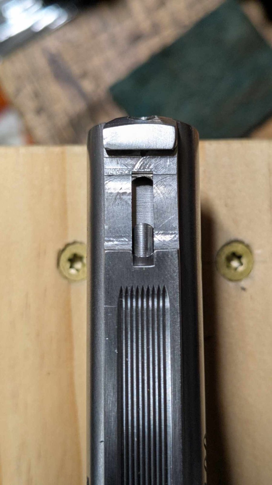

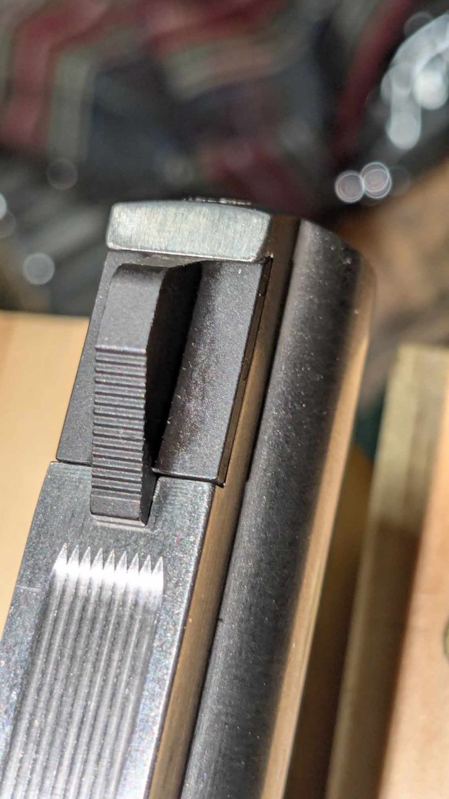

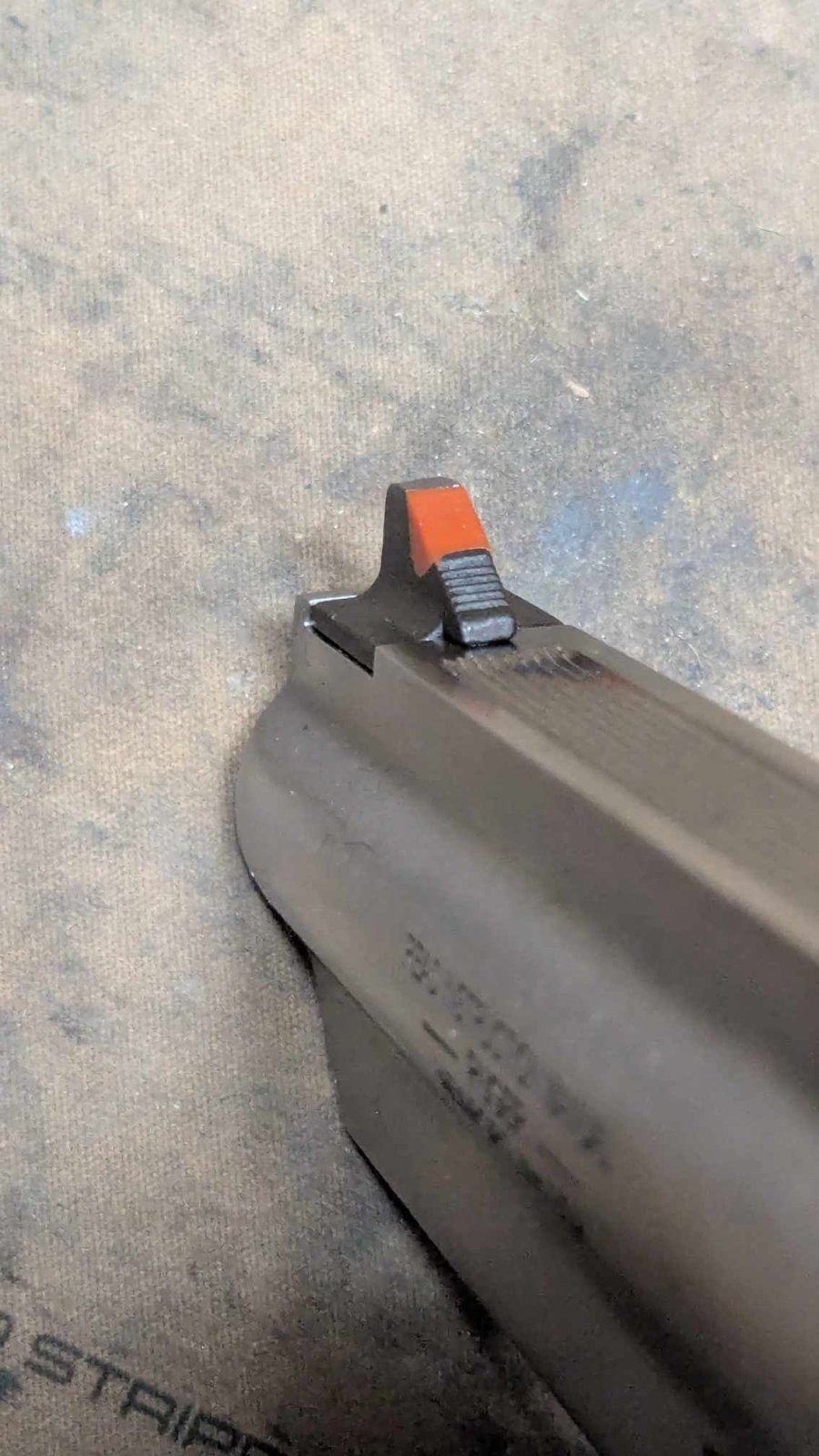

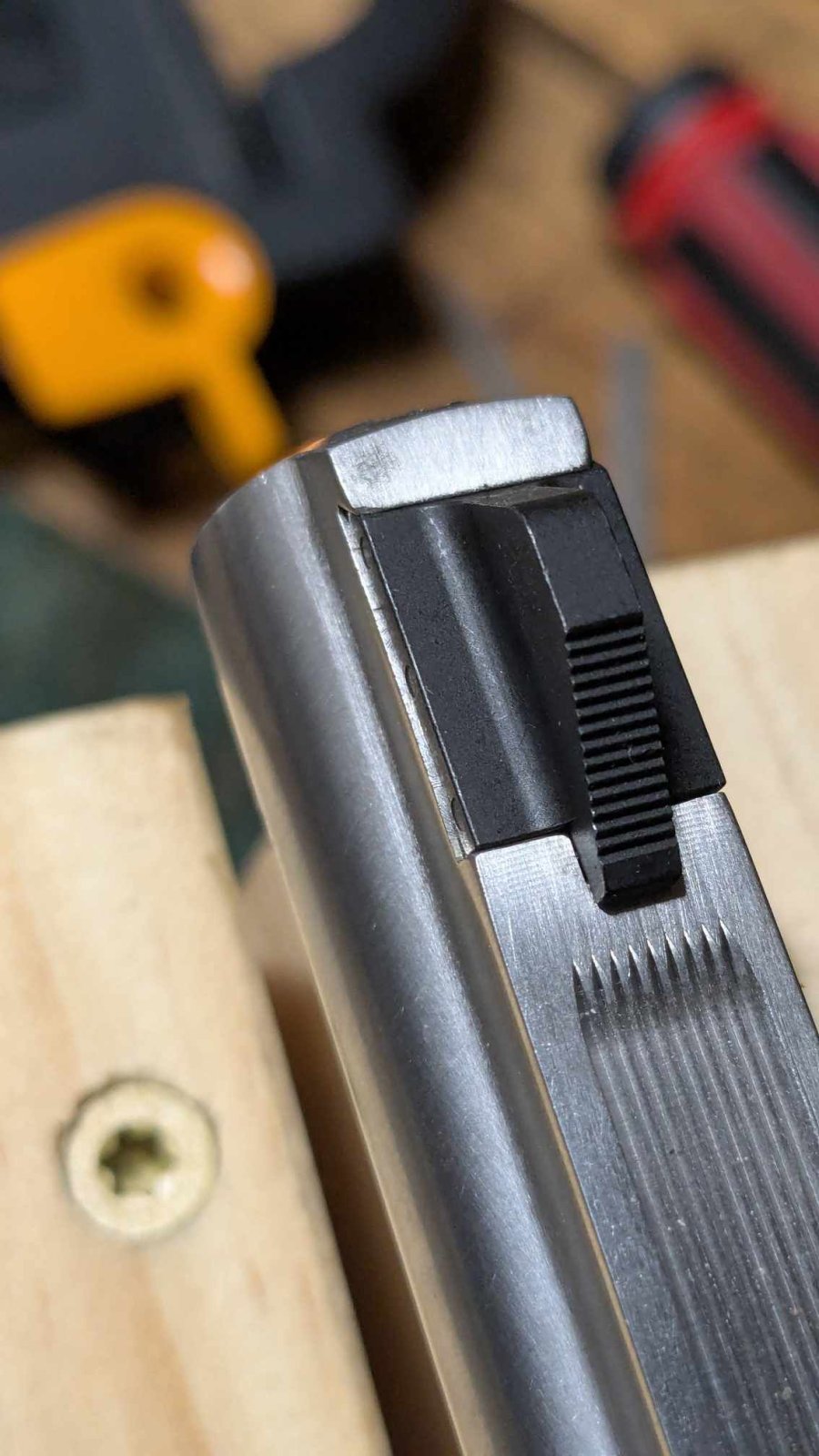

2. The front sight post is not centered. I pulled my front sight, and could tell with the naked eye that the cut out for the front sight to sit in is not cut centered in the barrel. Again, not a huge deal, but it's obvious that the sight is sticking out a bit on one side.

Of course, my laser bore sighter is out of batteries, so tomorrow I will get a new one and check on zeroing it. If the sights need adjusted so much so that they're obviously way off to one side or the other, I'll send it in. But if the sights just need a minor tweak, what would you guys do? Would you send it in? Or just live with it?

Quick Update: After looking at this GP100 until my eyes went numb, it now looks like the barrel may not actually be canted, but that the front of the body of the revolver is slightly imperfect. When I ignore the front of the body where the barrel attaches, and instead focus on the rear sight, the hammer, the rear backstrap above the grip, etc and try to make those straight, the barrel appears to be perfectly straight with them. That would explain my gap measurements too I think...
Anyway, I will confirm tomorrow with a laser bore sighter. I just realized I have a 9mm sighter which I thought would work, but it actually does not fully fit into a 357 magnum... grr. Going to try and stick it in halfway and see if I can get some sort of picture.
Going off of that, would you guys send it in to Ruger purely for the uncentered front sight post?
Think I'll bite the bullet and send to back to Ruger with a detailed explanation of all of my concerns. I sent a detailed email and will see what they say.
Used a boresighter this morning and it is off. I didn't have to adjust the rear sight to the max one way or another, but it is obviously not centered on the firearm and it bothers me.

Before I'd send it off,, I'd see how it shoots first.
A bore sighter isn't dead perfect either. And if you need a little adjustment to the sights,, well, that's what they are there for. Without shooting it,, you do not know if it's very accurate or a side of the barn shooter. I've seen some guns that appeared to be way off,, yet shot VERY accurately.
To me,, accuracy is king if I plan on shooting it. If it's to be a collectors piece,, and only displayed,, then cosmetic issues would make me send it back.
The slight offset of the front sight cut may or may not affect the accuracy. But if they decide to fix it,, they will have to replace the barrel,, and if the gun was already very accurate,, and the new barrel gets installed,, you may discover poorer accuracy.
JMO,,, and that's worth enough to get you ignored by waitresses. :D

If you haven't shot it yet, contact your dealer and see if they will do an exchange. Most won't, but some will, specially if it's a sporting goods department store. I'm gonna say this, Ruger makes it very hard to judge a barrel not being canted, because of the way they finish machine their frames, sometimes they will grind away more metal on one side or the other. I've had Rugers that I pick up one time and it looks canted, pick it up a second time and it don't. All I can advise is that if you do return it to Ruger for correction, do it yourself and don't take it to your dealer for them to do it.
