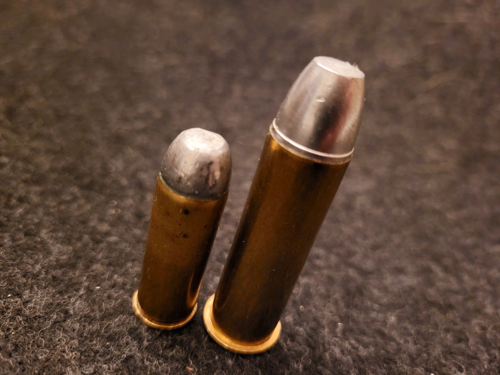

This is my 45 Colt load with 36g of ffg next to my 500gr 50/70 load with I couldn't tell you how much black powder. It's like a cannon going off with my McNelly Sharps.
