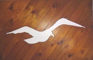

I've never heard of using electricity to burn a pattern in wood grain except with a soldering iron to burn in (see pic below) a design.
Back in the day, I made a couple of things with a technique by scorching the wood with a torch then taking away the softer bits between the growth rings with steel wool. Softer wood like pine works best and the amount of steel wool and or sanding left some pretty nice looking wood to finish.
Wood burning a design is pretty slow going but comes out pretty good.

That is beautiful :cool:
