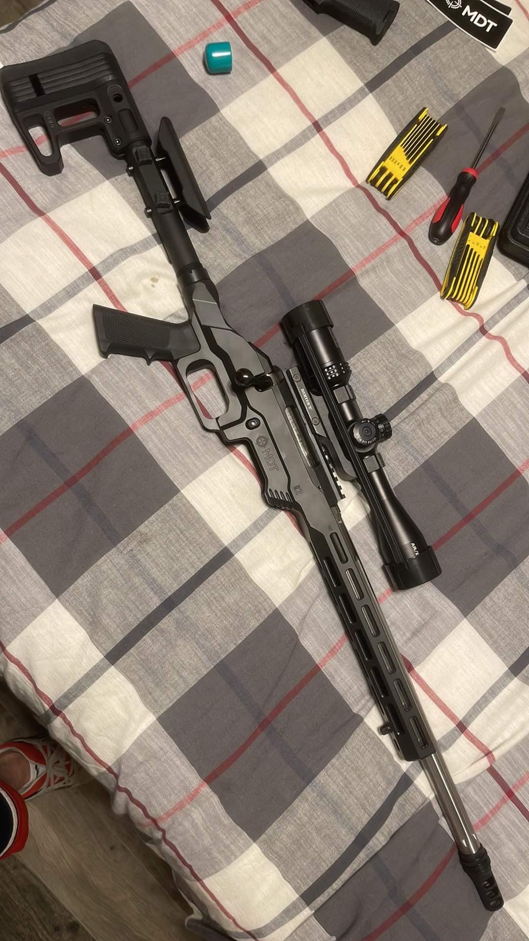

I will! The chassis and stock was just delivered. Bought a bunch of stuff during MDTs big sale (luckily)
Barrel is ordered and I'm still waiting for the gun to be delivered to my local FFL too. So as soon as I have everything in hand, I will PM you

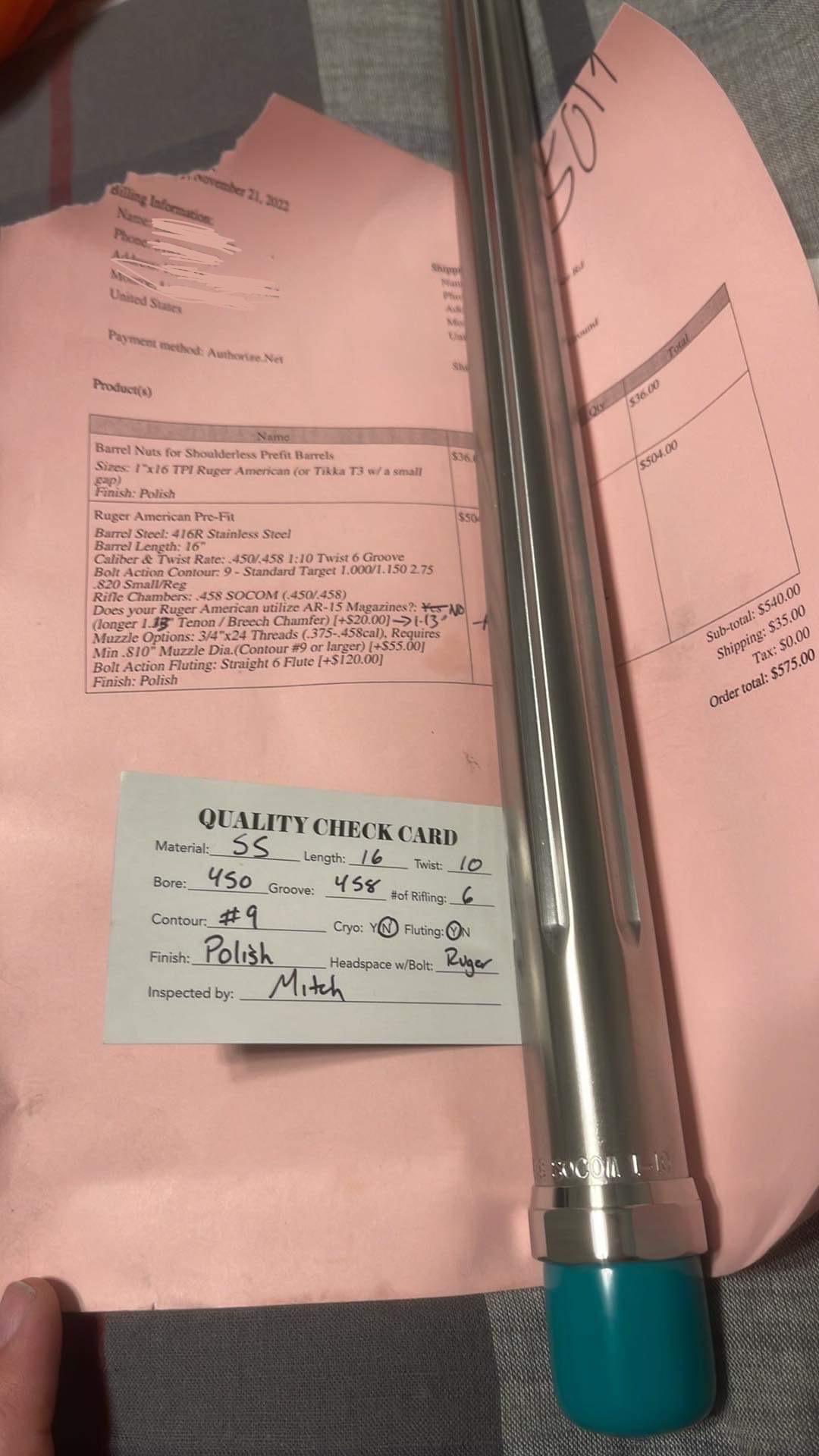

What barrel vise and action wrench would you recommend?
The size difference in the Hybrid46 and Bowers are what will allow the Bowers to be quieter. How much? by ear you may not even be able to tell the difference. I went with the Hybrid46 myself because of the Bravo QD mount. Plus, it being a little smaller and lighter
I haven't gotten that far yet. Probably going to bust the old nut off with a pipe wrench. It won't be reusable but I don't care. Haha
Yeah the barrel I ordered, I ordered a new nut for it. I planned on using a pipe wrench to remove the factory nut. I know it all be toast afterwards
Just curious if people are using barrel vices and specific wrenches?
