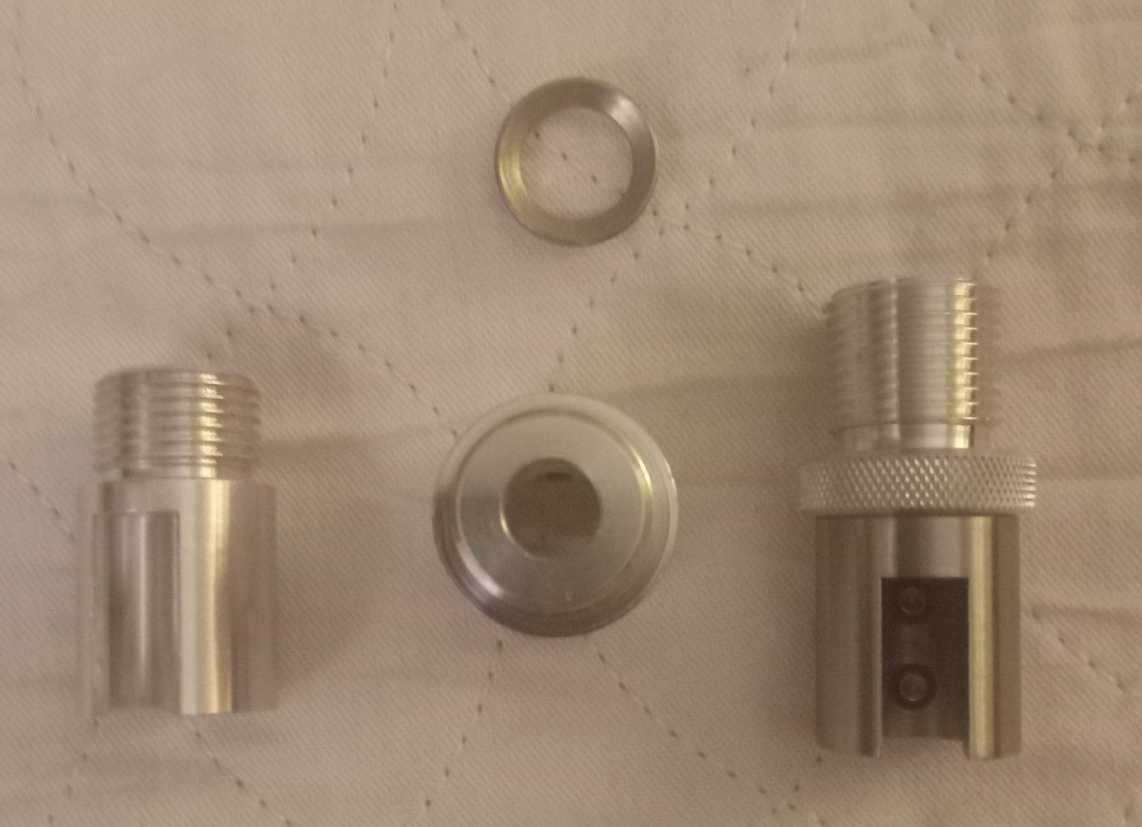

Something like these work pretty well. The thread is 1/2"-28 and they can adapt to standard oil filter threads of 3/4"-16 or 13/16"-16. I am sure you could also find an adapter to change it to metric oil filter sizes as well. These are solvent trap adapters for cleaning purposes. The ring is a sealing ring to keep it from leaking.
