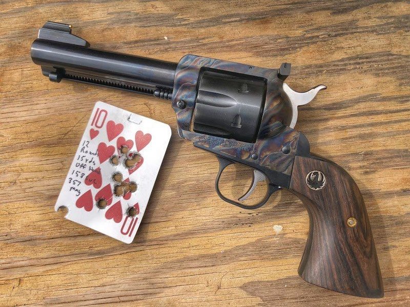

Here's the last one Bobby Tyler did for us.....
That looks really nice.
